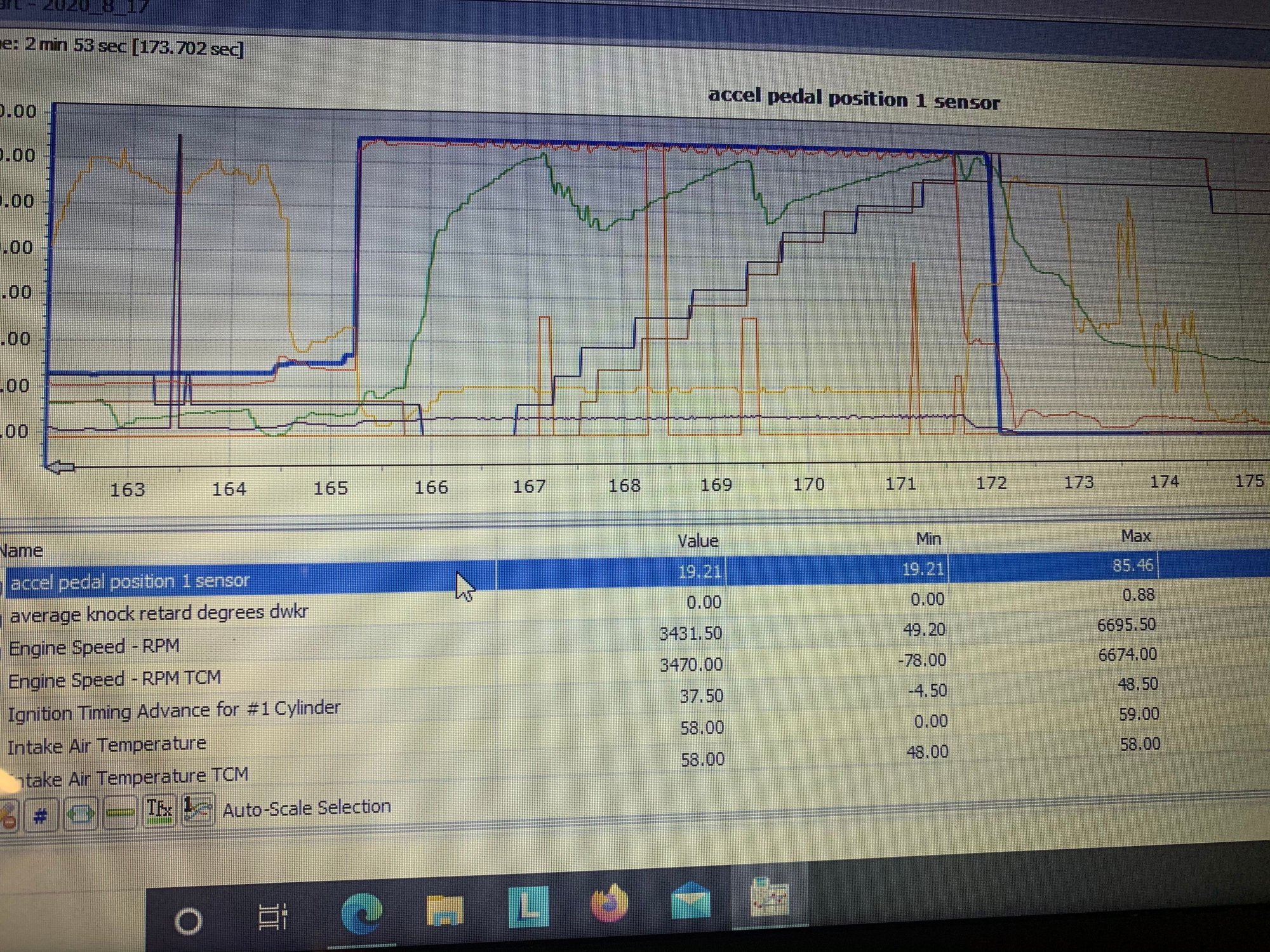

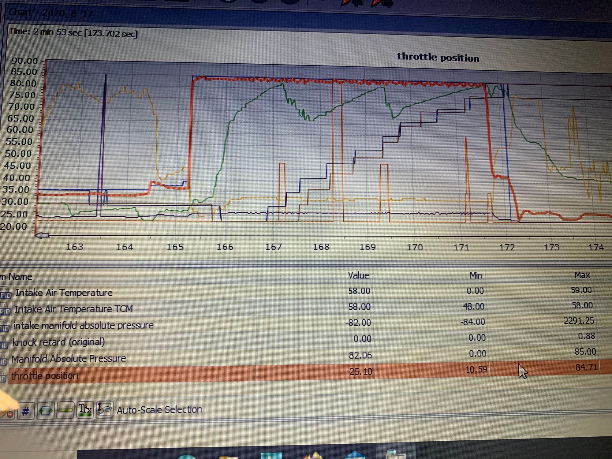

Blue line is accel pedal position. RPM going through the gears is the thin green line from 165.5 to approximately 172 second mark in log
Orange line is throttle position, as you can see in the datalog the throttle closed to 42.35% as the accel pedal was still to the floor. I’ve never had this happen before, only thing different was my rear tire pressure was at 23 psi and I did have a light on the dash for low fuel. I’ll let you guys know what I figure out.( The throttle cut out is shown at 171.5 to 172.25 seconds into the log)
I see you guys say you have run at high speed with no TPMS installed but have you with them installed but at low pressure?
i didn’t log fuel pressure so that is also suspect being I was so low on fuel

Maybe the low fuel was the culprit as it is not recommended to go WOT with low fuel levels.

I have dropped the pressure at all 4 wheels down as low as 23 psi and haven't had problems. When I have low pressures leaving the pits I take it easy on the corners and take the car up to triple digit speeds on the straights to get the tires hot. Speed gets them hot due to the flexing of the tire and how rapidly it is flexed.
