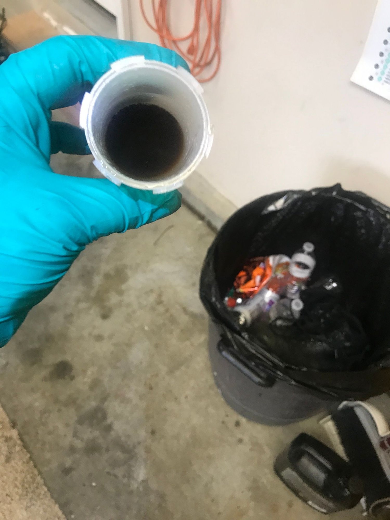

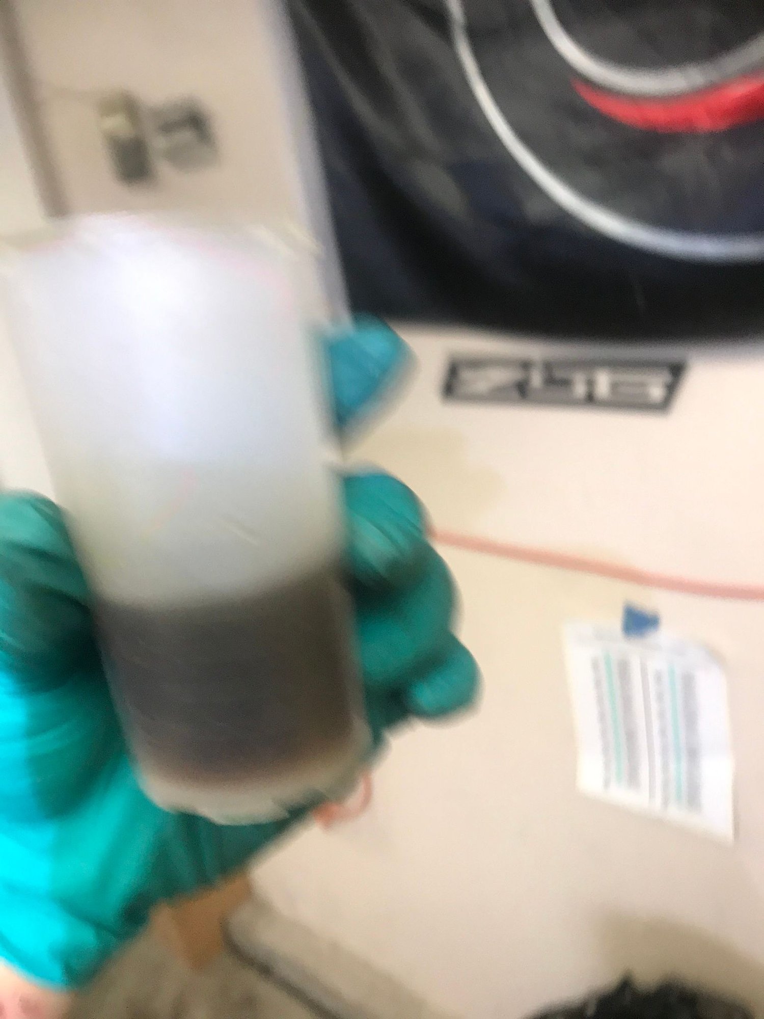

The ranger method sucks and is a complete waste of time. Purely emotional feel good process. I would be willing to bet any person on this forum could use a gallon of fluid doing the ranger method and it would still be pitch black bleeding it proper way. Now on the flip side bleeding the clutch is a pain in the *** the cat has to come off the manifold and unhook from the x pipe to gain access to the bleeder. A mighty vac helps but it's still a day long process. These pictures are after 16oz of the ranger method right out out of the release bearing.
