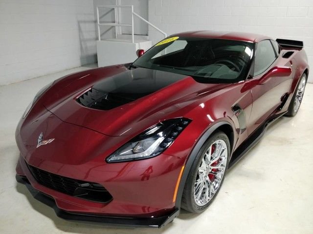

bought a 2016 z06 with 97 miles on it. i assume the battery was removed while it was stored and the car needs to be run thru some cycles before its ready for emissions test it has failed 3 times now after 300 miles of freeway and city driving. dealer told me there were no codes and all i had to do was drive it some more but i had a friend plug in his scanner and he said it had two codes, maybe the system is still waiting for some feedback from from some of the sensors? codes are P26C8 and P184C. Any help would be helpful.
