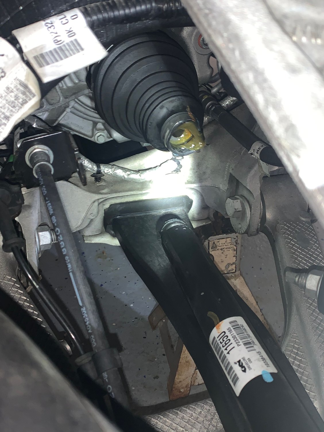

Broke an axle at the drag strip today. I’ll eventually get stronger aftermarket axles but just looking to buy a used stock one for now. I’m just wondering if all C7 use the same ones, stingray,Zo6, auto?? Thanks

You broke a soft part and less expensive than a diff. The safety fuse 😃
I believe they are all the same. I was thinking about this a few weeks ago on the way driving to the track

Are the drivers and passengers axles the same, interchangeable?

The axles are usually a different length, at least they were on my Camaro so I'm pretty sure its the same on the Vet. Did dead hook or was it wheel hopping when it broke?

Wheel hop when going into launch control on first pass of the day. Had the 888Rs at 20 psi and the track was sticky.

Ordered an OEM axle online for $193. Seems to be the same axle part # for all C7s, auto, manual, left or right side. Stingray, Z51, Zo6, Grand Sport, Zr1
GM part # 84228346

That was my thought process also but when with 275/60/15 and still snapped the axle. They were aired down to 16psi, it went out about 30 feet and snapped. No wheel hop but it felt like it was going to be a 1.4 60'. I replaced the axle and my new launch was 2.4 seconds. Haha talk about gun shy. I did get that down to 1.7 on my next run.
This winter I'm doing DSS axles and upgrading the rear with 4 spider gears.
