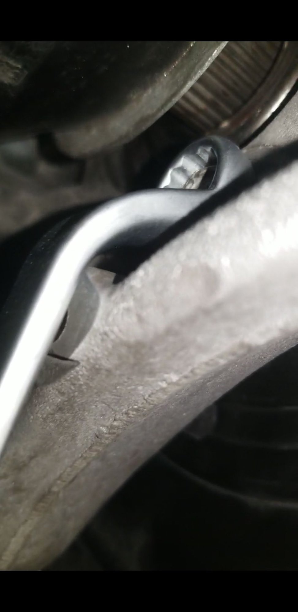

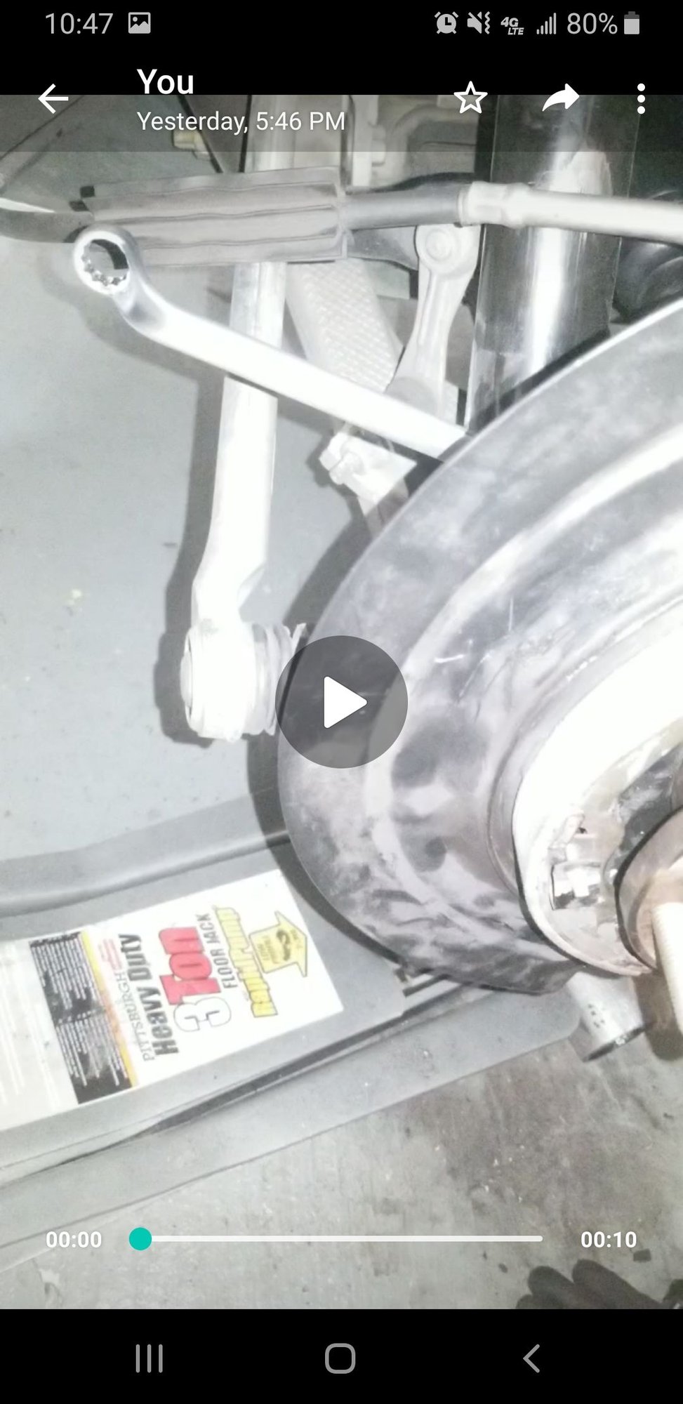

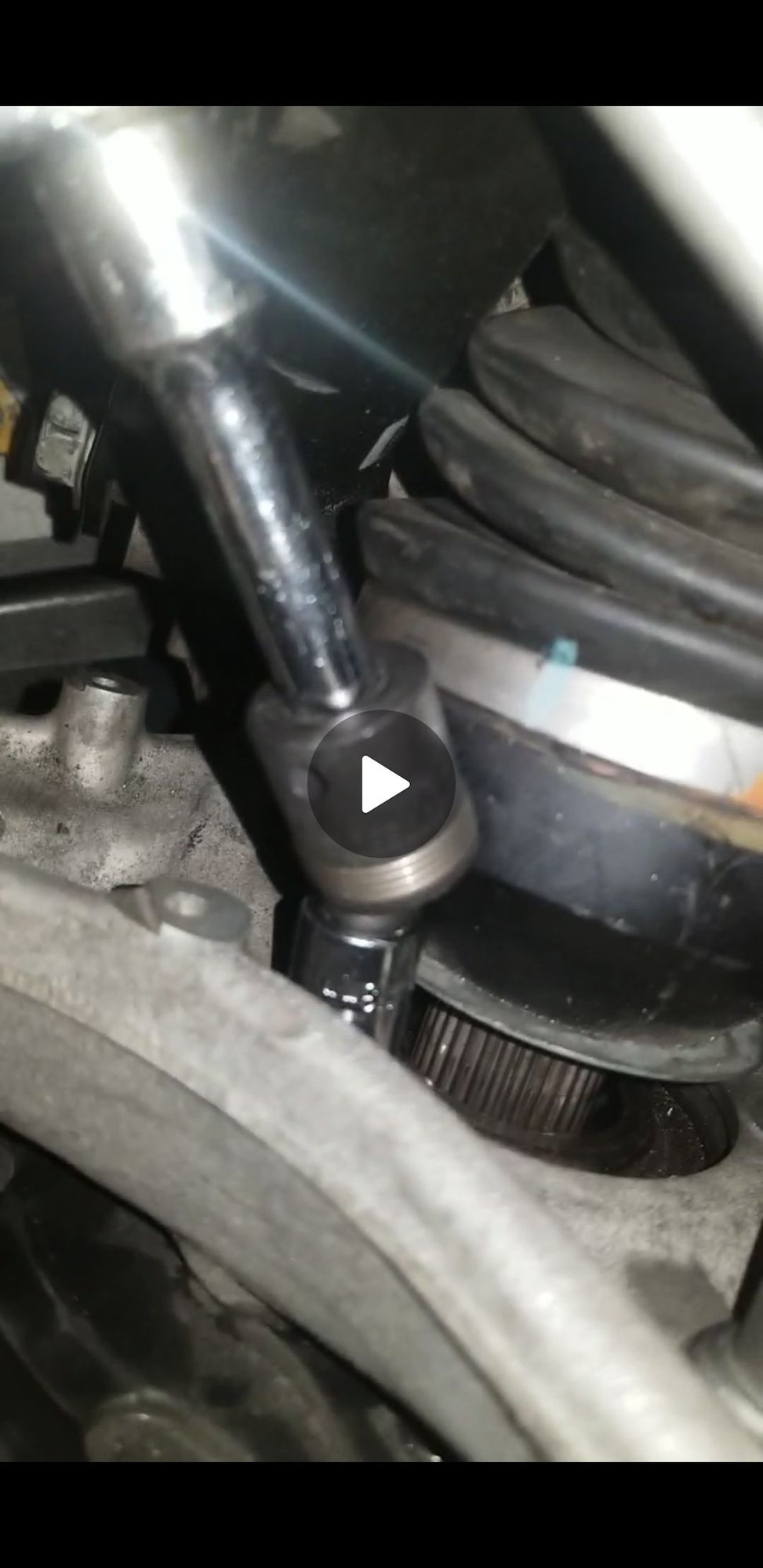

Negative. If the hub bolts arent crazy tight and your penetrating fluid works well, all you have to do is remove brake rotor, loosen the axle nut, push the axle in and you can use an offset box wrench or socket with impact universal bit to get the hub out. My car only has 25k miles and I needed a breaker bar to loosen those 3 bolts. So I had to get the axle completely out of the spindle:
upper control arm bolts
Shock lower bolt
Toe link outer bolt
Speed sensor (oops I haven't put that back in yet!)
If your bolts aren't crazy hard to remove this is best case scenario:
This also works, but once again, mine were so darn tight I needed to take everything out of the way and use a 1/2" breaker bar. Def not 84 ft lbs worth.. more like 150 or more...
