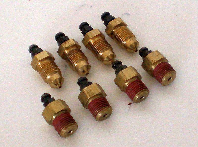

Almost correct. Was going to offer this up as an alternate as well. The M1 x 1.0 brass fitting for many Wilwood calipers can be fit to any M10 caliper so long as the thread is acceptable length.
The bleeder nipple inside the brass is 1/4-20 (steel) and like others can rust in time but replacing that doesn't lead to potential damage to the caliper body- the reason for the 2pc bleeder.
The upper set is M10 here. The under hex length to the start of the tapered seat is about 14mm
