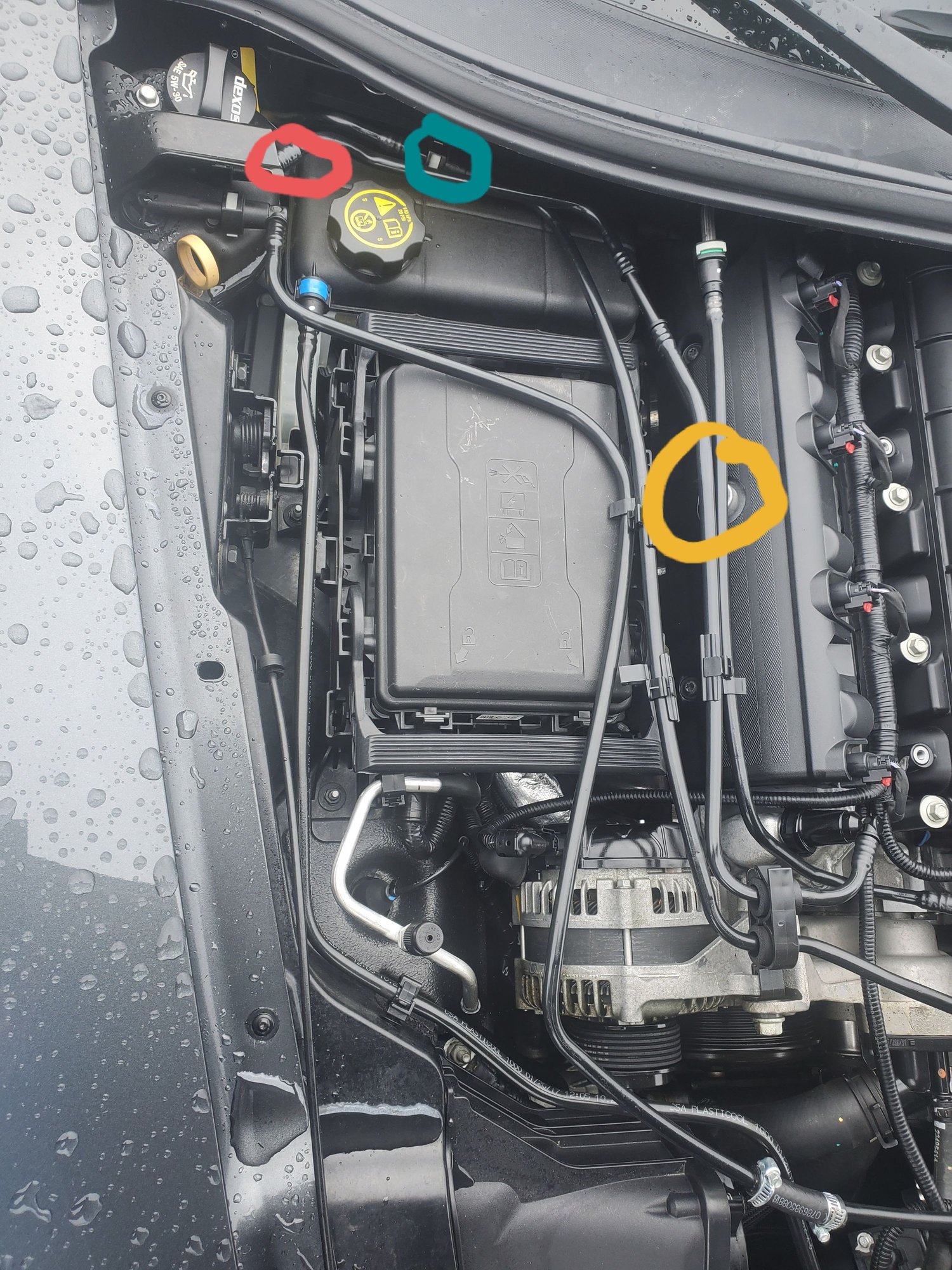

Where the hell has LMR went? I have sent 2 emails, called like 8 times, left 2 messages and PM'd them here...
I just need some clarification on their breather install, since I have a 17 GS with the extra breather line.
Can anyone help?
So much for customer support.
Do all three of these lines just get "T'ed" together and put into the 4th spot on the breather can?
I just finished replacing the main seal, and def don't want to have to do that again. It wasn't the hardest thing to do but def a pain.
Thanka for the help!

I appreciate your help, although I have the extra line that you do not have. Look at my pic.... That is the issue. I have seen your pic on here, but the question is, do ALL 3 of the lines get connected together. It's the one you have highlighted in yellow. And I know the first line (most forward line that was from the port just prior to the throttle body) gets plugged.
I have replaced the main seal once, and once is enough... dealer refuses to do it. And truth be told, it's not worth paying them 1k to fix it..... but I don't want to do it again lol.
Thanks!

I did not have those.
That shows all 3 lines connected together and then routed to the breather tank.
That's what I needed.
Thanks!
