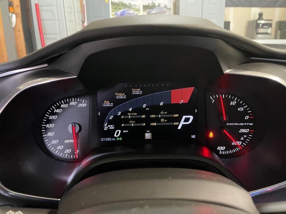

Let me start of by apologizing for my stupidity, I am the least mechanical inclined man on the planet lol (2014, Z51 3LT if that matters, 21k miles btw)
So here it goes, Quick question, was driving around and noticed all the sudden while I was stopped to talk to someone yesterday in my neighborhood, my engine temp gauge went from the always steady 220 spot up to 240-245ish, once I started driving within 40 seconds gauge went back to the usual 220 spot, at the red light started back up to 240-245, as soon as light turned green, went back to normal within seconds. Parked the car, shut off the car for about 10 minutes, and on my drive home (about 5 miles) the temp stayed at normal temps and even let it run in the garage for a few minutes and temp gauge never moved. I’ve never seen my gauge move so this had me pretty alarmed but now not sure why it did it, then stopped after shutting the car off?
Fast forward to about an hour ago, I let the car idle for 20 minutes, analog gauge held at 220 as usual but the digital seems to reflect lower? These 2 never seem to match. With AC on, fan comes on intermittently but not constant, is that normal? While idle even at 220 with A/C off fan never seems to kick on but temperature never fluctuated. I can barely hear the fan, I thought it used to be super loud but maybe since it’s cold out it’s not spinning as fast when A/C is on? Picture was of my dash while it was at idle in the garage today.

The 2014's analog gauge is NOT accurate, it is basically an idiot light that reads below 220 when "cold", right at 220 when "normal" and above 220 when "hot". If you want the accurate temp monitor the digital gauge in the Touring DIC display.
I track my car (2014 Z51 M7)) and the digital temp reads 220 max while lapping in hot FL, so 240 seems way high for street driving. Your water temp should stabilize around 200 under normal driving conditions and only vary about + / - 10 degrees.
So either thermostat or fan relay issue I'd bet. The fan relay is a common problem in early model year cars.

So drove it again today for several miles including 2 miles on the highway, and even at idle at red lights and once when I gunned it on the highway the warmest it showed was 205, 199-200 when I gunned it on the highway), the car stayed between 195-205 degrees, Is that still to hot? My analog gauge which is what up till Sunday I always looked at, (I thought 220 is what the car always ran at by looking at that gauge) never budged. And to clarify, the day it showed a higher temp, I never got warning lights, etc, The analog gauge just went up to a line or two below the red lines. but never over heated officially.

^^^ that sounds exactly like my 2014. Real digital temp hovers around 200 while the silly analog gauge just sits at 220 once warmed up.
The 2014 thermostat is set to around 190 degrees - more info here: https://www.corvetteforum.com/forums...ermostats.html

Are you worried that you over heated your engine? Unless the pointer or digit pegs in the red, you did NOT over heat your engine. The '14 runs happily at 220 The car will throw DIC messages and do all kinds of things when it is getting overheated.

Set the display to Tour, then select Performance... and you should see this:
Search YouTube, there are several videos that walk thru how to get the various screens - the manual isn't super helpful when it comes to all the options here.

Thanks for the help. That works but I can't believe the difference between that and the analog! My analog stays pretty much at 220 while this shows between 185 and 195 most of the time. I like those temps a lot better...

Yep... the 2014 analog gauge is full of lies
If you use an OBD-II scanner it reads the same as the digital gauge.
I found the TSB regarding this problem, see attached, per GM this is "normal" behavior.
