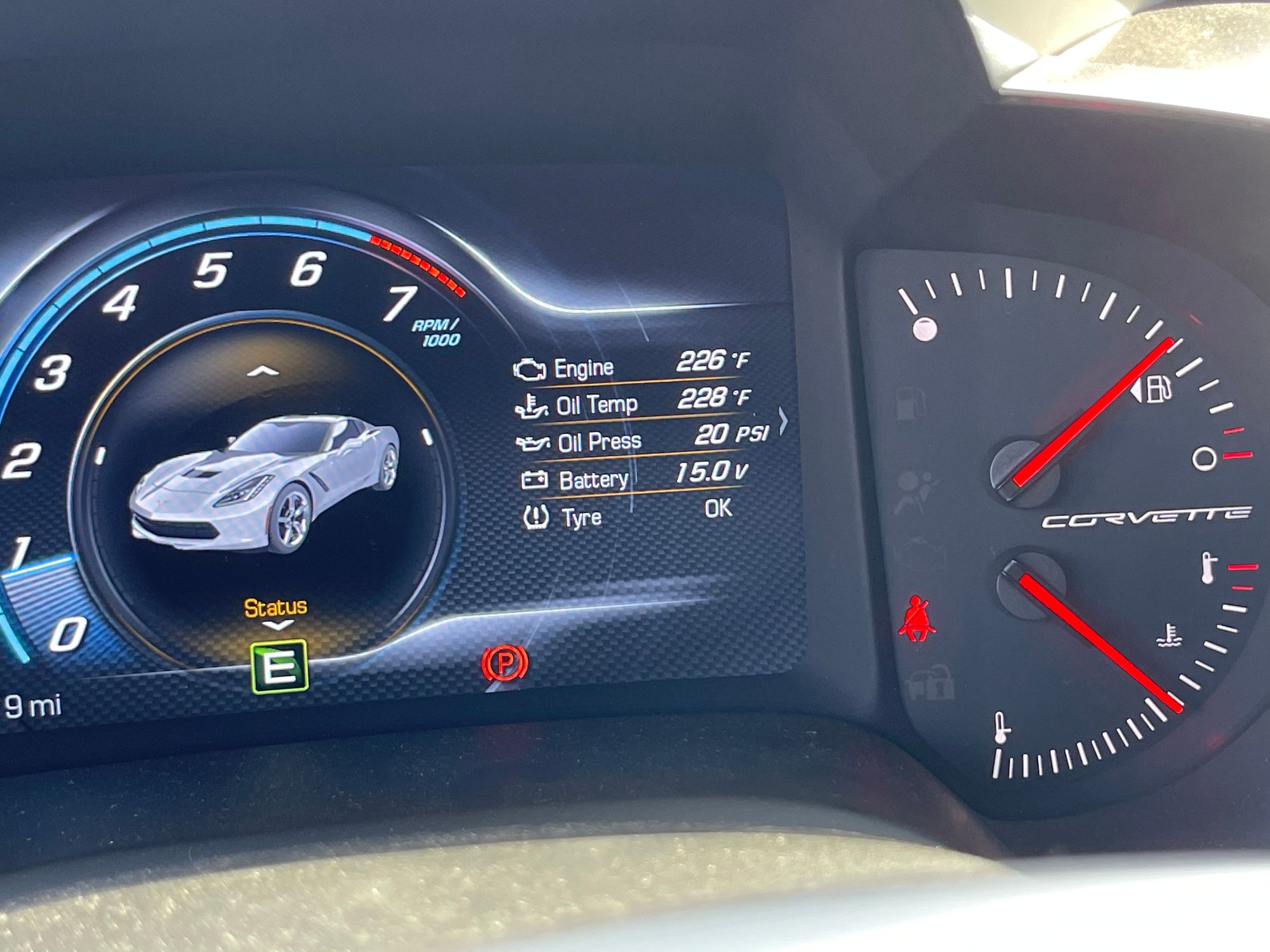

I noticed a while back that my car wasn’t staying cool when I was thrashing it. But now it doesn’t even seem to stay cool during regular driving! The other day I took it out and glanced down at the gauges to see that it was one notch away from the red on the coolant temps.
I thought this might have been due to air in the system so I drained it, installed a performance radiator and refilled giving it a proper burping.
Temps are still in the 260 range and the radiator is only medium-hot to the touch, not 260f hot.
I'm running an AMP 160deg tstat and housing.

Bad temp sensor.
look at the difference of the oil and water temps. If the engine was really running that hot the oil temp would also be high.
Only good way to remove all the air in the system is to use a vacuum, such as Air Lift.

It’s starting to look like I may have an air lock somewhere.
ive taken the car out 4 times now. Every time when I got back I let the car cool down and opened the rad cap. Each time it’s gurgled and sucked down a bit more coolant (assuming to replace air pockets?)
It’s now running at 230 after 20 mins of slightly spirited
driving.
I should be expecting better than this with a performance radiator, water wetter and only 15% antifreeze - right?
on track my oil runs about 40 degrees above water temp. During street driving they mirror each other and both stabilize to 195-200.

the wear and reduced hp would only happen if the engine was constantly running cool
tho right? My engine seems to have no issue getting to temp and quickly.
I don’t think it can be the cooling fan as I can hear it running all the time. Not only that but my temps go UP while driving and down while in traffic.
im wondering if my FMIC is just pushing too much hot air into the rad?

tried all that. Even jacked up the rear of the car so that the bubbles will rise upwards to the expansion tank.
Also went out in the car several times, hit the brakes hard to move all the coolant around thenwaited until it had cooled before opening up the tank and adding more.
I think my cooling issues are party down to the pro charger vertical intercooler tho. I’m running a lot of boost so I imagine the interxooler is adding a lot of heat to the rad
So the car is modified... then no real surprise that the stock cooling system is struggling.
And I just noticed the European (I assume) temp gauge fixes the problem of incorrect read out on the US spec 2014 analog temp display! why didn't GM just use this gauge for all models? Same with the fuel gauge... I like the Euro one better too! Why GM why?!?

It is hard to diagnose over the internet. First, thing we really don't know is how hard are you driving the car. Just because you say you are driving it hard doesn't mean you are actually driving it hard. For instance, your coolant temp of 226 degrees is just a little higher than I see with my C7Z when I am on the track running fast laps with speeds up to 155 mph. Even starting out with coolant and oil temps below 170 it only takes one 3.2 mile lap to bring the engine up to 220 coolant and 269 oil temperatures.
Bill
I wasn't driving hard-hard, as my car is still in the process of being tuned for the additional boost. However I did a couple of pulls to about 5k rpm and a bit of driving around town. So no where near the level of hard use it would see on a track.
Not the stock cooling system. As mentioned in my first post I'm running a performance radiator (about 2x thicker core than OEM) and also mostly straight water + water wetter. I also have a 160deg Tstat and have deleted my A/C so thats one less radiator for air to pass through.
Originally Posted by 123sugey
Like the last two posters ... really looks like a bad thermostat. I do agree though making good power the inter cooler is another issue for sure.
There's no harm in removing the tstat just for testing purposes is there?
I may put a thermal probe on the intercooler too to see how much heat that is adding. Its hard to get a good idea based on AIT's as I'm spraying meth.
