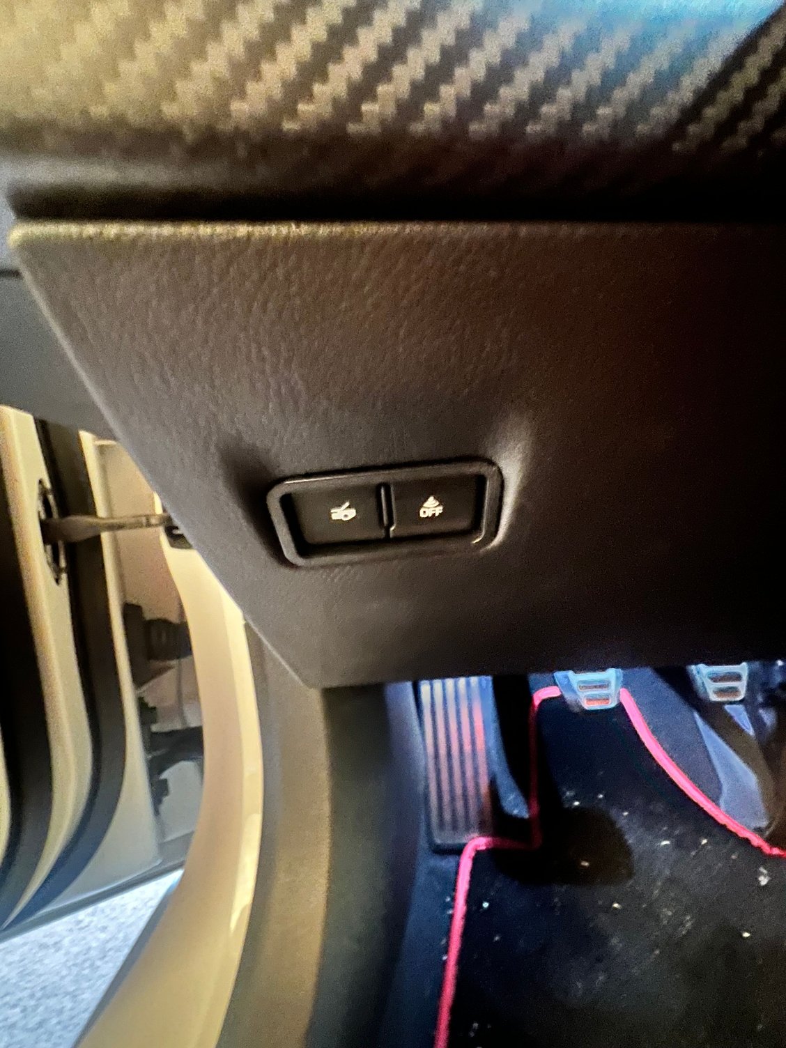

Sometimes all that is needed is a really rainy day. The C7 trunk release location has bothered me since I took delivery of the car. And after your knee inadvertently hits the switch and releases the trunk lid, your are required to get out of the car and go to the rear to shut it. Of course the easiest mod is to simply disconnect the switch.
A little research on OEM wiring led me to the HUD control panel as a location for a switch to cut power to the deck lid switch (unless you have a convertible). I had a few seat heater switches in the bin and they snap in easily into a 3/4" (19mm) hole. The end result:
FYI, the black/white wire is the live feed to the trunk release switch connector, black is ground and yellow is the feed to the trunk module.

I recessed the switch with a different mount surround which recessed the switch.
I recessed the switch with a different mount surround from Sandyeggo designs which recessed the switch. No more unintended hatch openings.

I have hit mine a few times when at the drag strip and the seat being closer. There are a couple of online vendors that sell a new recessed bezel for that switch that is super easy to install, cheap, and works perfectly to stop the inadvertent knee trunk open.
Corvette Central for one.
