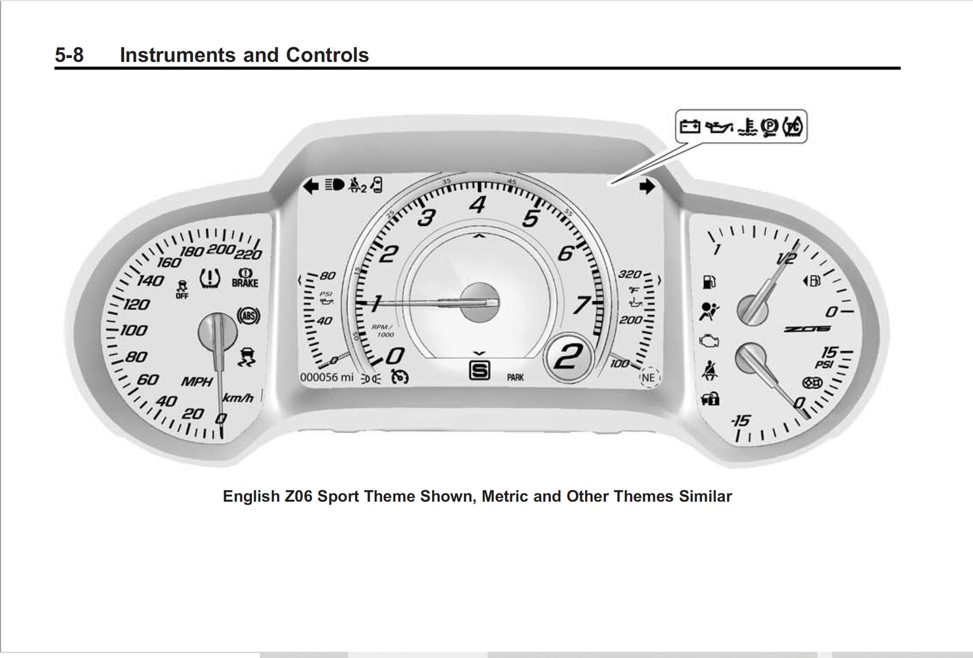

I have a very small (looks like flashlight battery display) in the upper portion of my DIC display. Everything seems to be ok but I have no idea what it is and can't find anything online on the the car manuals. thank you for your help.

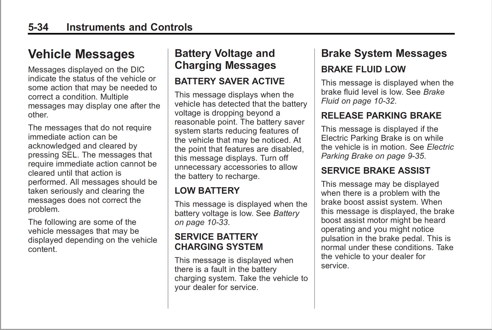

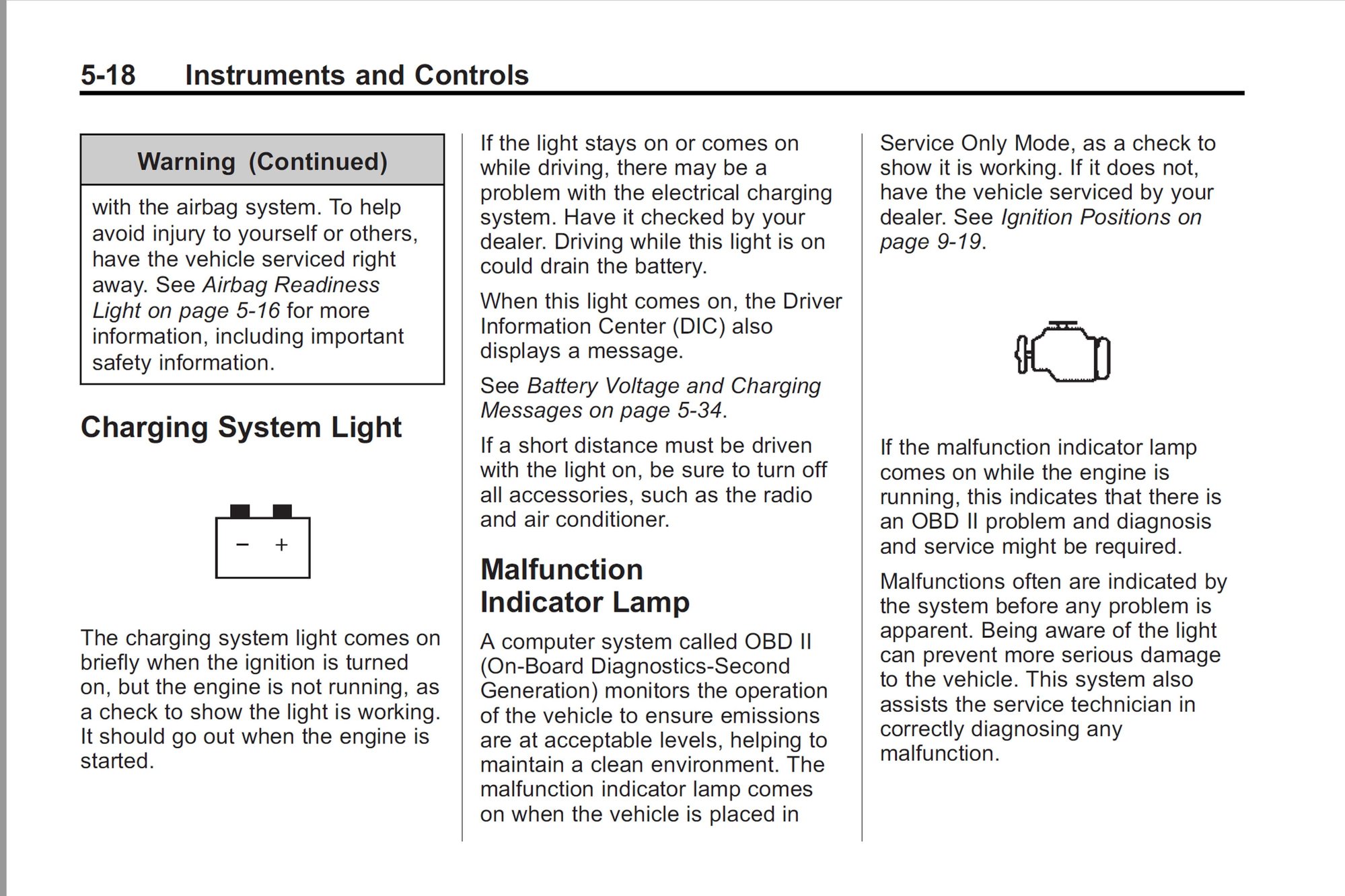

From the 2015 Owners Manual:
If the light stays on after engine start you have a battery or charging system problem. If you see the Service Battery Charging System message check the cables attached to the battery. There is a small black wire attached to the large black negative cable. When the battery is removed from the car it is easy for that small black wire to be broken as it is a little too short. If that wire is broken that will cause a Service Charging System message.

I have looked at the display again and it only appears after I start the car. It is not a battery issue since the battery is ly 6 months old and the display just arrived.
The display is not the normal battery display. This is very small located in the upper portion of the DIC display area.
