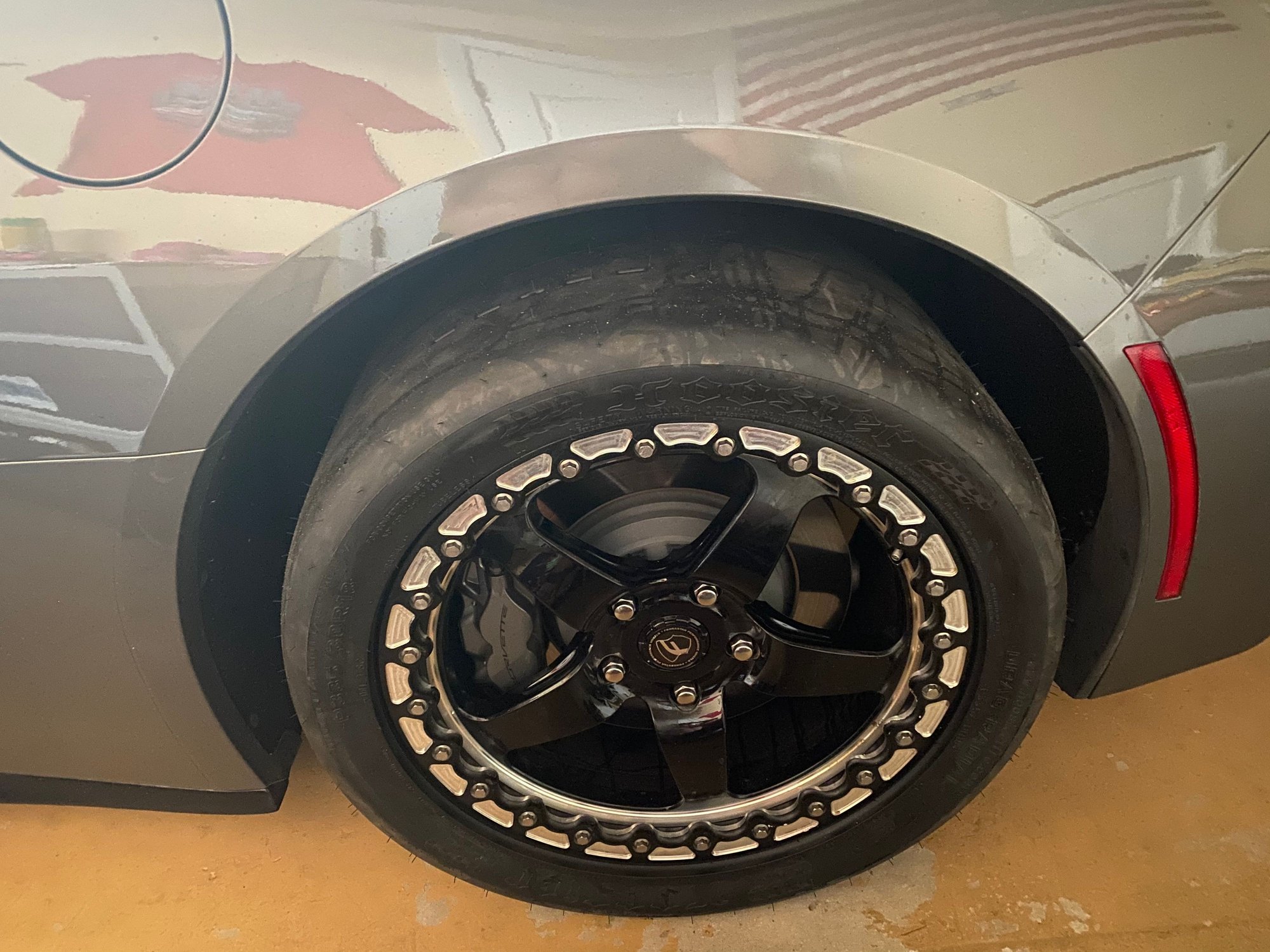

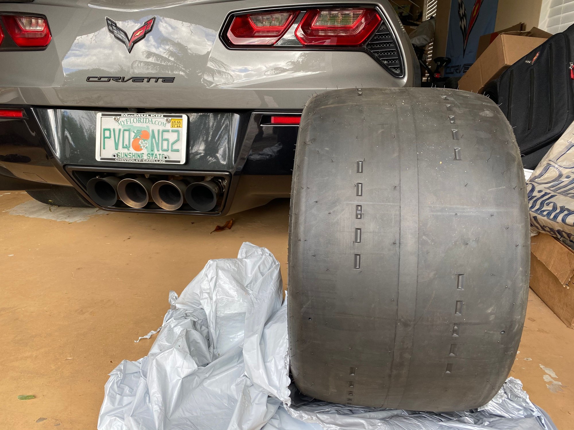

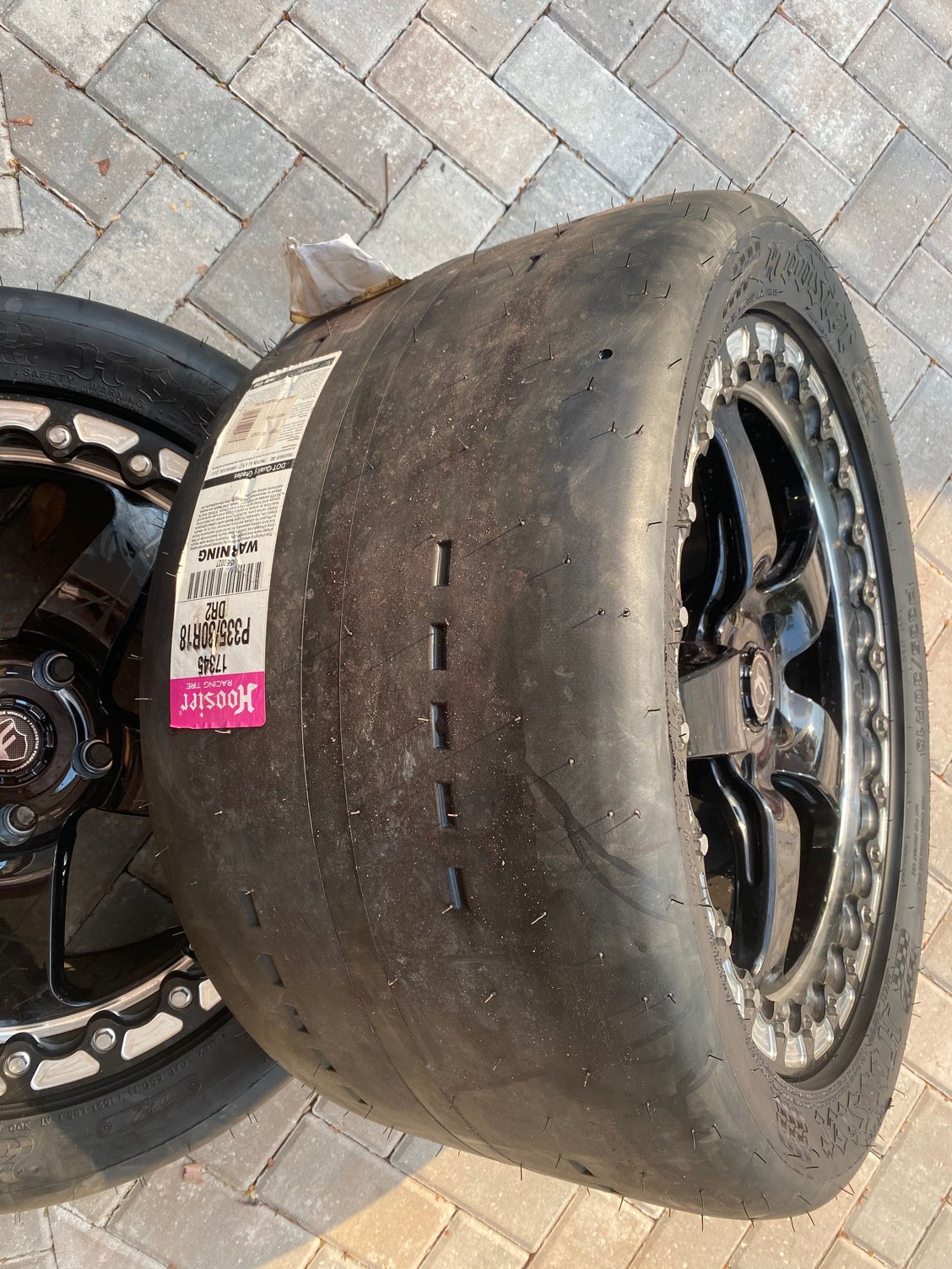

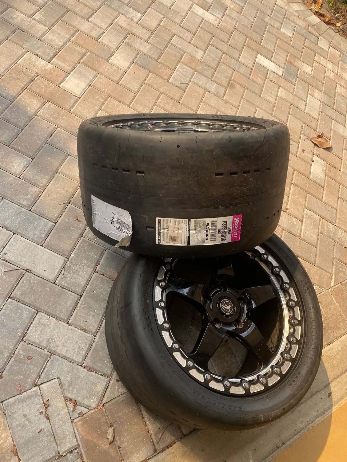

99% of guys with C7 Z’s are running bead locks stock and modified cars. I have Forgestar 18” D5’s with bead locks with mid 600 rwhp on my C7 Procharged Stingray. Ide say even with a stock Z on a drag pack I would run the bead lock(s). Mine are only the single outer bead locks. If $ isn’t any issue just buy them and if and along the way of mods and power you push the power there is one less thing to worry about. They also look badazz
