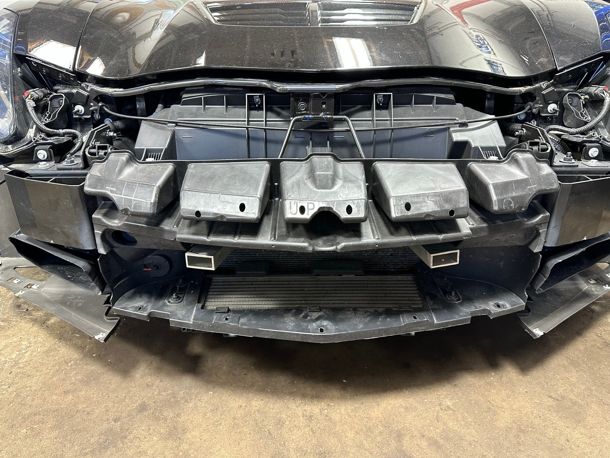

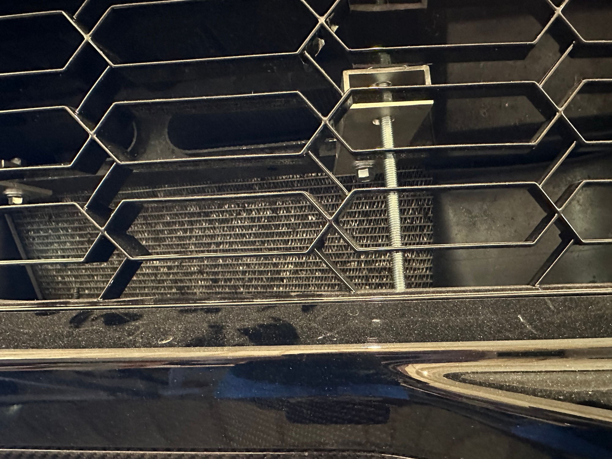

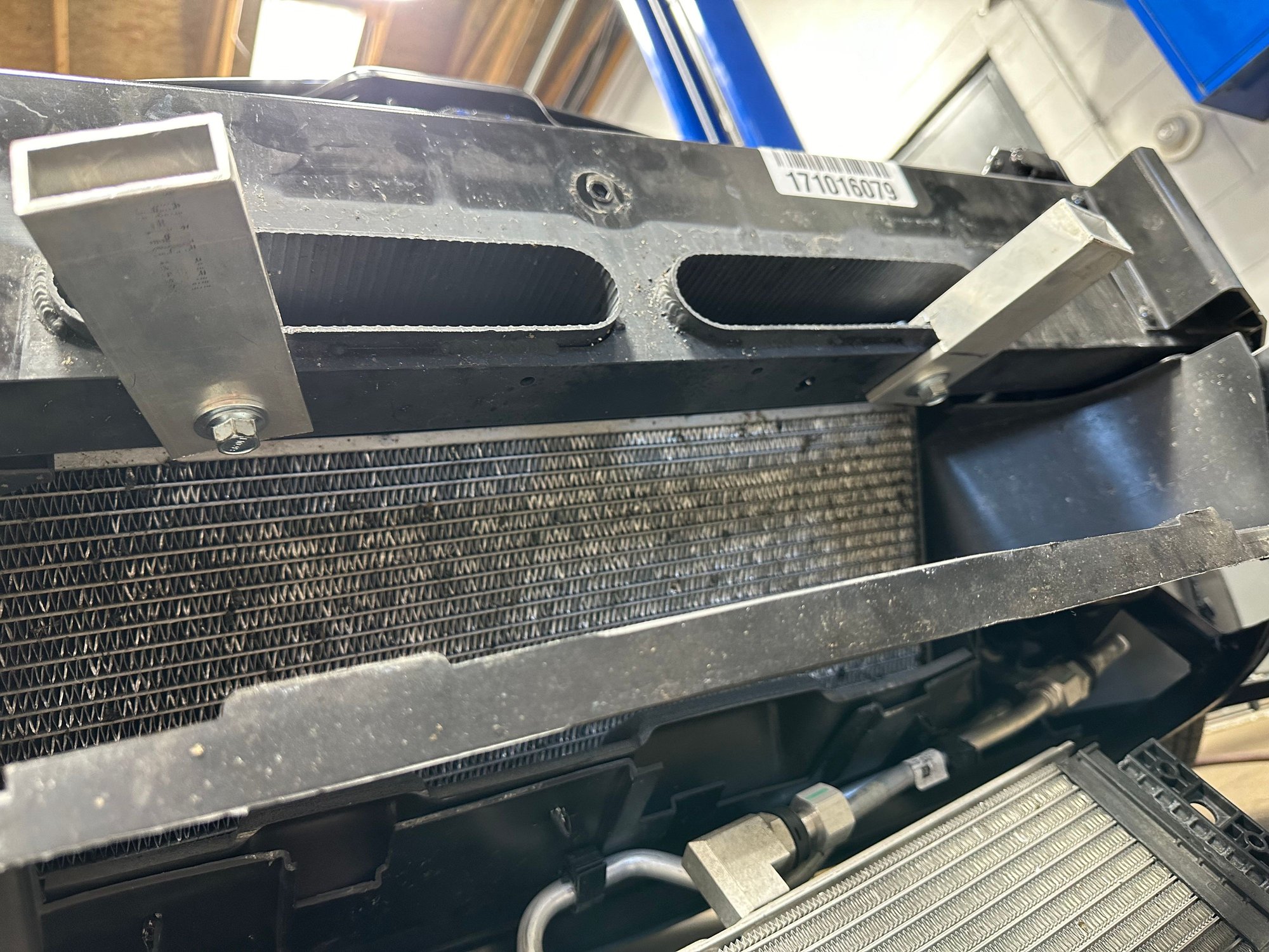

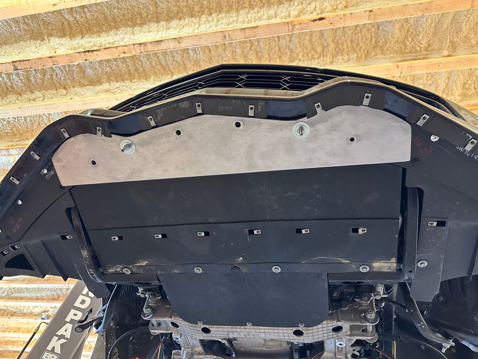

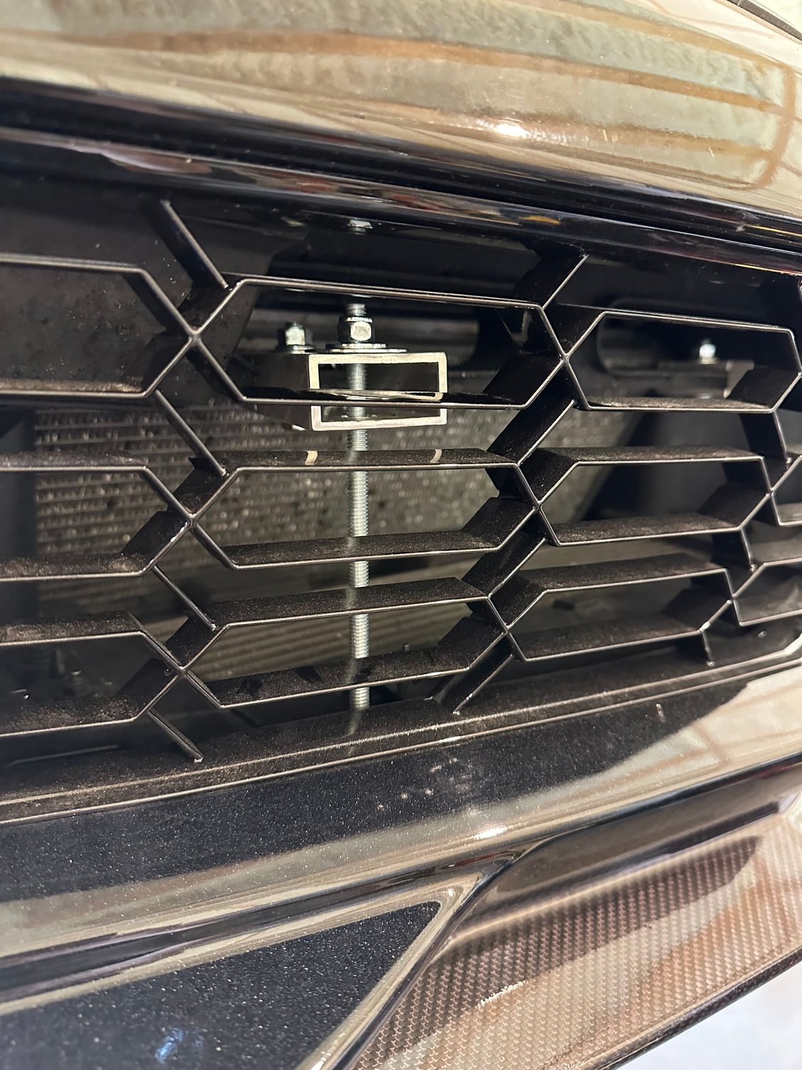

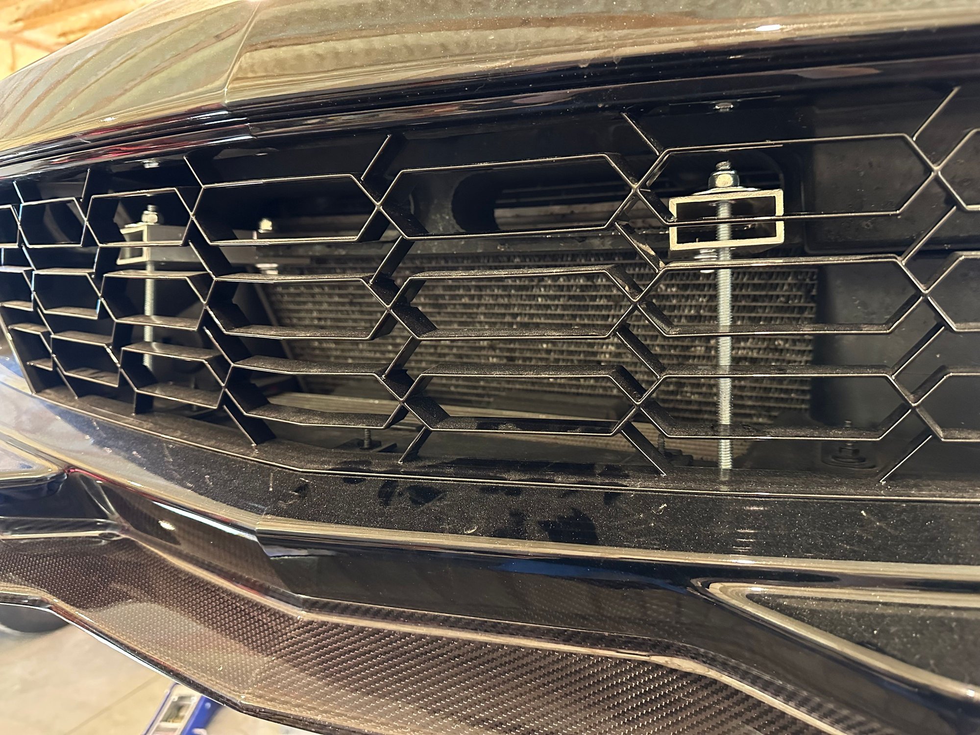

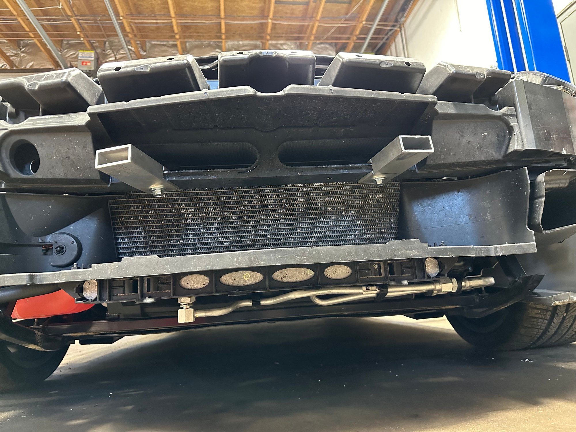

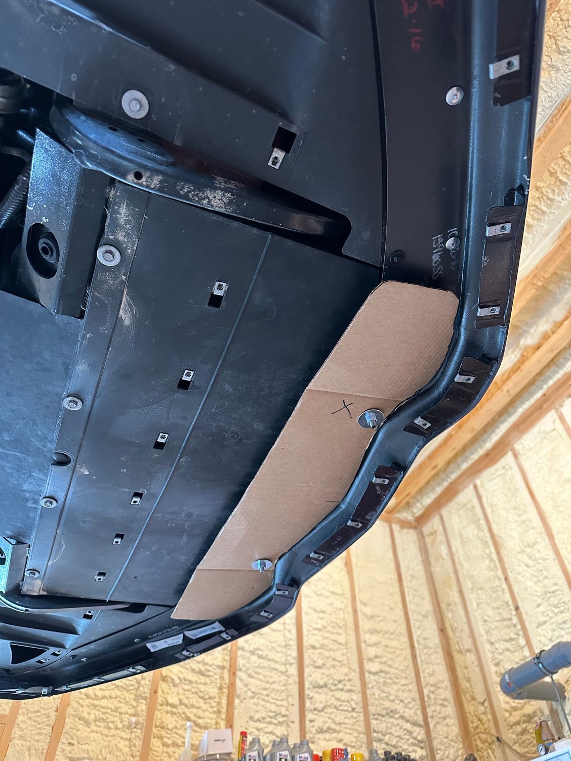

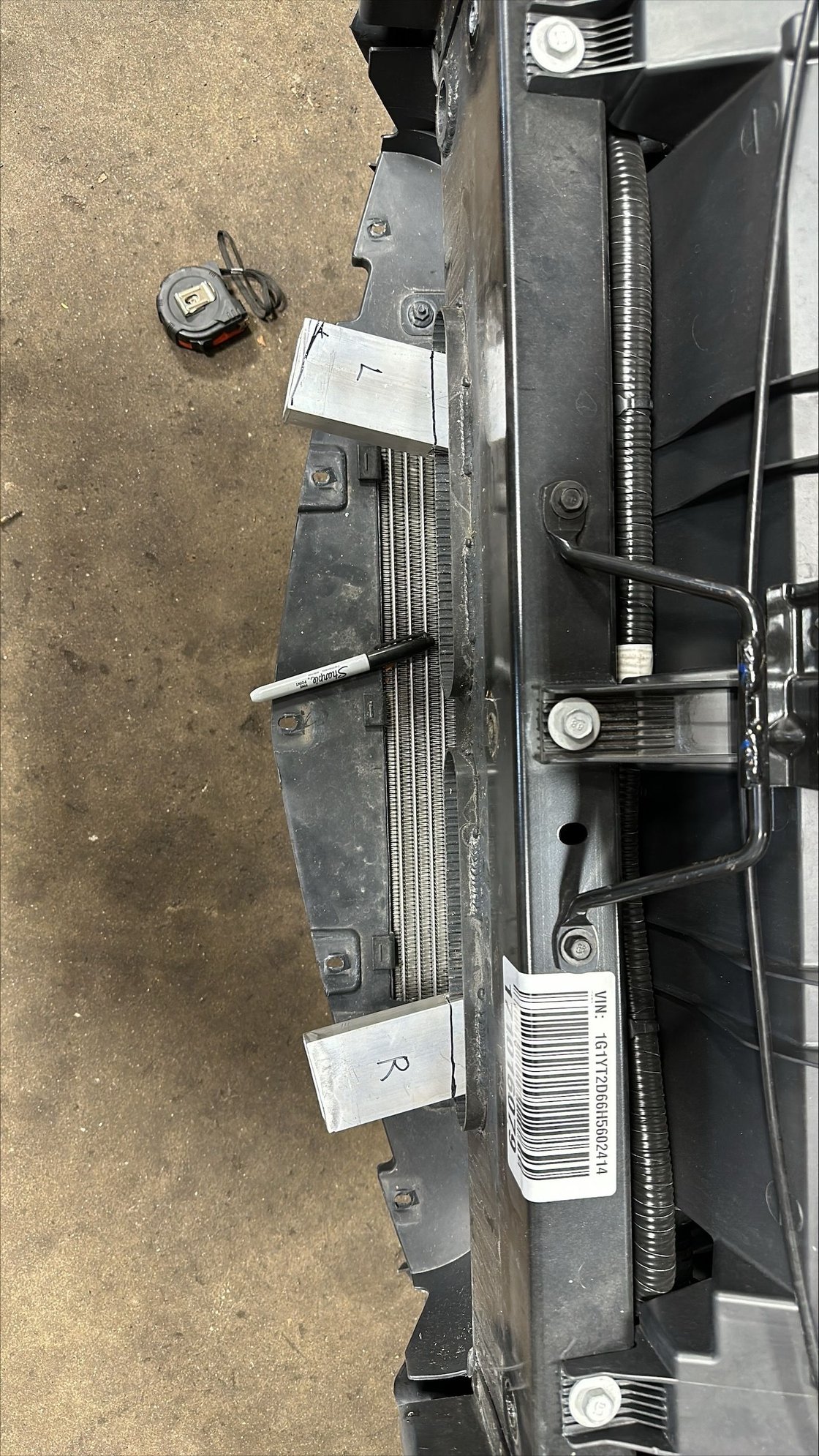

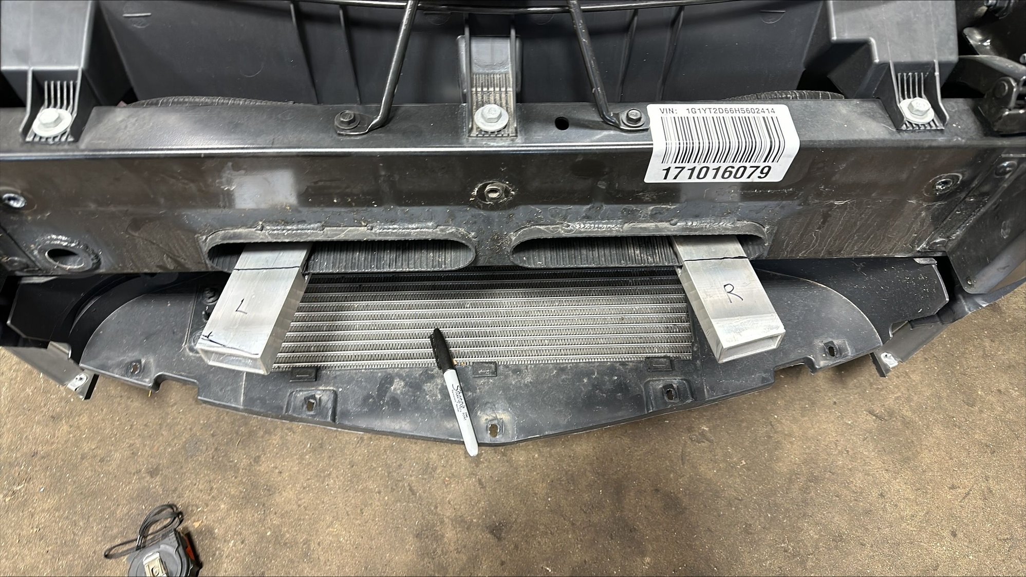

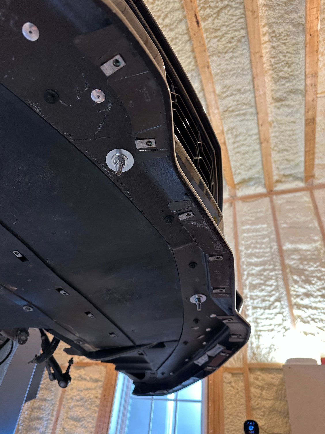

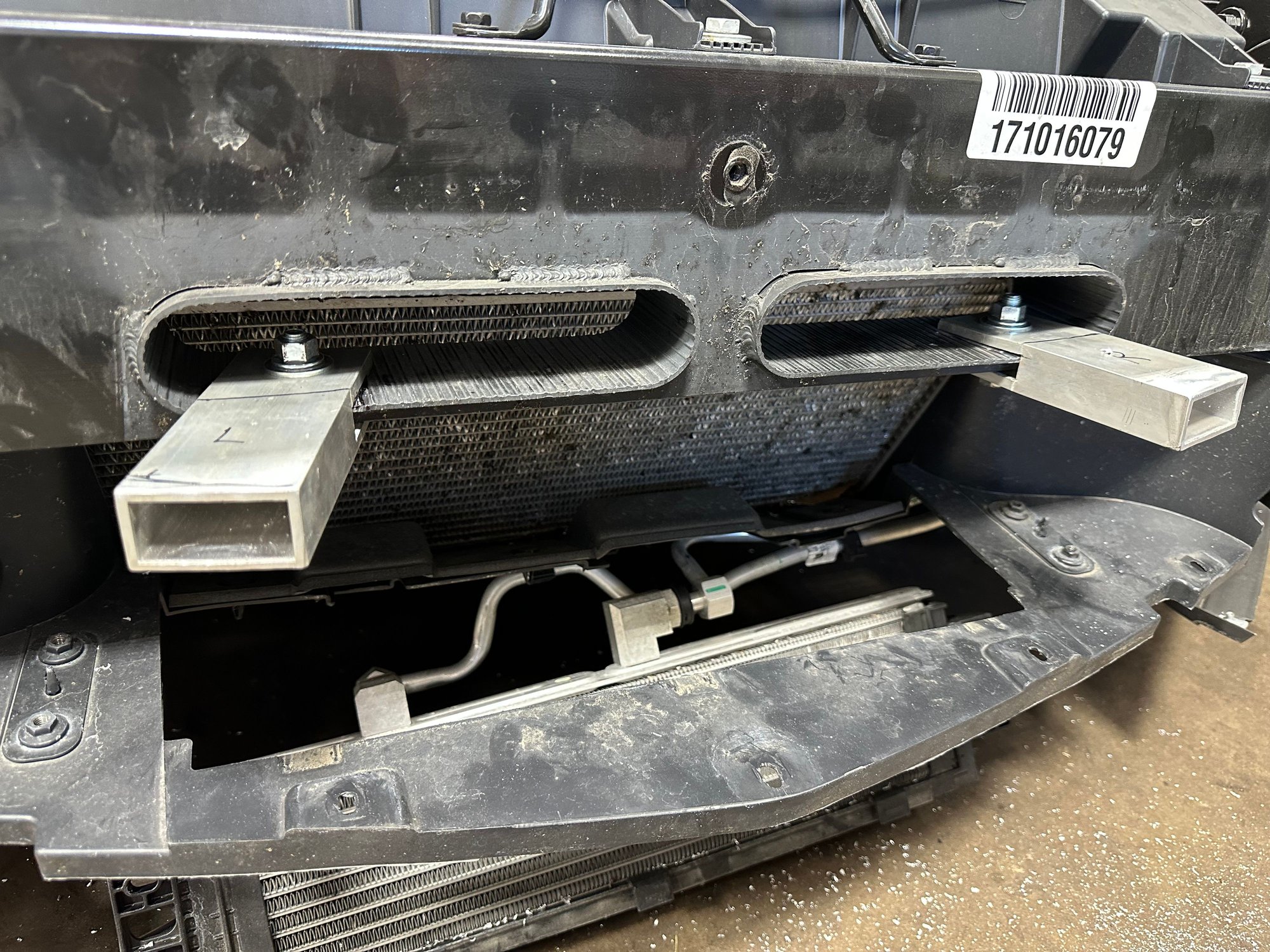

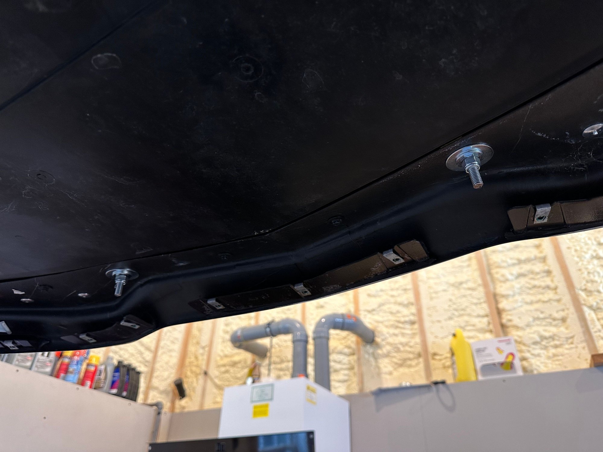

Figured I’d update this thread…2+ years later…with what I hope will be a good solution. The bumper had to be replaced because all the clips were broken where it snaps into the lower edge of the grill, and the rivets in the splitter had ripped large tears in the bumper. So while the bumper was getting replaced I cut these brackets out of aluminum and bolted them to the frame. Then installed 5/16” threaded rods up thru the splitter. I’ve also ordered a piece of 1/4” aluminum plate to spread the weight out across 34” of area…the cardboard in the last picture is the template for that. Also, planning to paint all the hardware behind the grill matte black.
Will be 1/4” aluminum plate

Nice! Wish I had thought of this too before I put mine all back together last year...

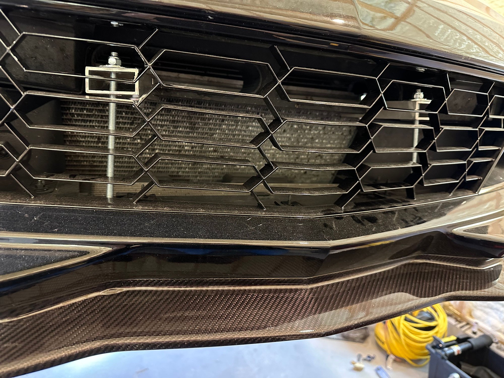

Added a 1/4” 6061 aluminum plate to distribute the force
