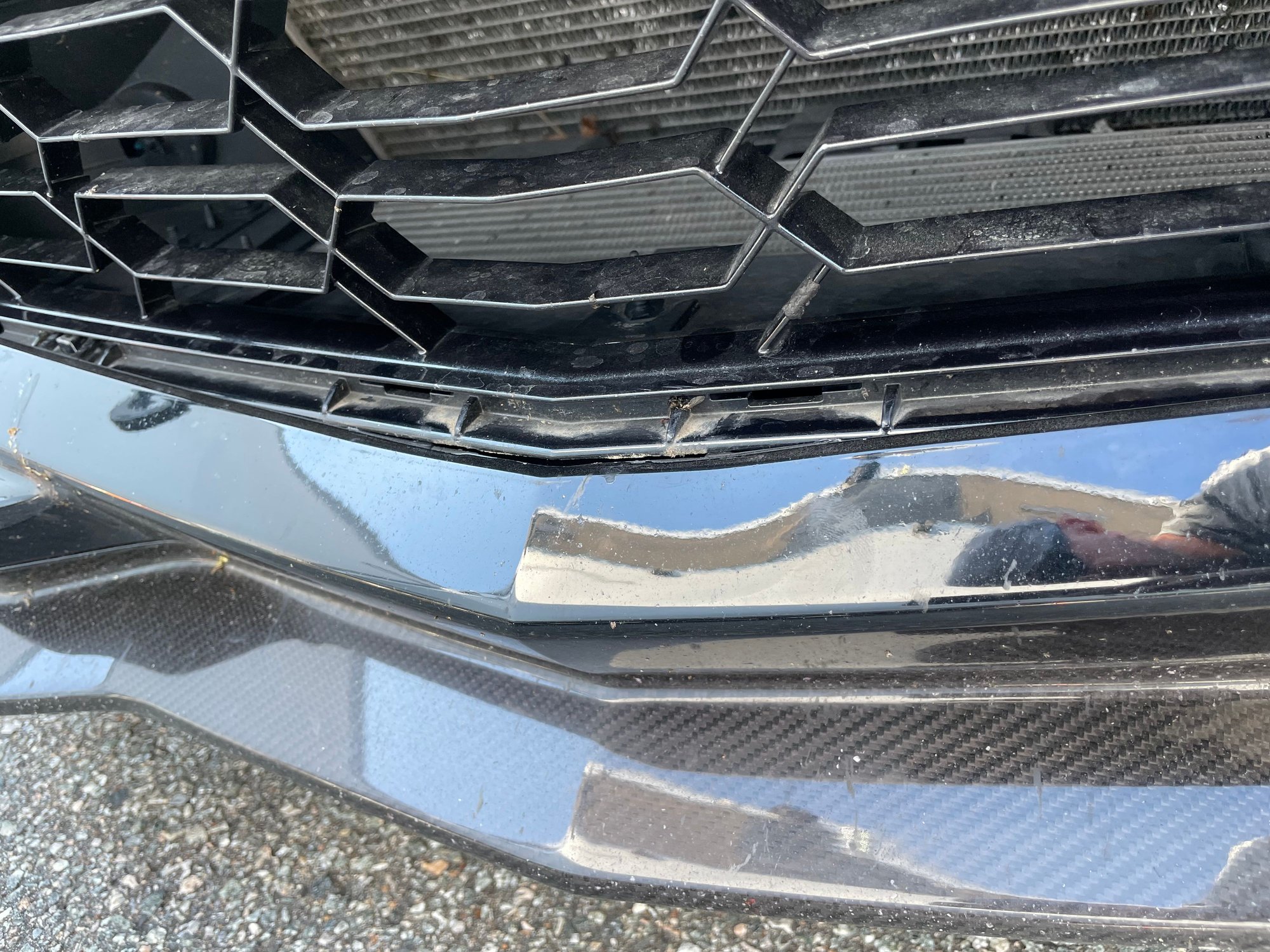

Hi All, I’ve got an issue where the downforce on the factory stage 3 splitter when tracking has broken the clips on the bumper cover where it clips into the bottom edge of the grill. Now when I come in from a session the edge of the bumper cover will actually be pulled down over the bottom edge of the grill. I have to dig my finger tips in there and pop it back up into the groove. Only happens at higher speed tracks…VIR, WG…speeds over 150.
Has anyone seen this? I searched the forums and couldn’t find much. Is it worth seeing if GM will help? Car is still under warranty… With the clips being broken obviously the bumper cover will have to be replaced…how do I prevent this from happening again after that?
Thanks for any insight…

Need to see a pic. The grill bolts to the bumper so I don't see how the bumper is pulling down over the edge of the grill

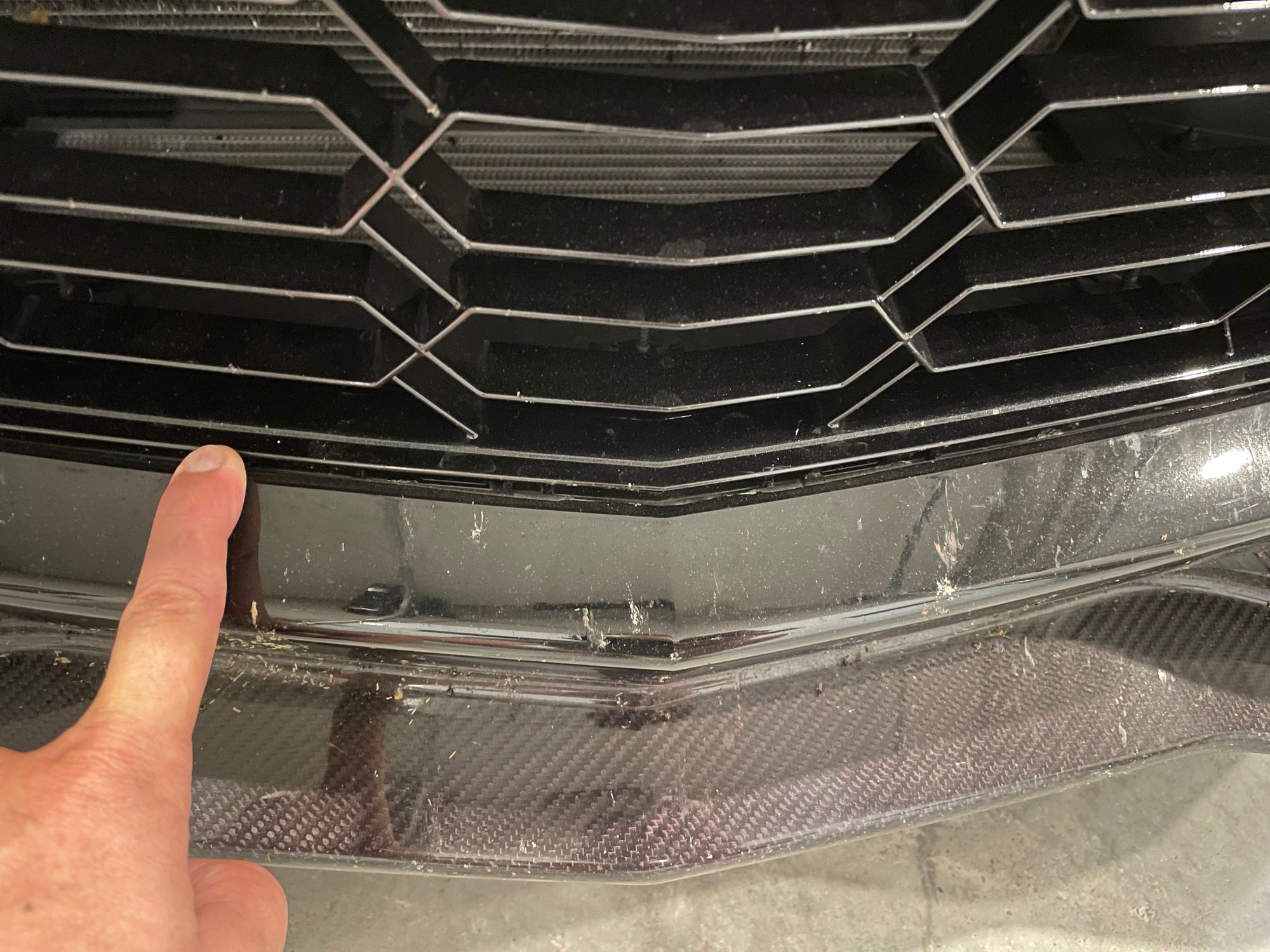

Default Pic
Right here…no bolts just little plastic clips. The grill has a slot in it, and the bumper actually ends up below the lower edge of the slot.
Sorry about the bugs…haven’t had time to clean up after 2 days at the Glen…

Got it, now it makes sense. Probably the best bet is as mentioned above....fab your own bracket. Some parts on the C7s are getting hard to get and the front bumper may be one that's no longer stocked. Even if you can get a new bumper, they have to paint it and you have to hope it matches. Ditto a used one.

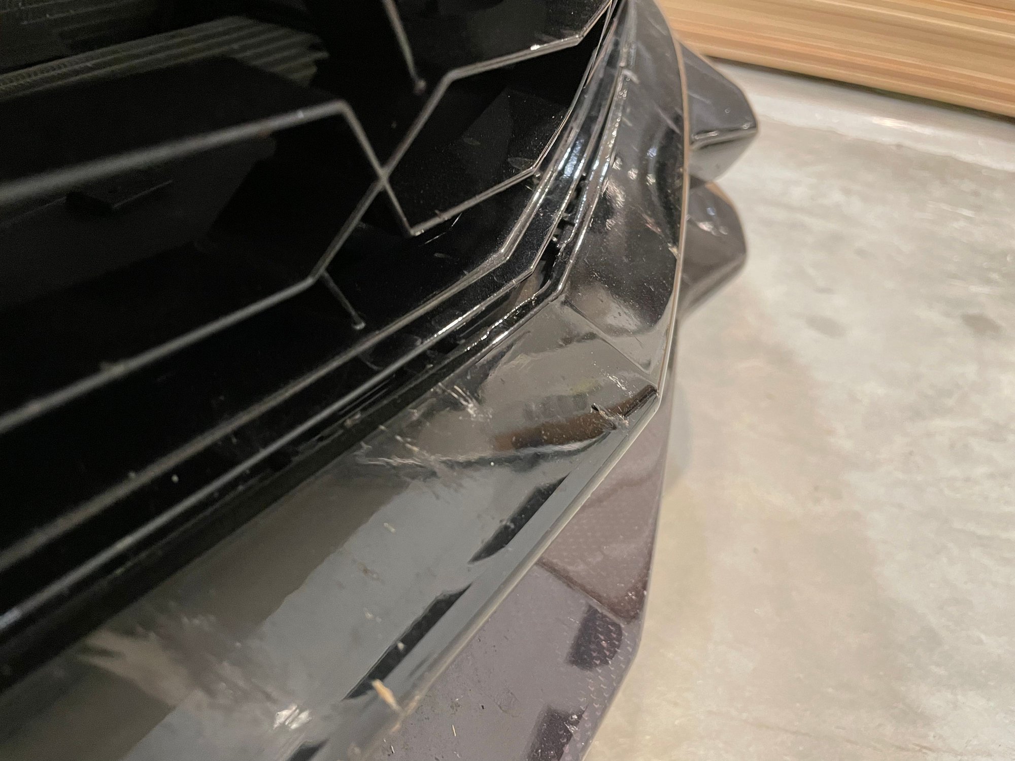

Saw this thread pop-up, I had the same thing happen to me, actually rebuilding the whole front, i.e. new bumper cover, grill, and splitter.
What I found was that the original dealer, did not install the splitter correctly, they didn't add the rivets. There are two sets of mounting holes, they only attached one set, the back set. The front set of holes, where rivets are to go, were not attached. this leads to a gap at high speed. I'd noticed over the years I got tire "marbles" in the gap between the splitter and bumper cover. It then got worse this year, and started breaking tabs on the bumper cover, grill, and there's even a "bumper cushion" behind the bumper cover that the grill attaches to, that had broken tabs. Thus leading me to replace many parts on the front end.

so I had this issue and the grill actually came out ontop of the bumper and it ended up breaking all the clips along the way, it’s worse than when it started. I was thinking of using epoxy underneath the grill for now but I’m going to be ordering a new bumper and hoping for the best.

Yeah mine does that also, pulls it right down over and you have to dig your fingertips in there and pop it back into place. Annoying for sure…
