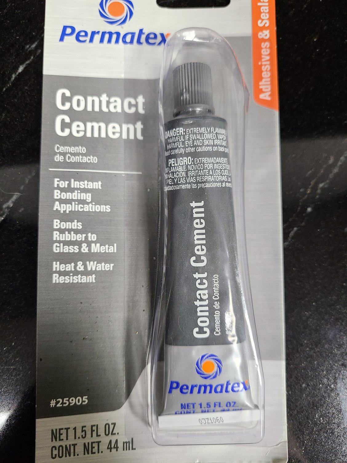

Greg was right. A little of this smeared around back side of riim...no slip at all. Fricken awesome Tip. Pitt

Hey pitman, so you used this along the inner part of the wheel bead and then had tire mounted.

actually tire was already mounted and spinning a couple inches on launch. I had the shop break the bead loose on the back and with a plastic glove on, smear the glue around the bead. Fill back to 30psi and Let it sit for 24hrs and it is not going to move.

That’s great news. A buddy with C7Z has the same problem I’ll let him know to try this

just don't put it on front side...lol

Use 1 per tire so there is enough

That stuff works great!
I've also used this with great success

Having that brush to use would be nice
