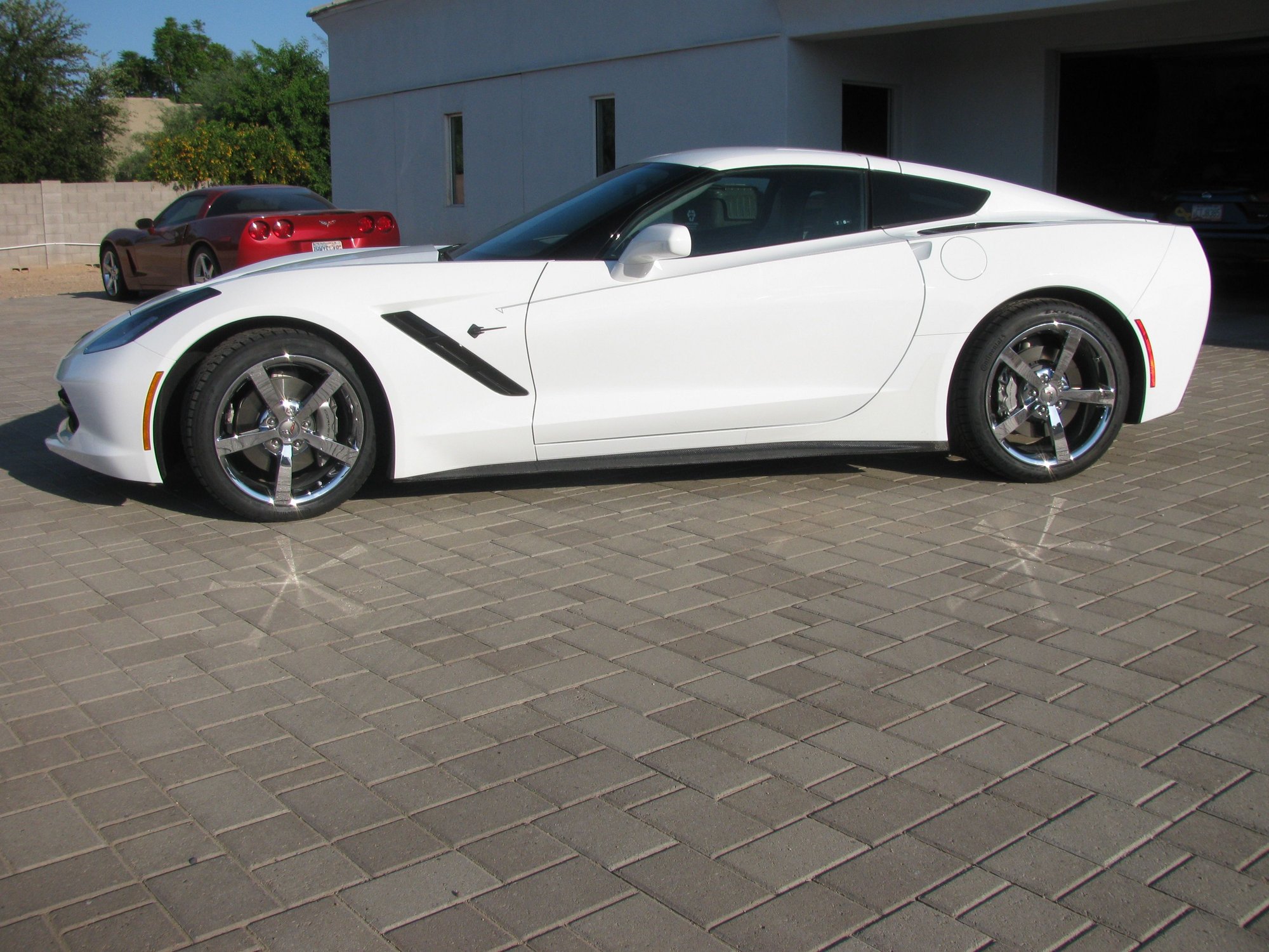

Originally Posted by RacerRik
Not only are the TPMS sensors incompatible, but the C6 wheels will not work on your C7. The spokes will hit the calipers on the front wheels.
C6 gumbies will clear C7 base calipers.
