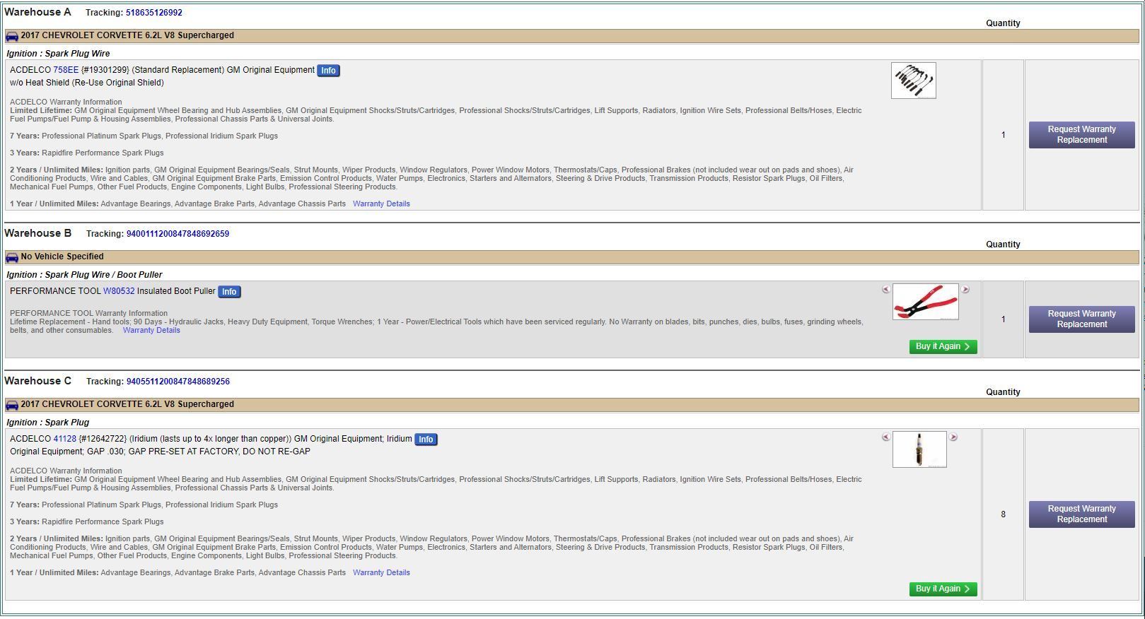

However, I tested the new wires and they're all 3.8 K ohms and the old wires are all 2 K ohms. All seem fine (no loss of connectivity when wiggling them around or anything). I went back to a GM parts site and the wires are GM # 12716289. Checking my parts box, it looks like I got GM # 19301299. They look identical. Maybe the extra resistance is enough to retard the spark and cause more misfires with my injectors already malfunctioning. I'll just replace with the original cables for now.
I ordered these from RockAuto.com and all I can figure is that they had the wrong ones showing up under " 2017 CHEVROLET CORVETTE 6.2L V8 Supercharged" because my order invoice shows them under that category, but they are not showing under that category:
But they do not show up under that category now:
Learned my lesson there -- always double verify the part numbers I'm ordering.

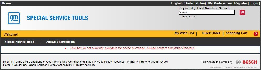

Also, for future reference... the reason I didn't see the price is when you browse the site and search for MDI all of the first two devices say "Call for pricing".
If you click on the EL-52100 GM MDI2 KIT link you "This item is not currently available online".
Then I noticed at the bottom of the search results page is another MDI2 kit with a different part number EL-52100-AM, vs. EL-52100.
I only saw the EL-52100 links. I'm guessing these are either discontinued or non-North America versions of the same thing.
