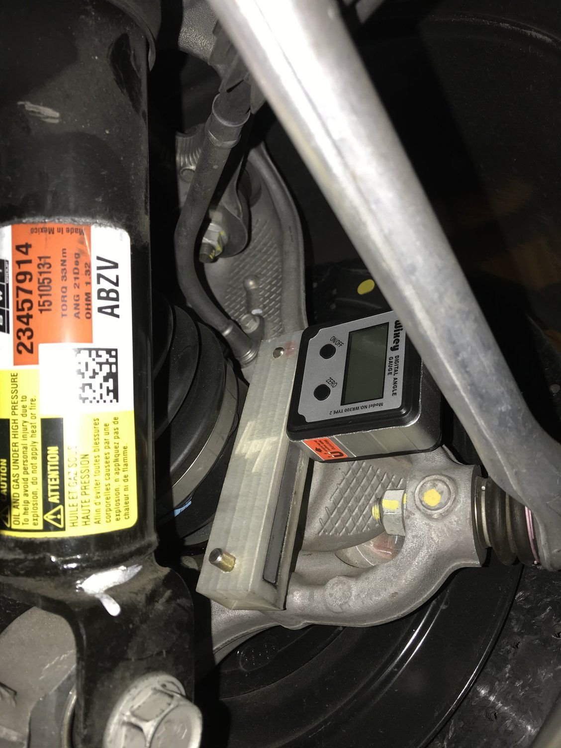

From everything I've read, alignments from the factory can be all over the place and still be within the ridiculously wide tolerances for stock alignments. Especially so with the rear caster. Only the C7 and newer have adjustable rear caster, Earlier Corvettes rear castor was not adjustable
For any alignment work on the C7 corvette, make sure the shop has the specific tools needed to measure and set the rear caster as it can't be measured by any alignment machine. Many will say they can do it, others say they can but don't bother doing it. Best to have them measure and hand write the left and right measurement on the printout they give you.
There's lots of info here and on the internet about C7 alignment specs for both street and track. Don't rely on the stock specs, they are too general

You will need the tools for rear caster adjustment.
