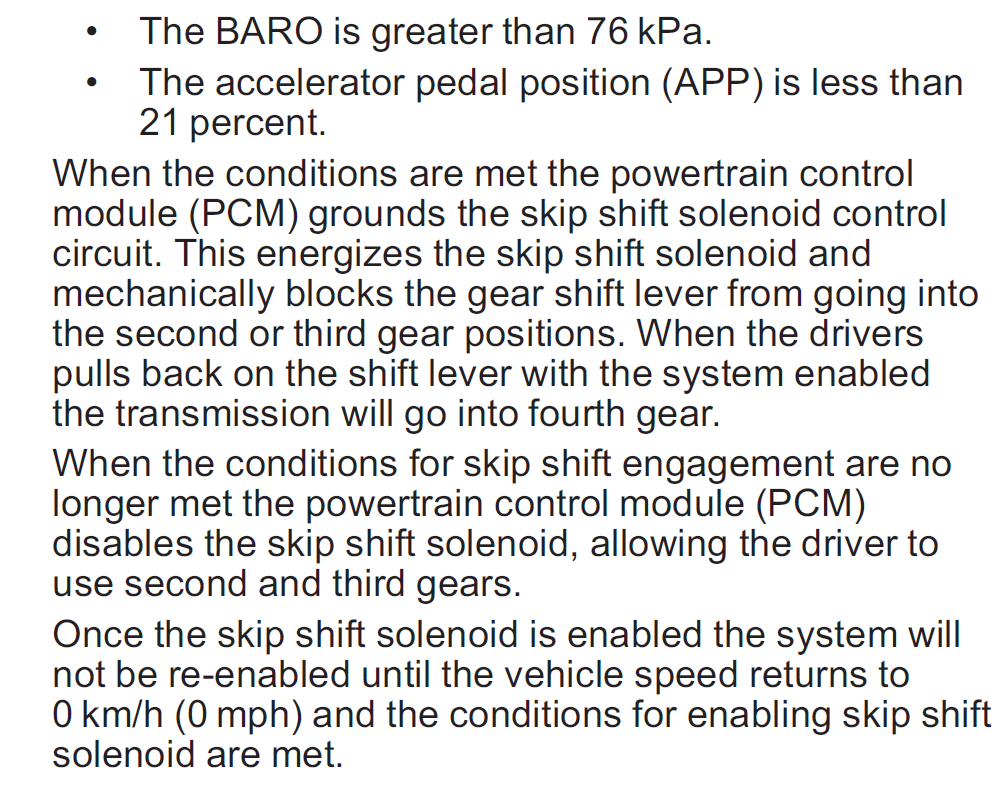

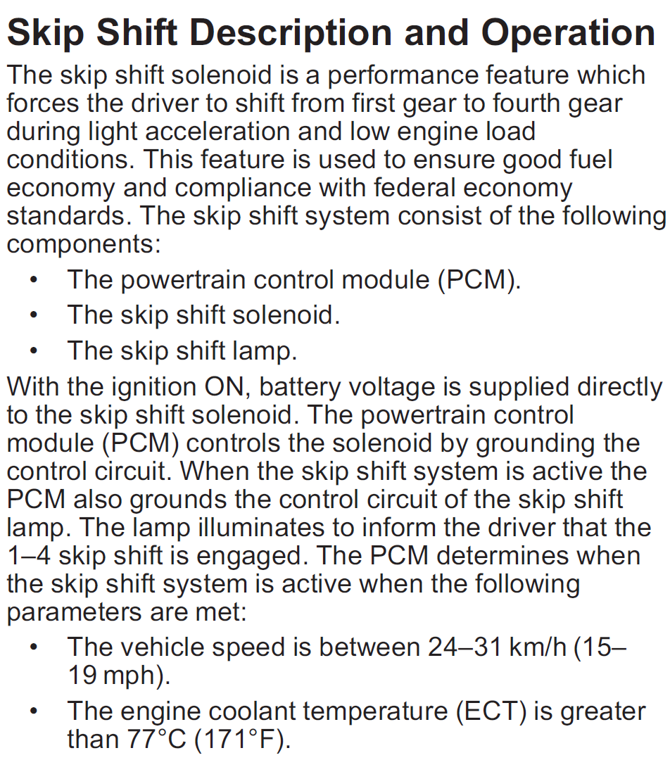

It depends on what type of driving conditions you are in whether CAGS activates or not. The algorithm is roughly based on the following conditions:
For me, it usually occurs when driving in heavy traffic with a slow driver in front of me. You know the type, they accelerate very slowly from a stop, and if I am following them I sometimes absent-mindedly end up trying to shift at 17 or 18 mph and get forced from 2nd gear to 4th.
You can avoid CAGS altogether by training yourself to shift earlier (below 14 mph) or later (above 20 mph). On any Corvette, there is no issue shifting from 1st to 2nd at 10 mph. However, if during an inattentive moment you get caught being forced from 1st to 4th Vs 2nd gear all you have to do is let the shifter enter the gate for 4th and then shove forward slightly into 3rd and then pull back into 2nd. You can do this in less than a second. You don't have to go all the way into 3rd or 4th gears all you have to do is make sure the sensors detect the shifter starting to go into those gears.
What that means is you don't really have to do anything to avoid CAGS since it doesn't happen often and is easily avoided with some self-training. No need to spend $20+ for a CAGs eliminator, no need to tune the ECM, no need to worry about it.
