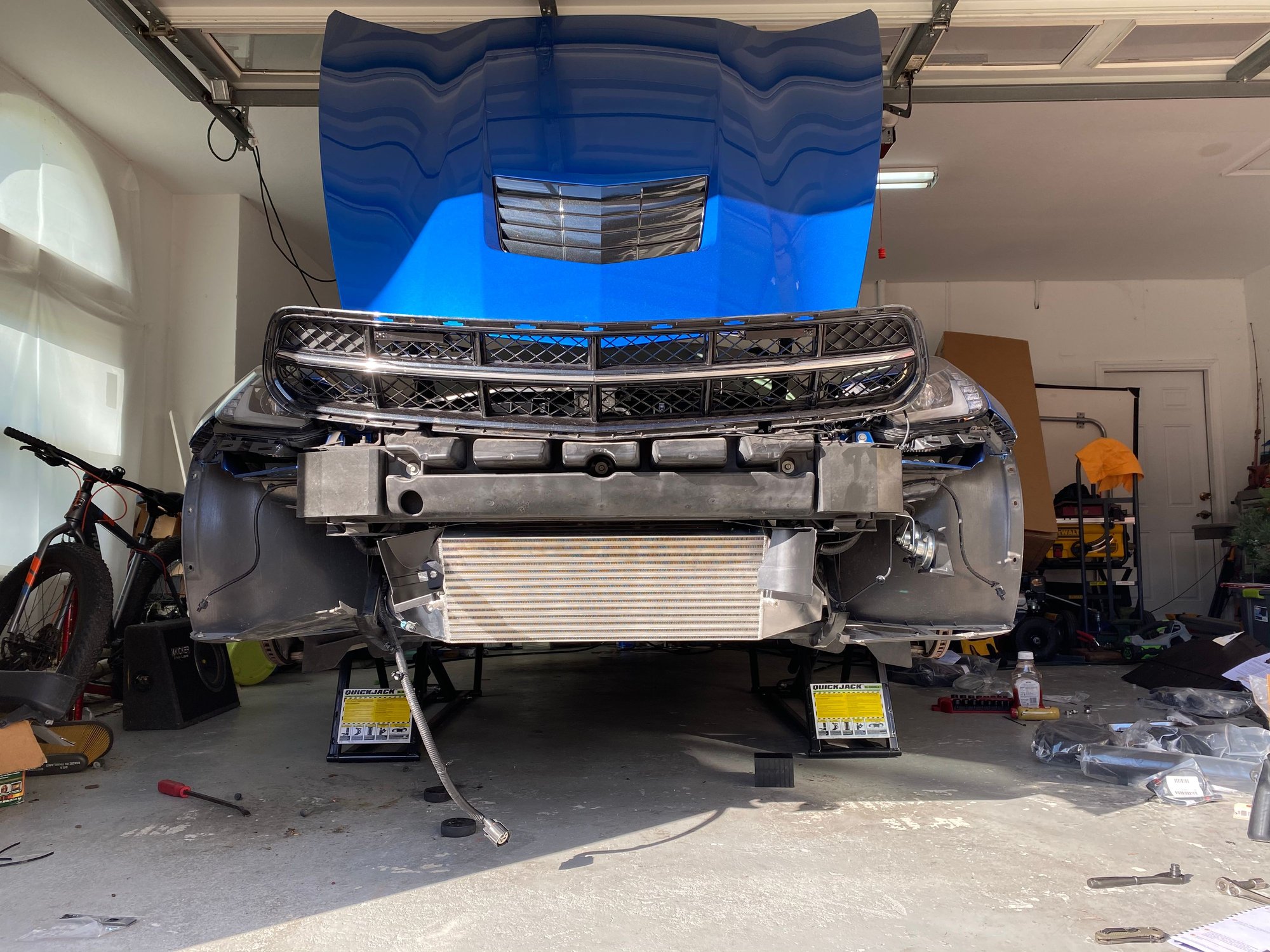

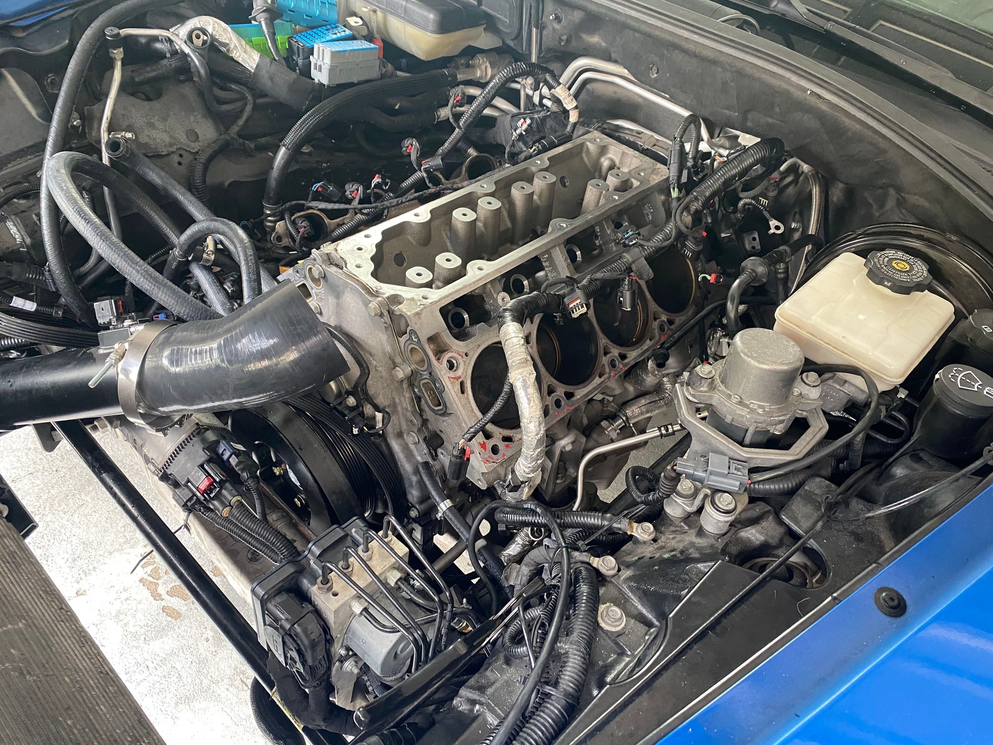

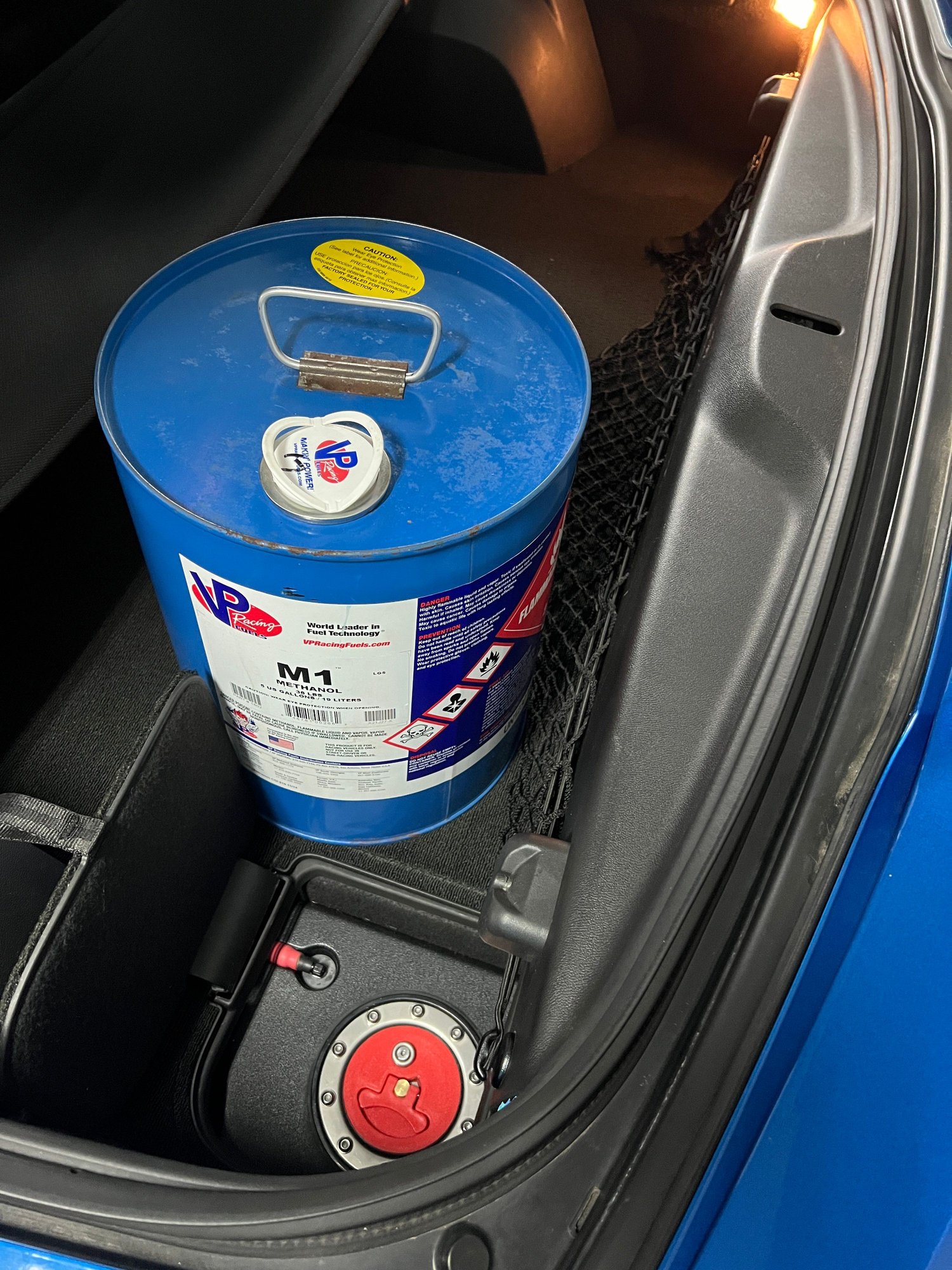

About a year ago I ordered a ProCharger for my 14. I did the install and was fighting fuel issues. I ended up replacing the in tank pump, High pressure pump and injectors to LT4. I changed out the LT1 HPFP probably 6 times with various used and new pumps because we kept seeing a dip in high pressure. I also replaced the valved feed line to the HPFP. It turned out the pulley sent with the blower was smaller than expected. The tuner I used was working with a local shop for dyno time. They even looked over the car and we were all scratching our heads. This car just wouldn't run right. I decided to try a different shop / tuner and one of the first things they said was you need a 3 bar MAP even if its not making much boost. "We have to know what the car is doing" The car was making 4-5 lbs more boost than expected and had an O2 going out. New shop got the car running but recommended slightly larger pulley and meth injection. I ordered those items and took my car home to enjoy until those items came in. Fast forward 2 weeks and I lose a valve spring. luckily the valve only dropped a few mm and didn't collide with rotating assembly. The car then sat for about 9 months. I pulled the engine apart and since I was beefing up the valvetrain I decided to add a cam to the mix. My heads are currently at the machine shop getting cleaned up. I have the cam and all other valvetrain parts. Once the heads are back I'll get her re-assembled then its back to the shop where they are installing the meth kit. The car has an Alky kit with dual 15 nozzles and a rear stealth mounted pro meth fuel cell ,since I like using my wiper fluid. Really excited to hear the car after the new cam. I REALLY can't wait to cruise it around again.

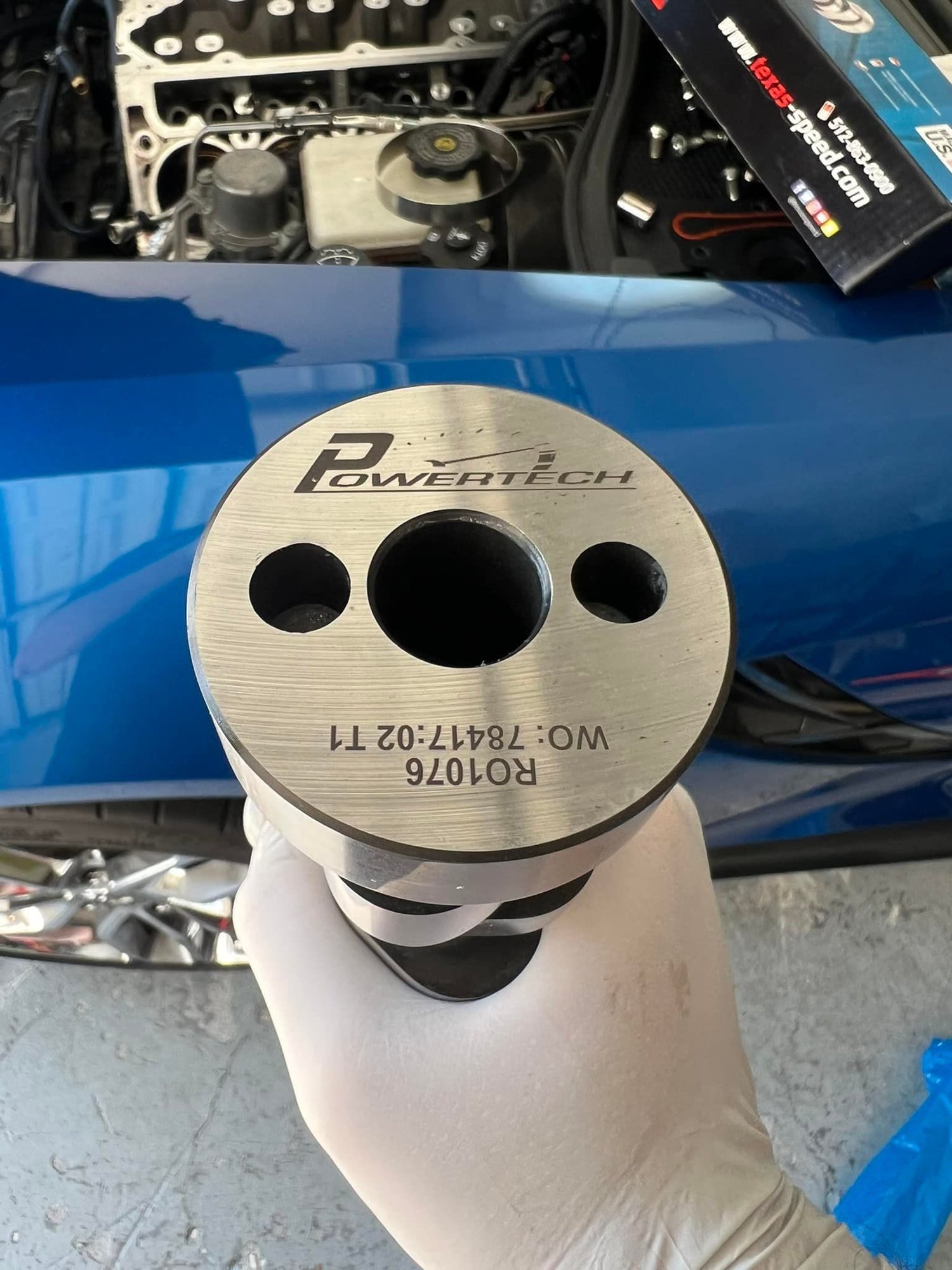

The car made 625 at a little over 10lbs with 11 degrees of timing. Tuner said once we can cool the cylinders with meth we can sprinkle in some more timing.
Cam specs:
Duration @ .050 227/235
Lobe Lift: .353/.353
Valve lift @ 1.8 .635/.635
LSA 114
Center line 110
32% fuel lobe

Over the weekend I swapped in my new cam, dropped in the new lifters / trays, and cleaned the surface of the block in prep for some new gaskets. There's a lot of work to be done still, but it doesn't feel like it. I know once I have to fight the steering rack I'll feel differently LOL.

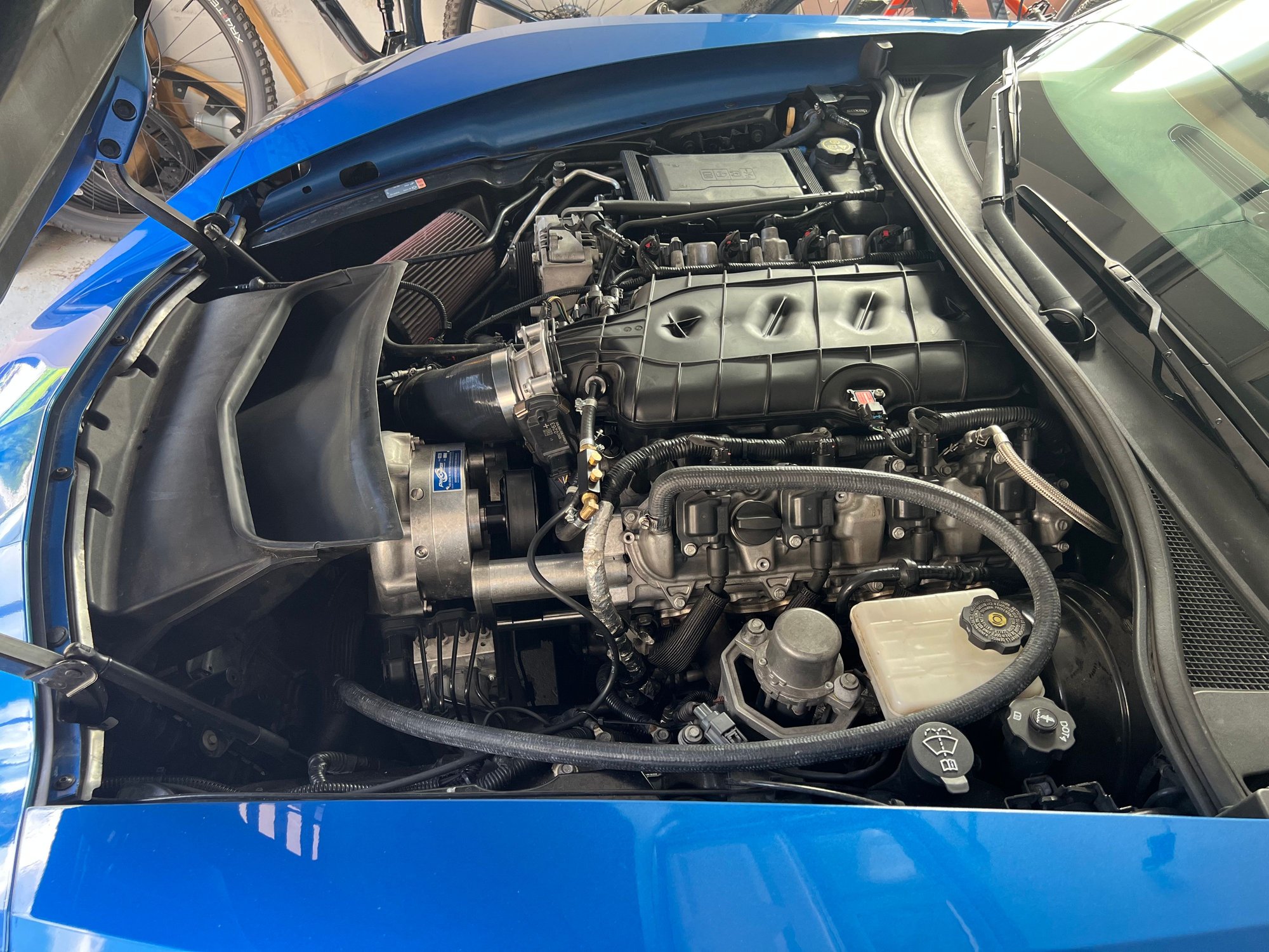

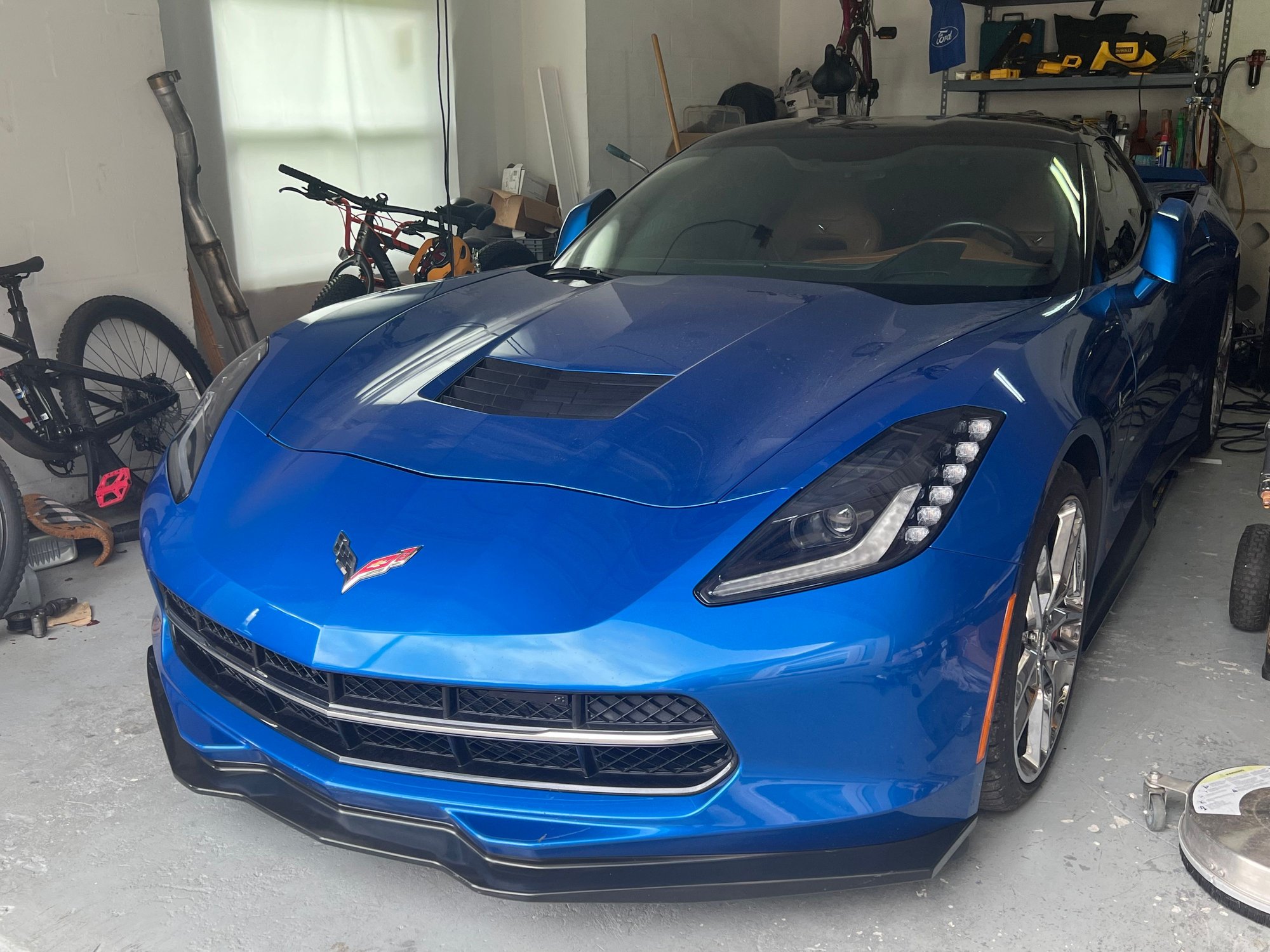

The car is back together!!!! It has a street tune for the cam to break in the new parts. Unfortunately the diff is starting to go out. Ordered a new diff and clutch since the car is making more power.
walk around.
just idling
