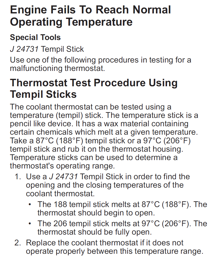

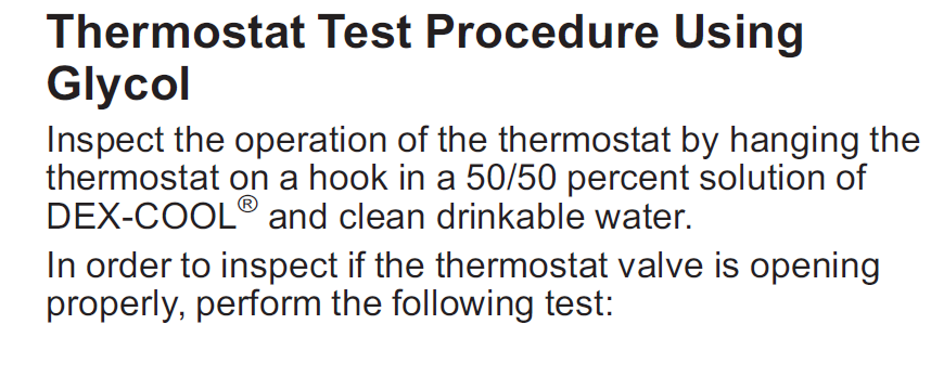

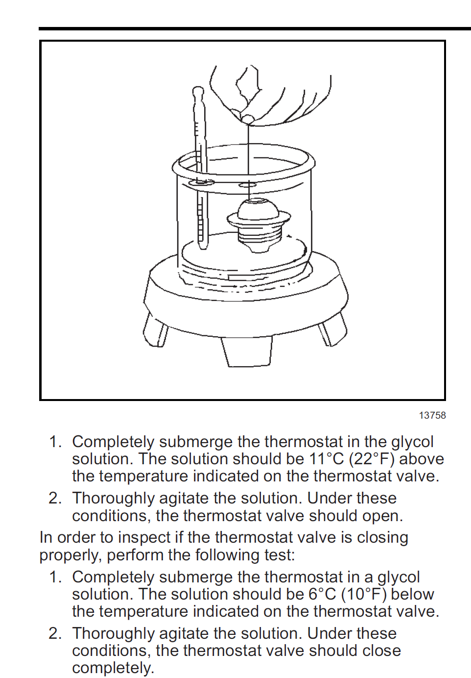

Did you replace the thermostat or not? The stock thermostat is 187 degrees F / 87 deg C. When you checked the codes was that before or after you reset the ECM by removing the battery ground cable?

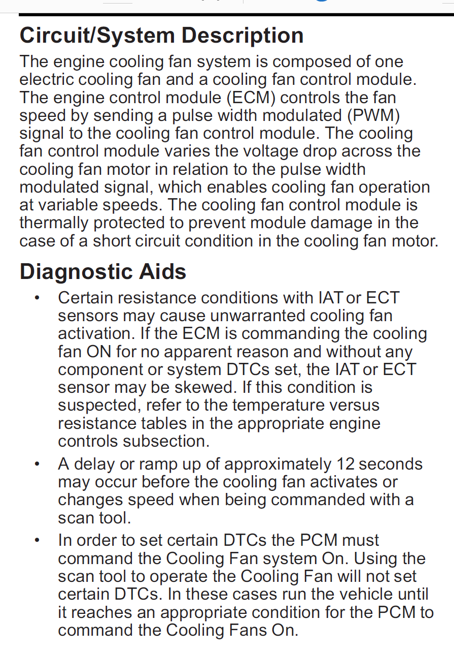

From the Factory Service Manual here are some things that might help:
Checking IAT issues is more involved and covers a lot of pages in the FSM. Since the issue seems to be intermittent I would check the wiring and connectors going to the IAT 1 and 2 sensors to make sure it isn't damaged or the connectors corroded or otherwise making poor contact.
Bill

Per the factory service manual the stock thermostat opening temperature is 187 degrees F (see my post above). Before purchasing more thermostats test the ones you have using one of the methods I mentioned in my post. Coolant temp can go above 297 degrees (the point where the thermostat is completely open), thermostats only set a floor for the coolant temp which can vary depending on how you are using the engine and when the ECM turns on the engine cooling fan. Engine cooling fans are turned off at speeds above 35 mph since they would restrict air flow Vs enhance it. Driving on the highway at cruise control steady speed or 70 mph I will see coolant temp running between 188 degrees and 190 degrees and oil temps running from 188 to 192 degrees depending on engine load.
However, on track with the engine being used at max load or near max load coolant temps run just below 220 degrees and oil temps run in the 260s. These are all temps that are considered to be normal.
