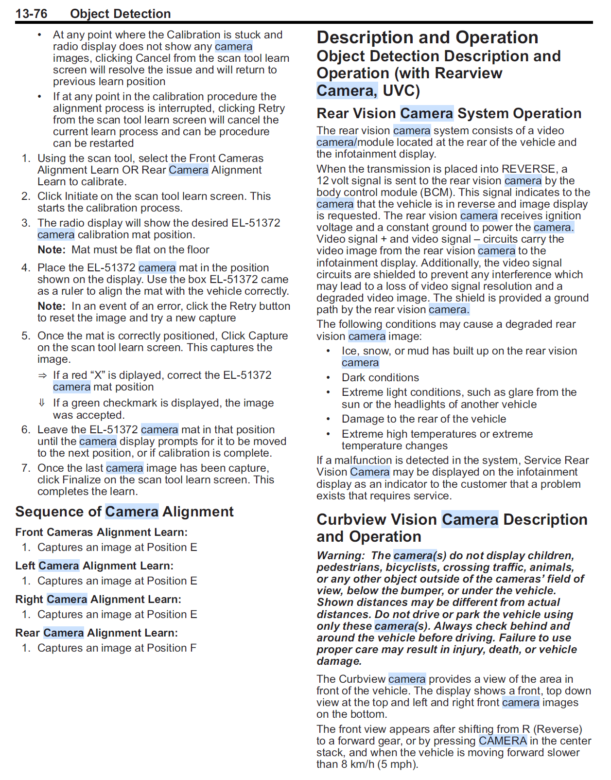

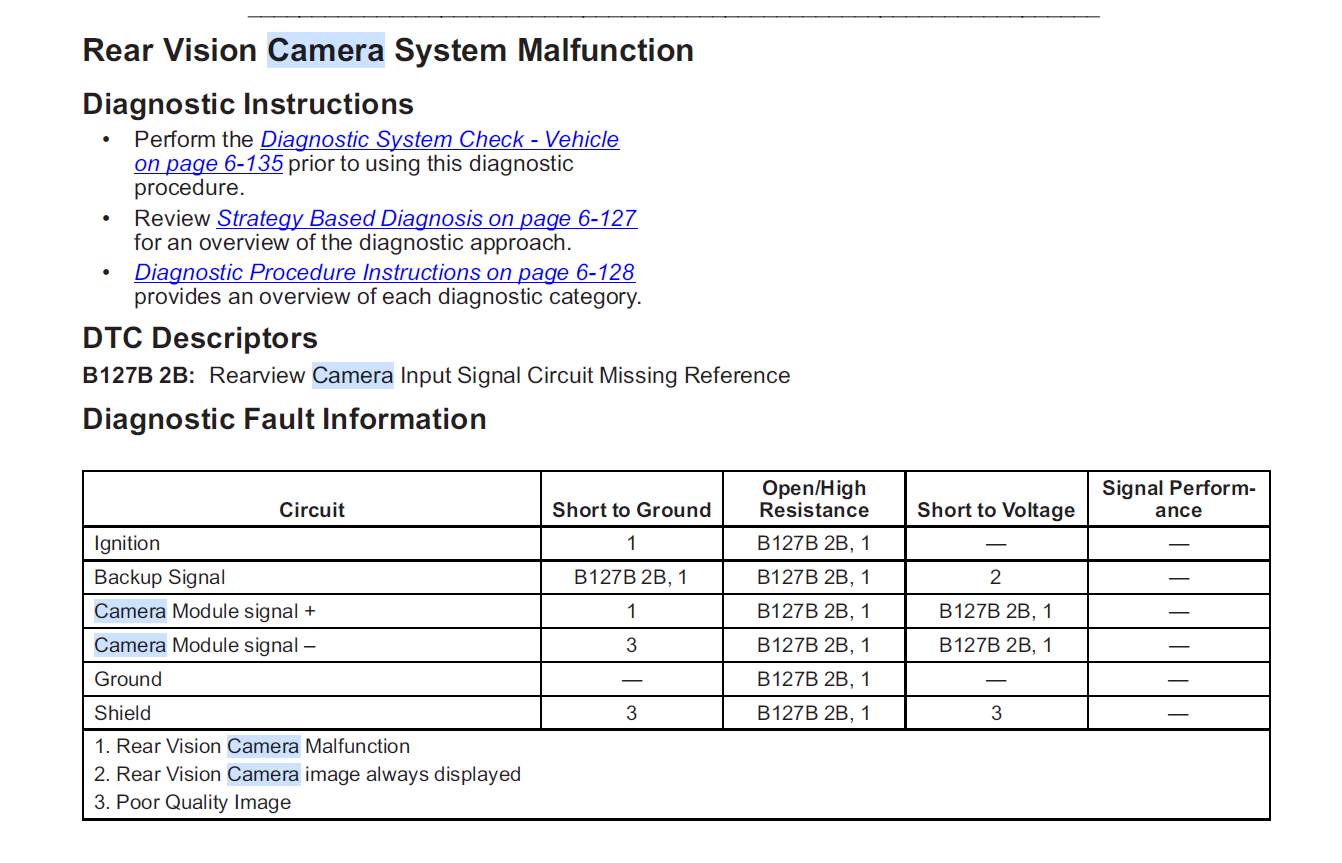

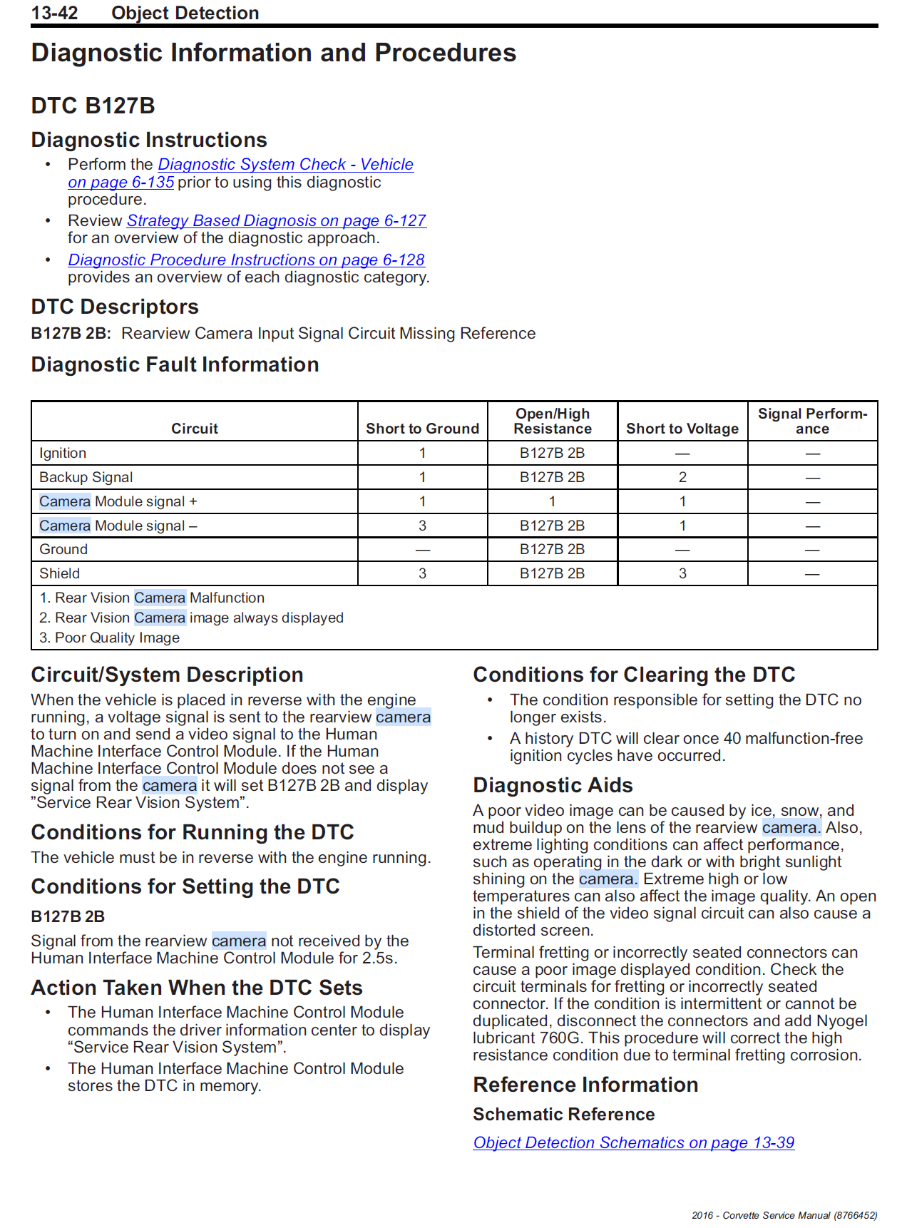

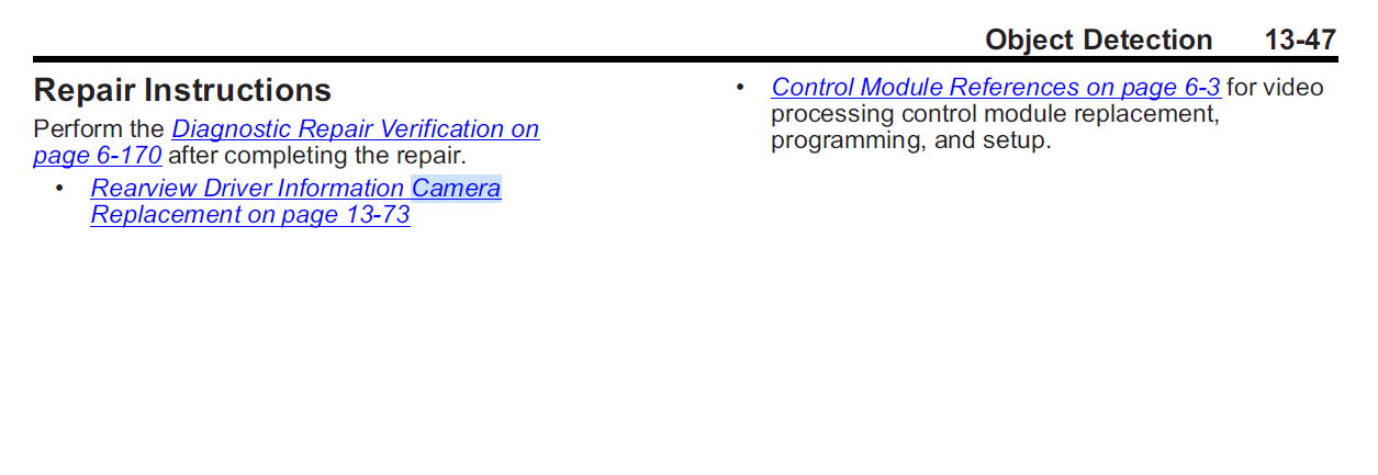

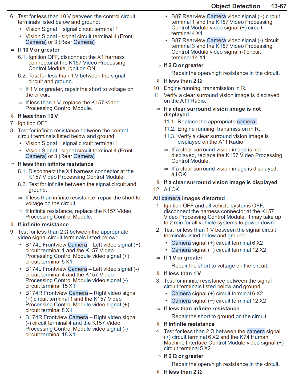

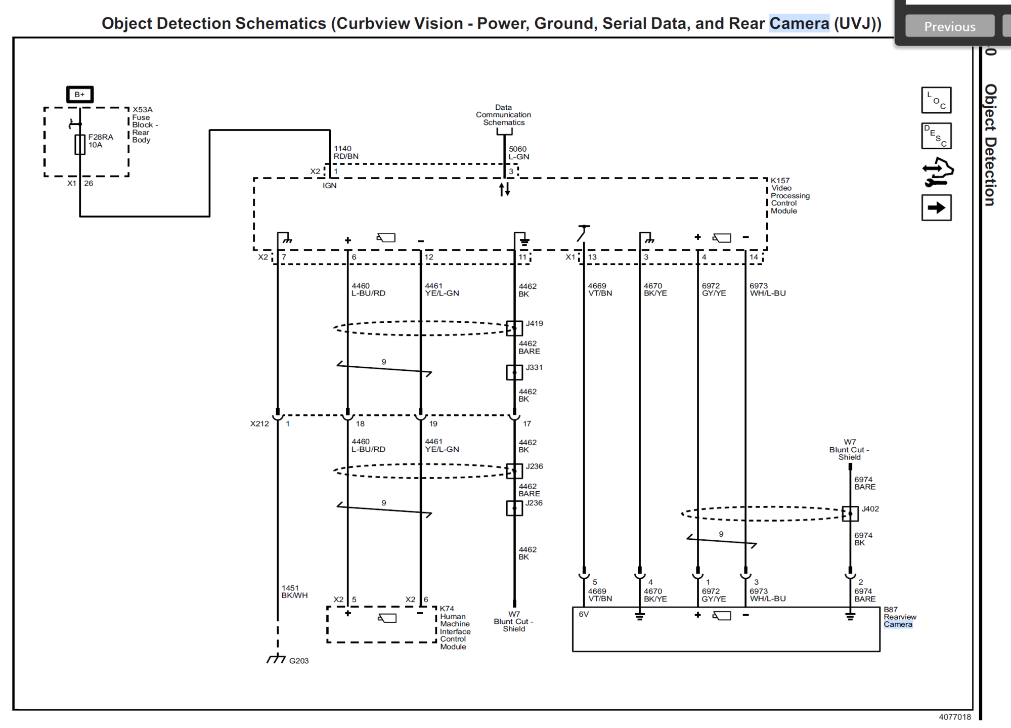

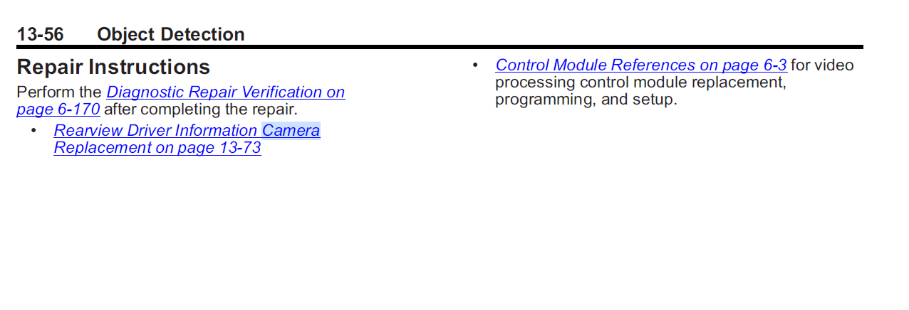

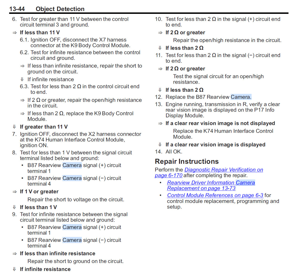

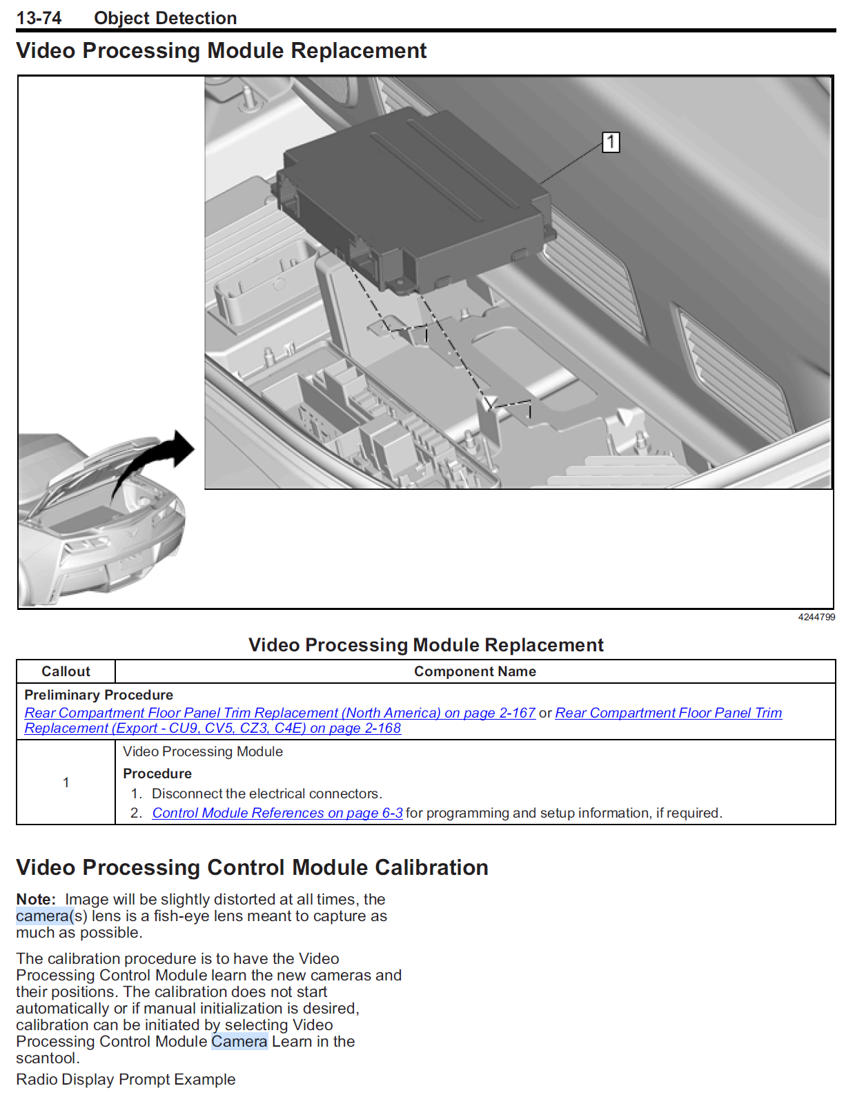

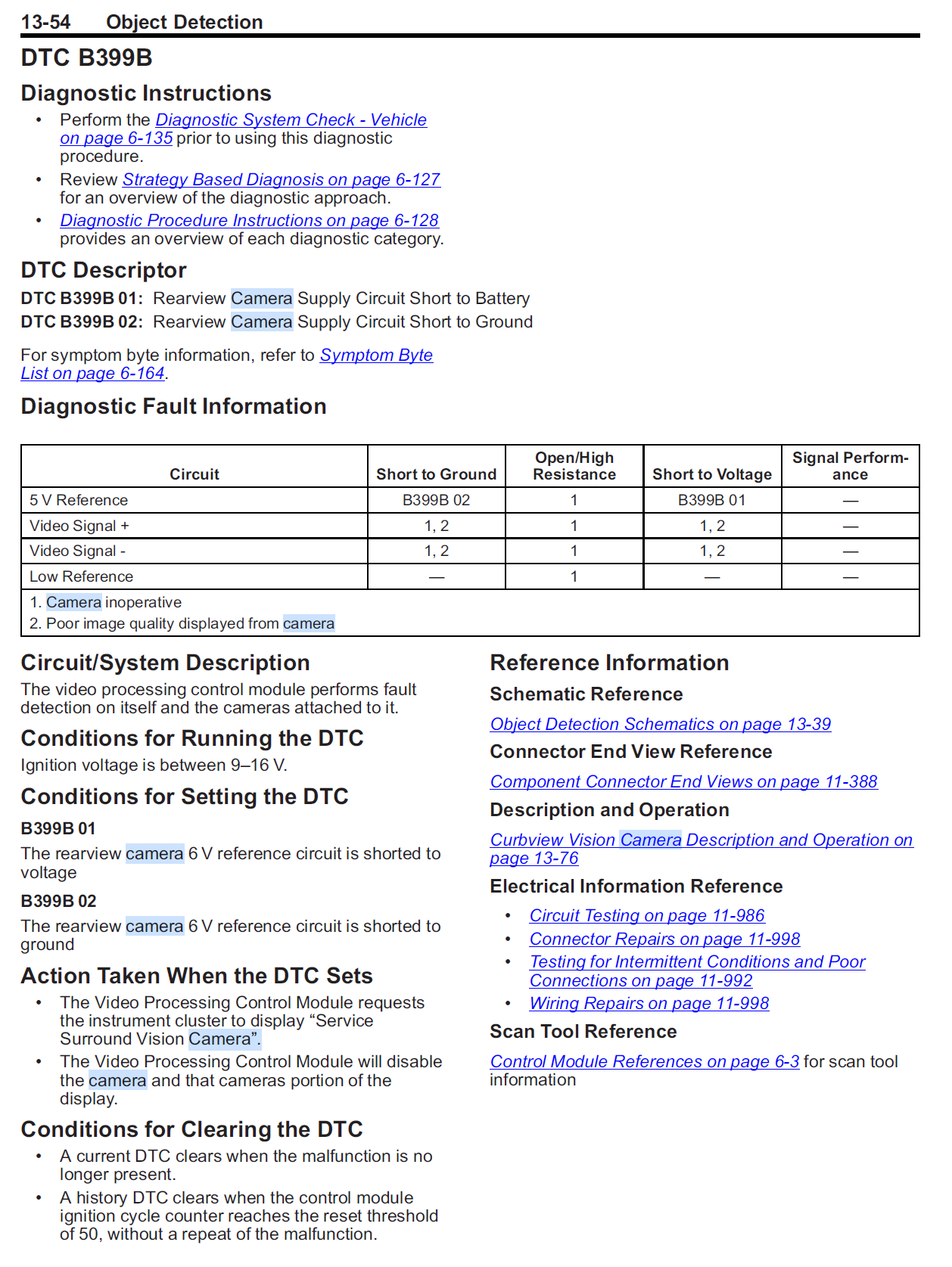

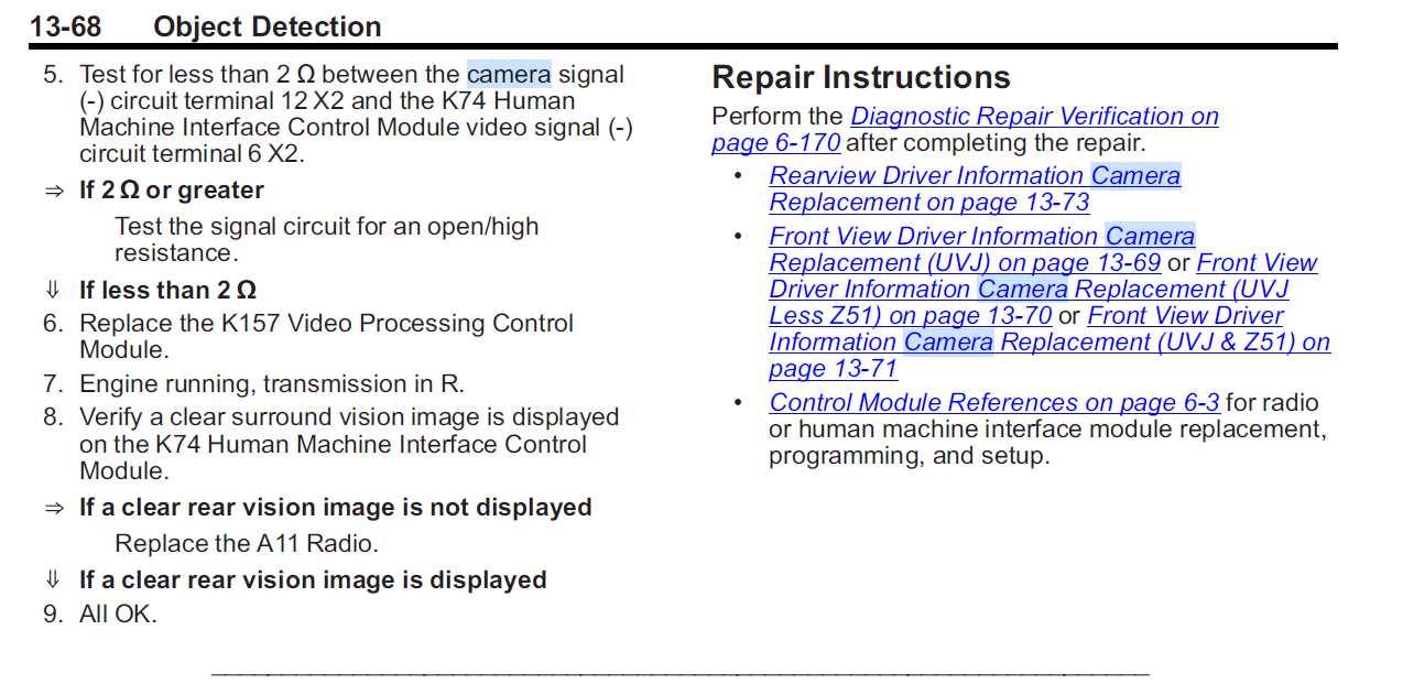

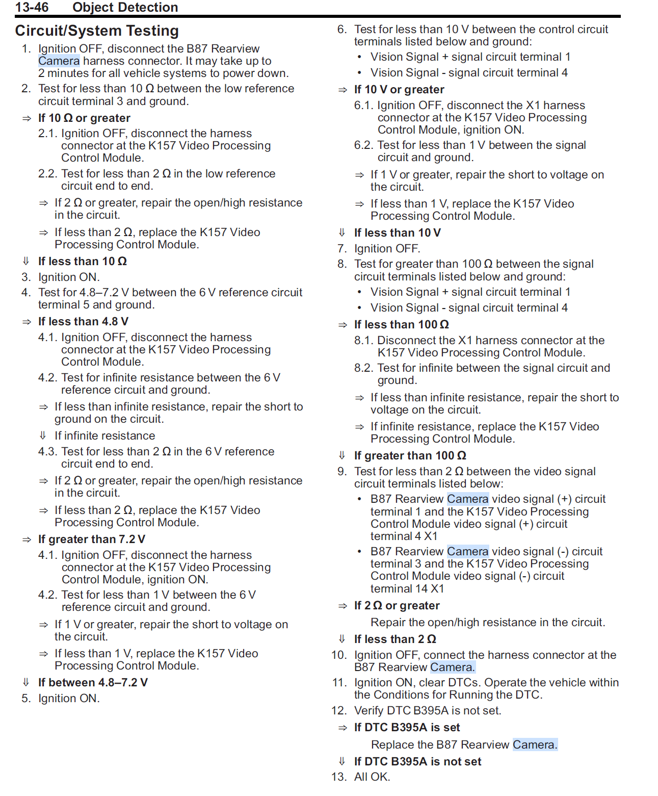

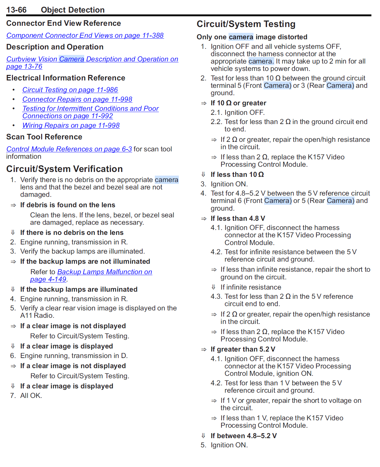

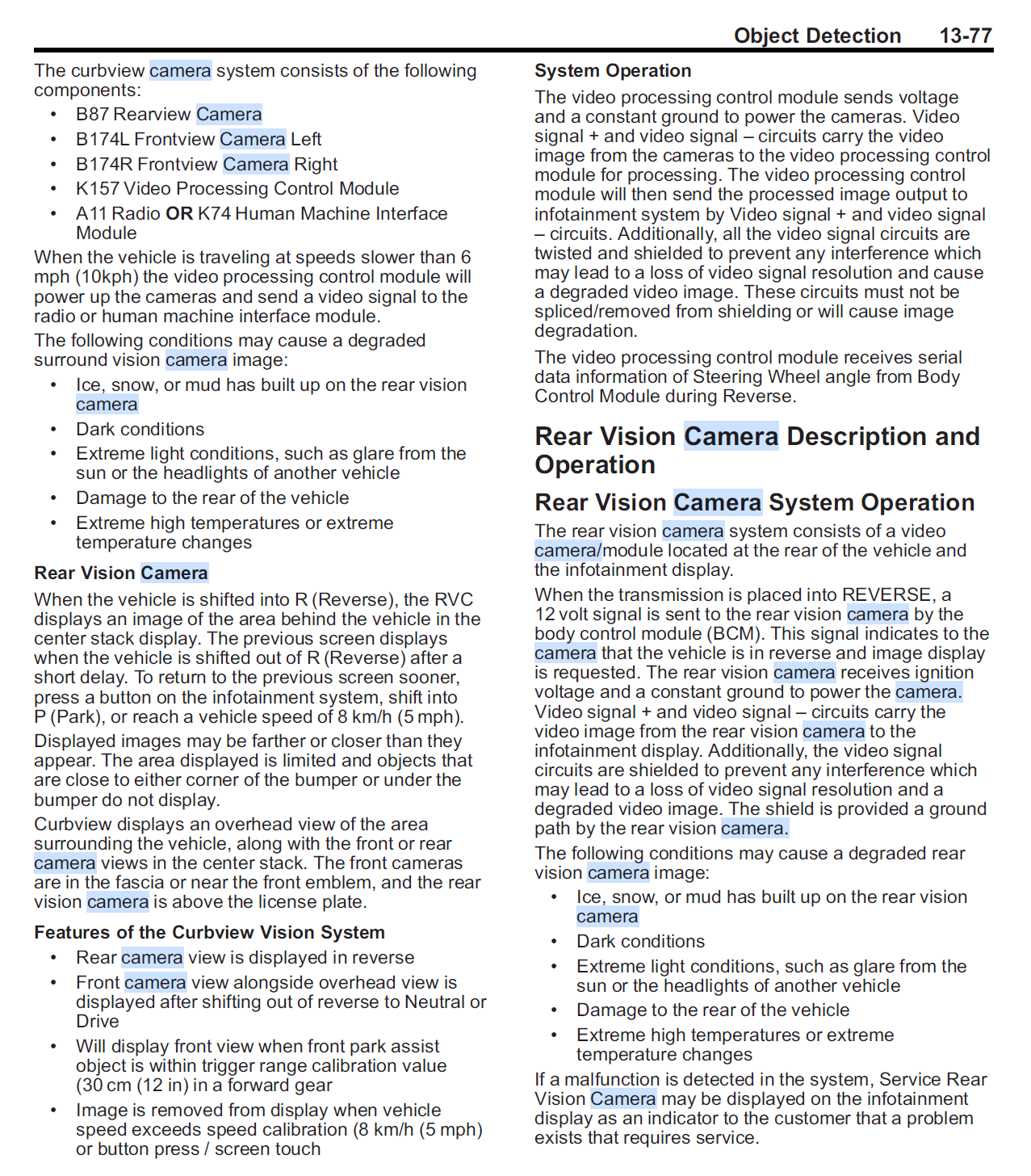

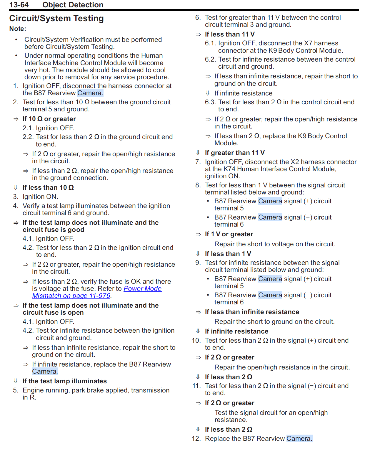

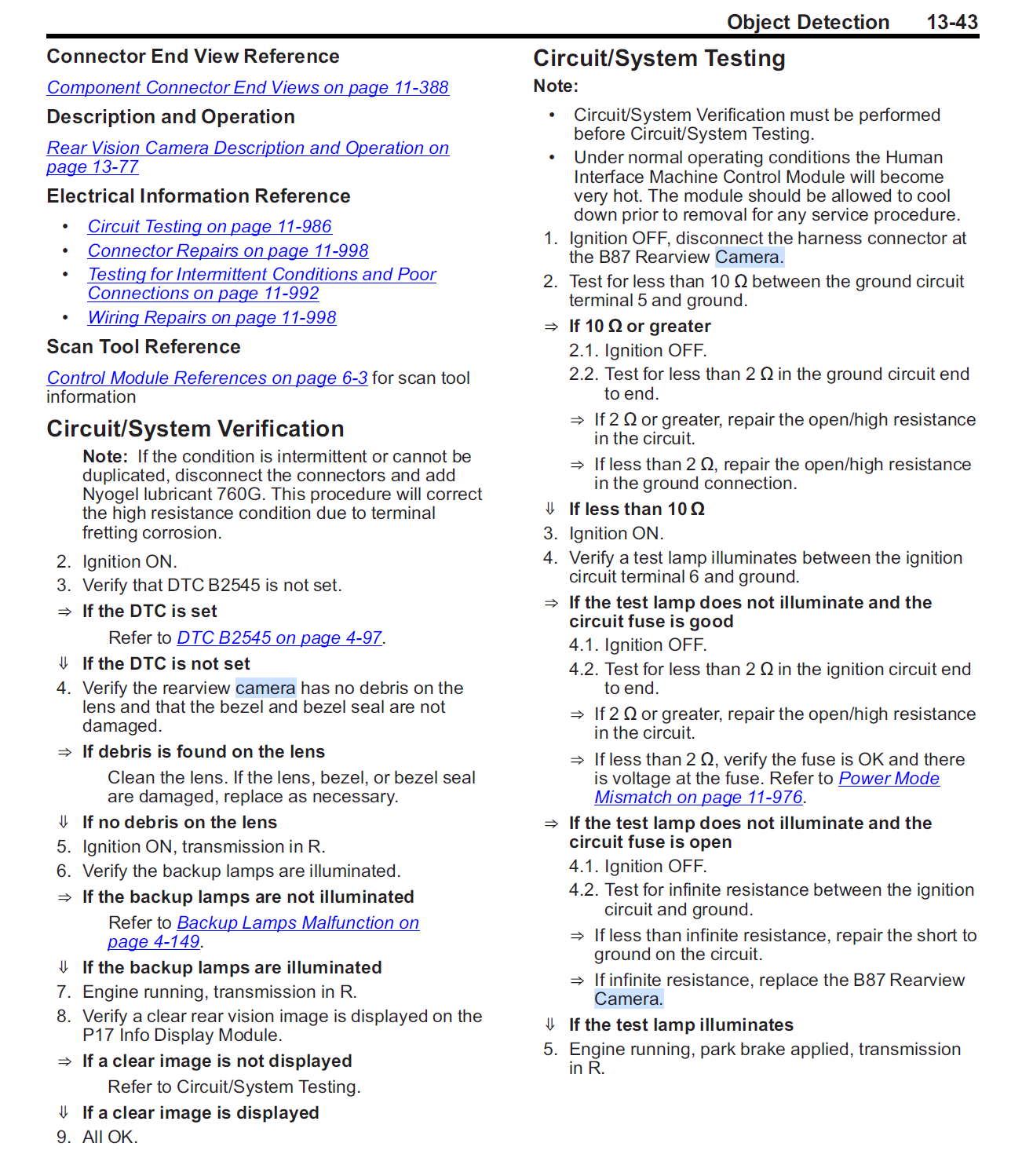

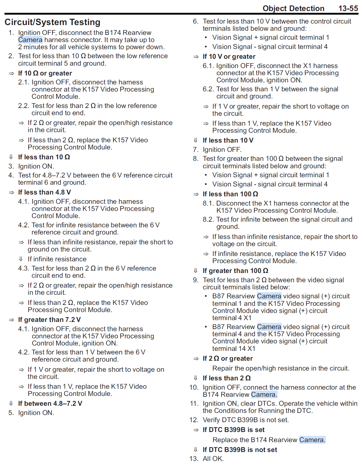

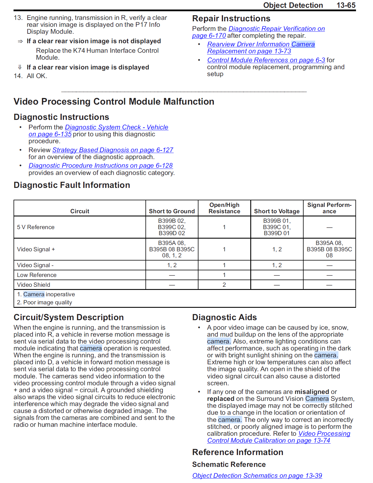

I doubt tuning the car had anything to do with the camera. Tuning changes some tables in the ECM. The camera works through the BCM, HMI and Video Processing Modules and starts working when it gets a +12 V signal from the transmission when it is placed in Reverse.
Here are some pictures of the related FSM pages:
It sounds like a cable may not be hooked up. Check your back up lights to see if they work.
Bill

2015 doesn't have a video processing module. That was introduced on 2016, and only then on cars that had the UVJ front cameras.
