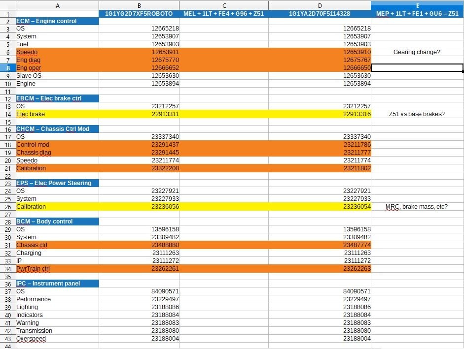

Threw this together over lunch today. I pulled the calibrations for Lobster's car, and a similar 2015 1LT base I pulled off AutoTrader. I was mistaken about part of this. I thought the Z51s without MRC didn't get the eLSD. eLSD is standard on Z51. It's only PTM that's bundled with MRC. The base cars also have different transmission and diff ratios, so some of this stuff may be related to that rather than the rear diff type. Same with the different brakes, and dry sump vs wet sump.
I wouldn't recommend swapping or cross-programming modules unless you have someone you really trust who can work on this stuff. This is all for informational purposes only. It's just a semi-educated guess from a hobbyist, and trying to implement any of this could leave you with a bricked car or worse.
I didn't check every module in the car, or highlight all the calibrations. I really doubt the door modules for instance have anything to do with this. Same with the window calibrations in the BCM. I just ignored all of that.
I'm pretty sure you'd need to change all of the orange calibrations. The ECM you could probably do with HP Tuners and someone who really knows the E92 ECM inside and out. You might be able to just swap the chassis control module with one from a base model. It would be missing the 2nd plug, so you'd need to jumper the chassis expansion GMLAN wires in that plug to avoid interrupting the bus. You might be able to program a Z51 CHCM with the base calibrations...or you might brick it. I have no idea.
The body control module would be the tough one. That controls the keys and the security system. DO NOT screw around with the BCM. It does not have a sense of humor. I don't even know for sure if it would need to be programmed. I would guess it does though. The BCM seems to send out the messages to the rest of the car that tells the other modules what features it's equipped with. If it sends out a signal that says it's supposed to have eLSD, then that could cause a bunch of errors on the cluster and elsewhere.
Speaking of the cluster, I was really surprised it didn't have any changes. But if it's just passively listening for fault messages from other modules, then that would make sense.
To replace eLSD with mechanical?
