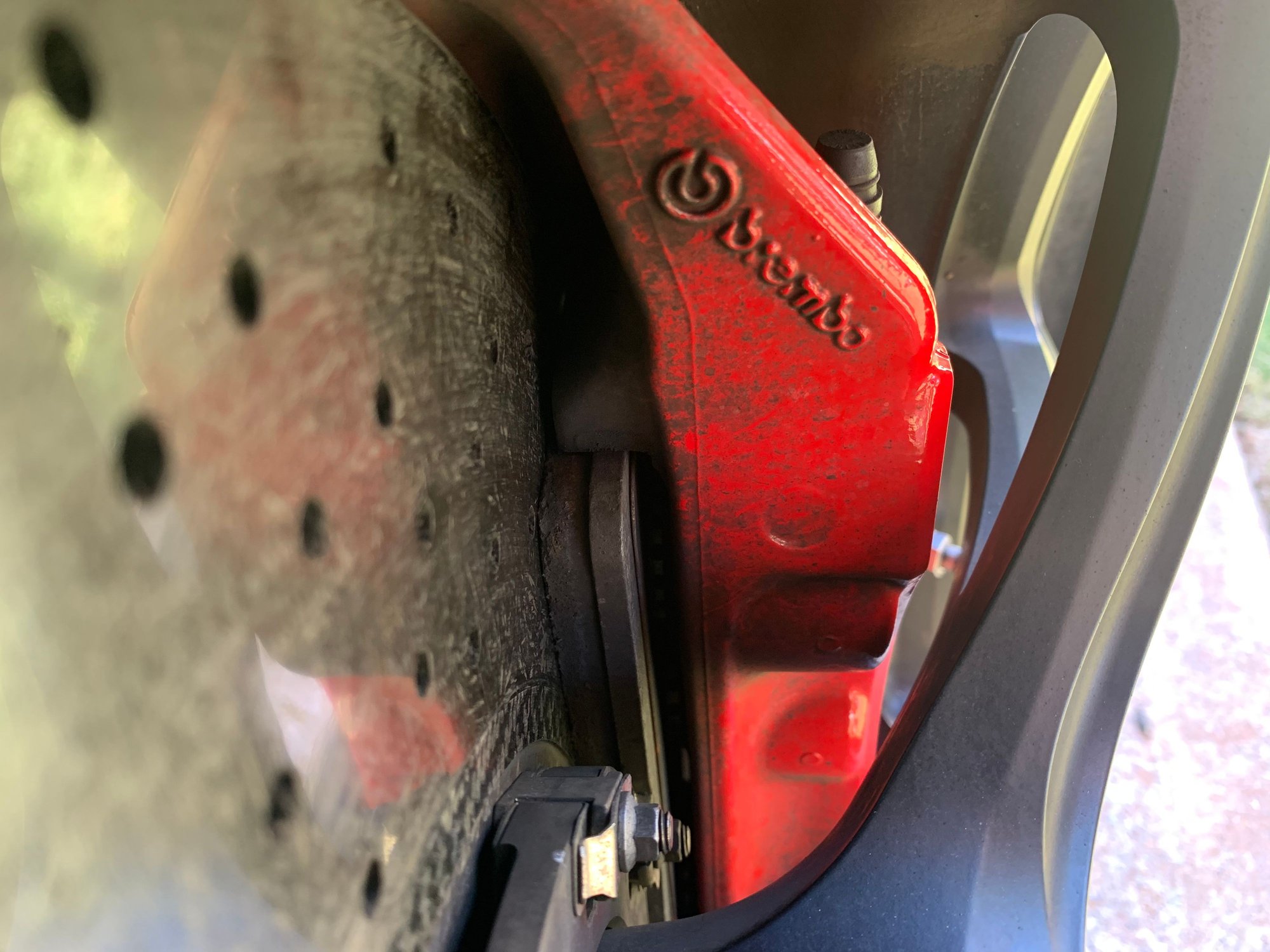

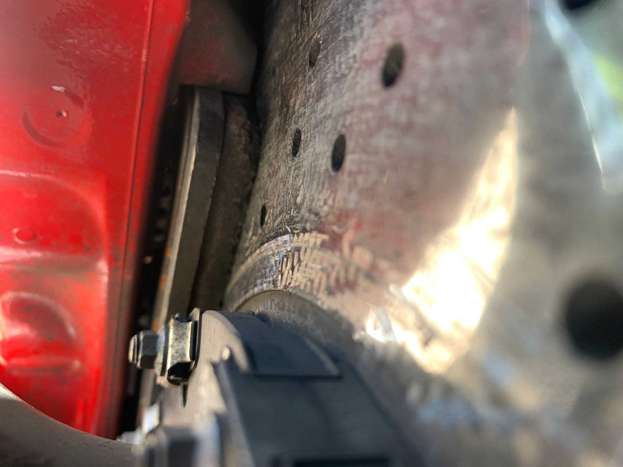

Ive been getting the intermittent Warn Brakes light, like a lot of other people. It’s a 2018 Z07 with 12,500 miles on it. The more i read, the more i think it may be just one of the sensors. It hasn’t been tracked as far as i know.
These are my front pads. They have a little life left, but it doesn’t hurt my feelings to replace them.

those pads look well worn. it seems likely the sensors are wearing as well.

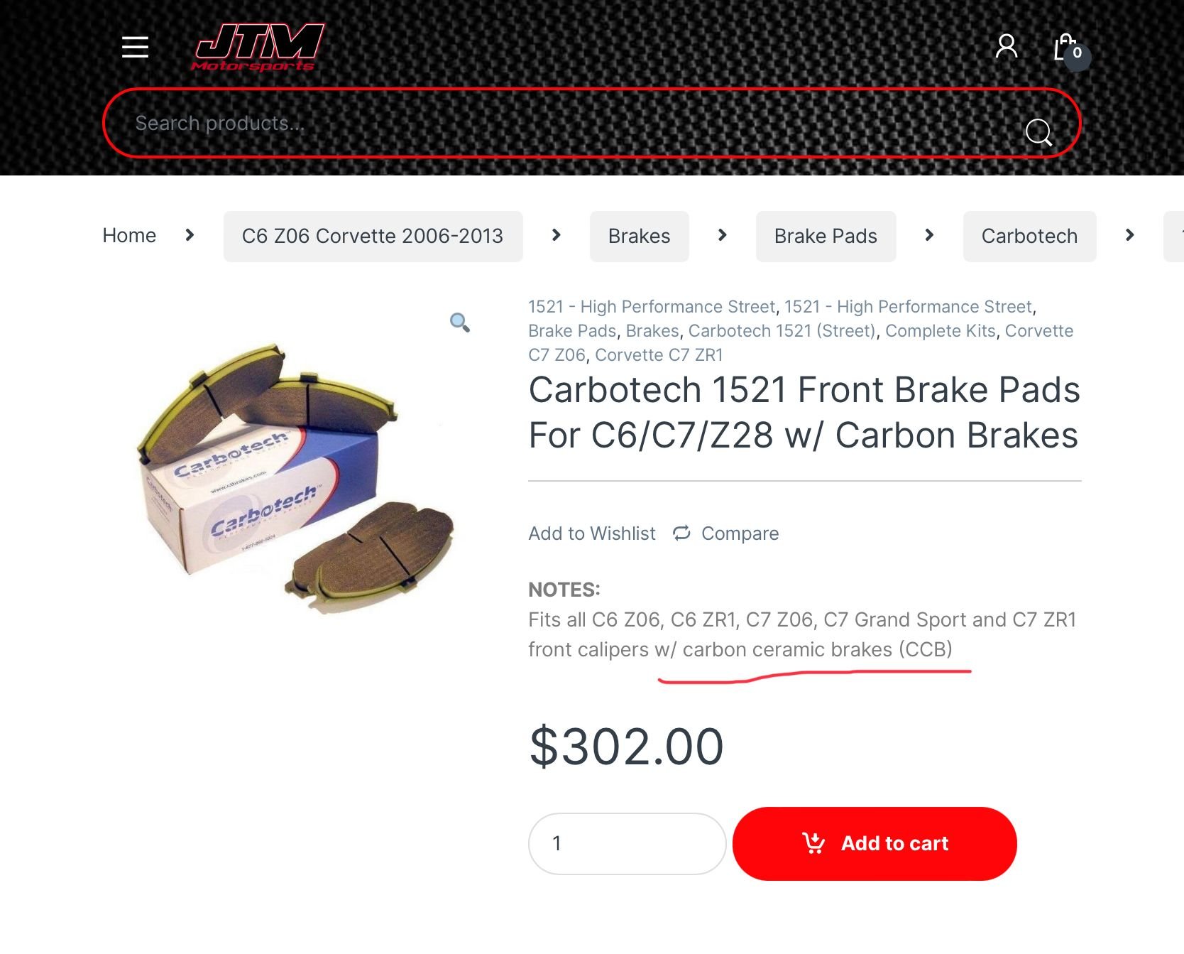

I’ve seen the brake pads advertised like this in a couple of different places. So based on this, i think the 1521s should be good. If anyone knows for sure, I’d appreciate it.
CarboTech 1521 ad for C7 Z06 with CCBs.

Yes, the 1521 is fine to use with the CCB.

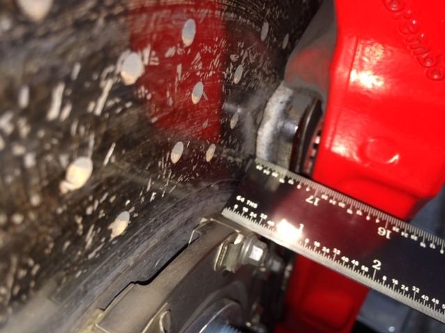

You need to pull the wheels and inspect the inside pads. The wear sensors are on the inside pads. The sensors will start to wear down as the pad thickness approaches 2/32 inch. If properly fitted to the pad the sensor should break when the pad reaches 2/32 (that is the thickness that state inspection programs require replacement of the pads).
When I look at your pads it seems like the brake pad compound isn't close to 2/32 (1/16) thickness. When brand new the pads are only 15 to 16 mm thick including the backing plate. However, a lot of times the inside pads wear faster. You need to check all 4 wheels to see which one is tripping your brake wear warning message. The sensor is basically a wire that is encapsulated in some sort of phenolic material. As the pad wears the material comes into contact with the rotor and it wears down to the point the rotor breaks the wire inside the sensor which sets off the message. The warning system is a serial circuit that passes through the sensor at each wheel so there is no way to tell which pad has the broken sensor.
The fact the message is intermittent makes me think the problem may be in the connector at the far end of the sensor harness. That connector plugs into a matching connector that is tied down tightly to the cradle. There are 4 connectors on the cradles 2 in front and 2 in the rear. One connector for each wheel. Any one of them could have an issue with a poor connection that triggers your warning message.
Check all of these things before replacing the pads. You may be able to avoid spending money on new pads.
The Disc Brake Pad Wear Sensor Part Number is: - GM (84649599) It is priced at $43.62 at CultragFactoryParts a forum sponsor. Rock Auto has them from various vendors including GM with the price varying between $25 and $37.
Update: From what I was able to look up on the internet the friction material thickness on a brand new OEM pad is .405 inches. That is a shade less than 10.3 mm thick. You can use a straight edge to measure the outside pad thickness just by removing the wheel. See the picture for an example:
It is hard to say from your picture but it looks like your pads have at least a quarter-inch thickness left and it is easily seen the CCM brake burnishment procedure called for in the Owner's Manual has never been done since the pad color is black. When the brakes are burnished using the OM procedure the pads look gray on the edges as shown in the picture.

Thanks @Bill Dearborn. That was super helpful. I did pull all four corners today and there was tons of pad left. You were right with your assumption. Next I’m going to replace the front wear sensors. Im thinking this will be the culprit, especially based on all of the other threads regarding this issue. It’s a 2018, so I’m not sure what the dealer would say. Maybe they would replace them, maybe they would charge me… i don’t know. Thanks everyone. This has been helpful.

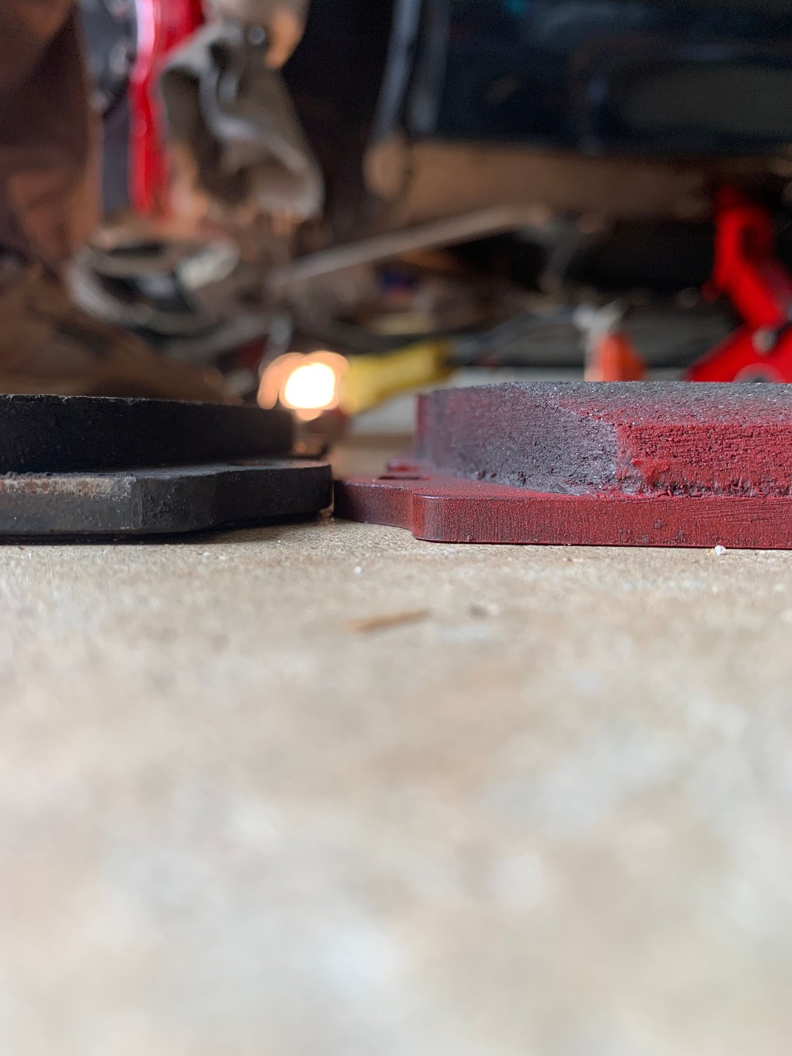

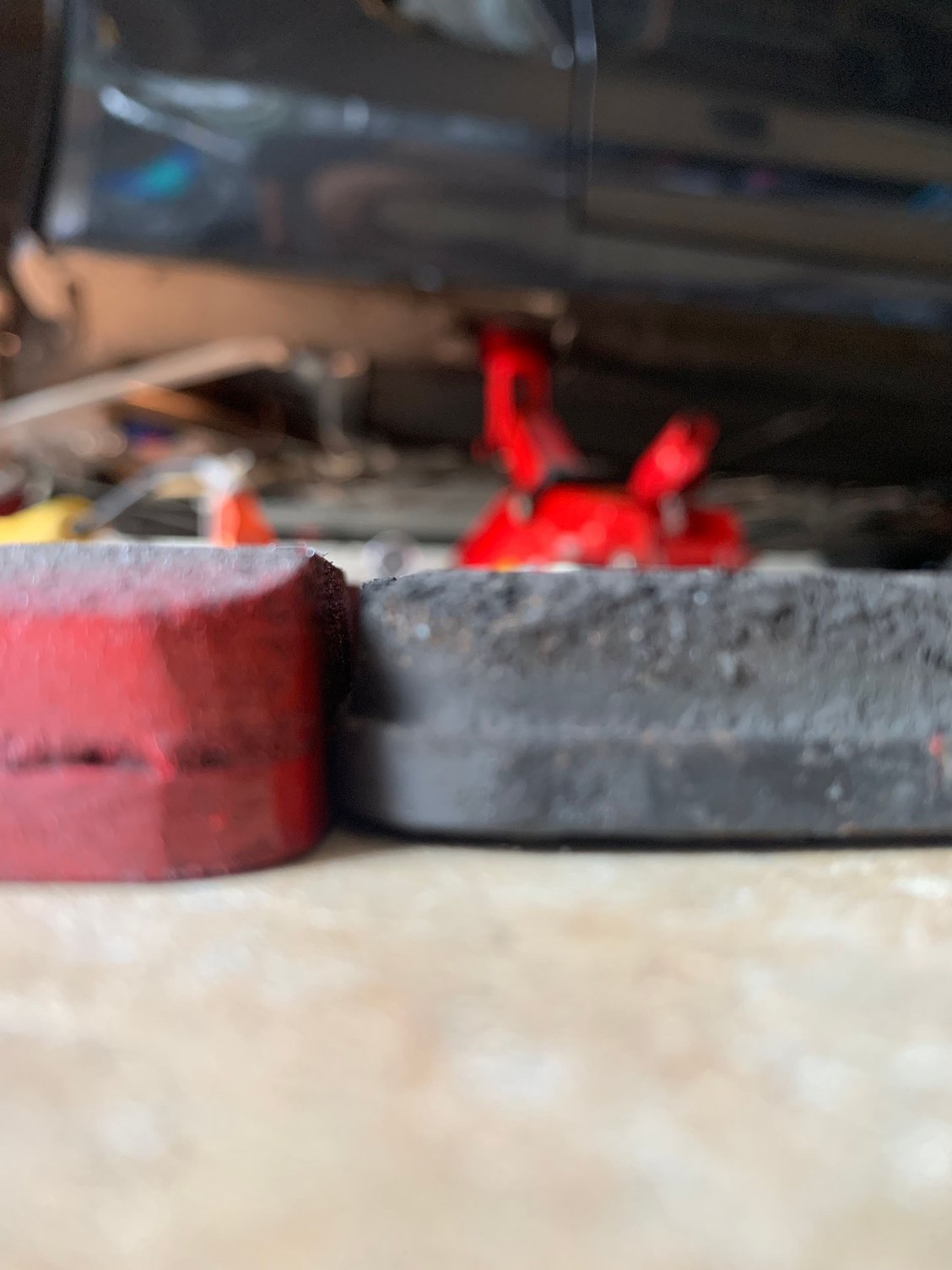

So here is an interesting update. I was getting the intermittent Warn Brakes message and decided to pull all 8 pads and check out the damage. This is a 2018 Z06/Z07 with 12,500 miles and CCBs. As you can tell by the pictures, there is plenty of pad when compared to the brand new pads. Definitely a sensor issue. All of the pads looked about the same, like the picture below.
Left: New Pad / Right: Original Pad
Left: Original Pad / Right: New Pad
I found the same thing on my 19 ZR1 43K miles. Had it on Daytona for an afternoon, but all else has been drag racing or daily driving, no other tracks.
I just put the new pads back in the box and I have for when I actually need them.
