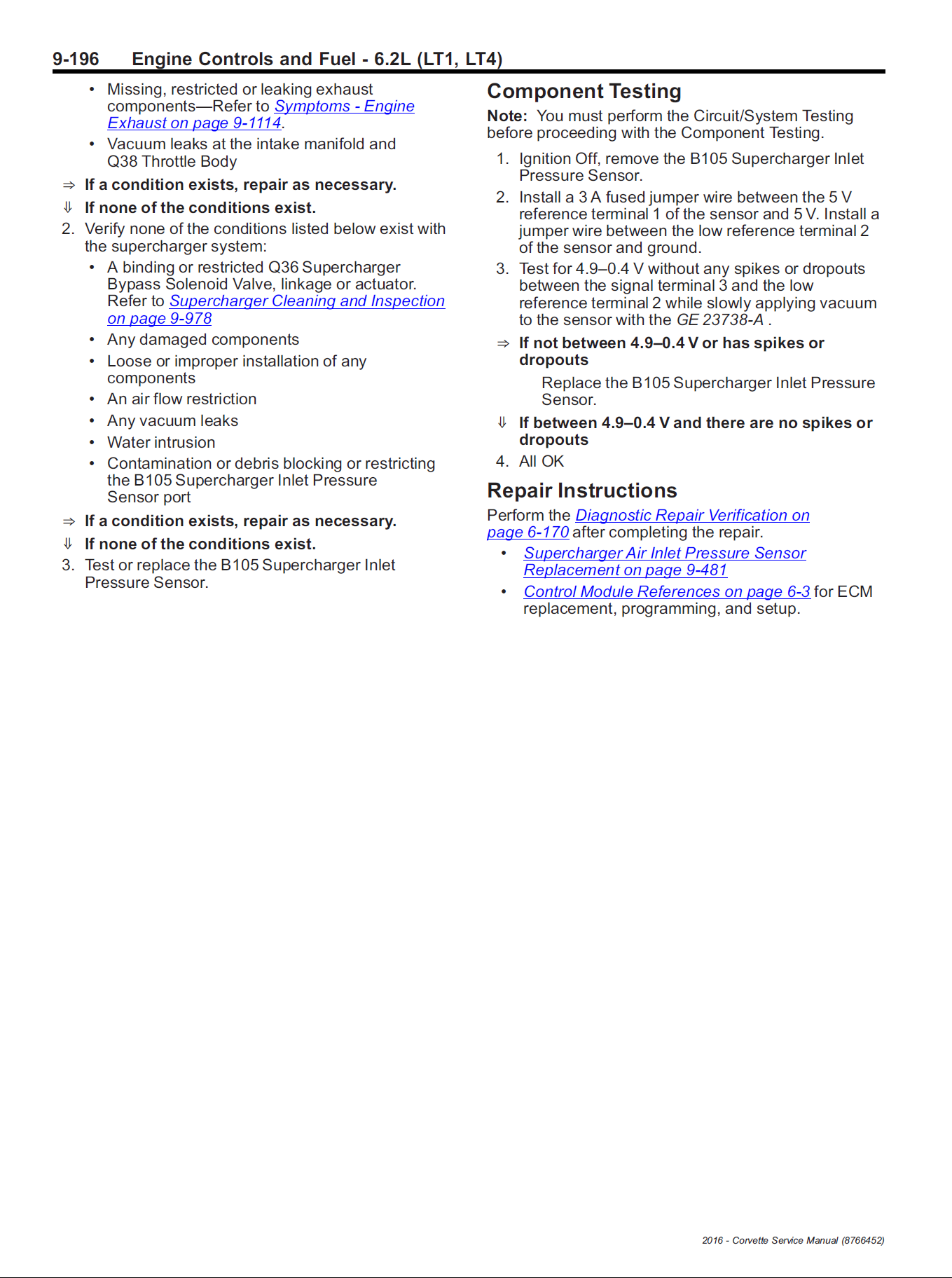

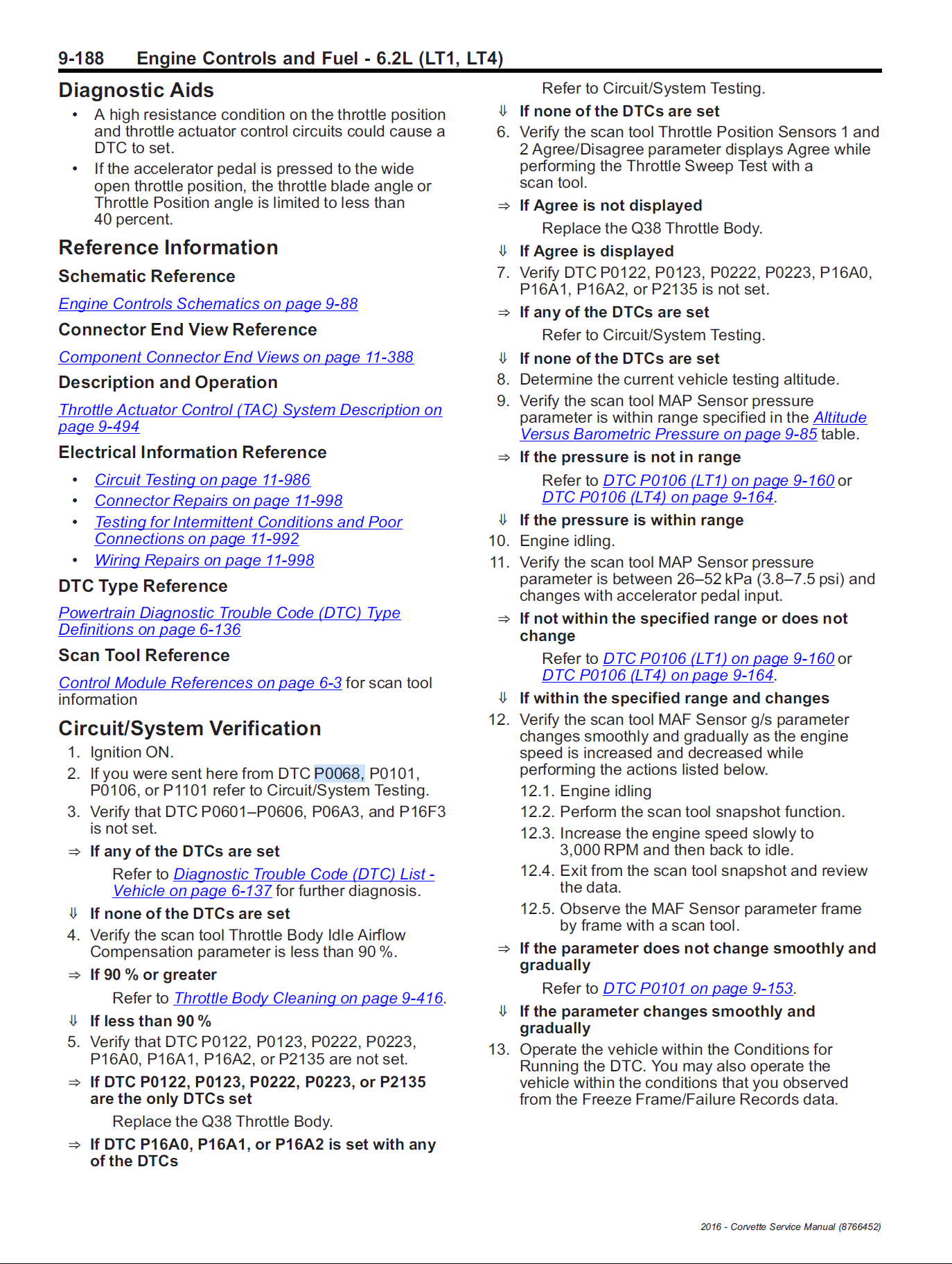

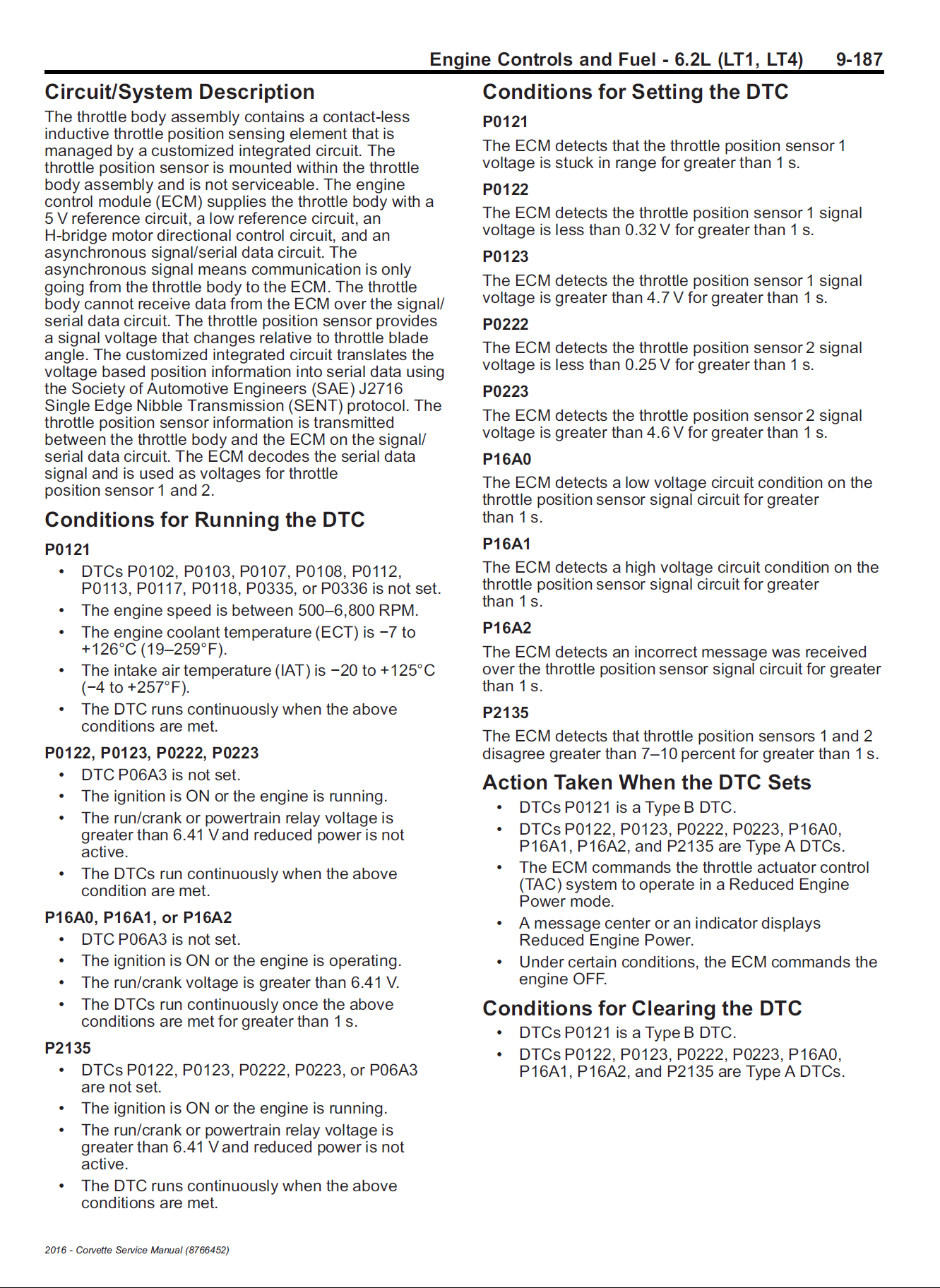

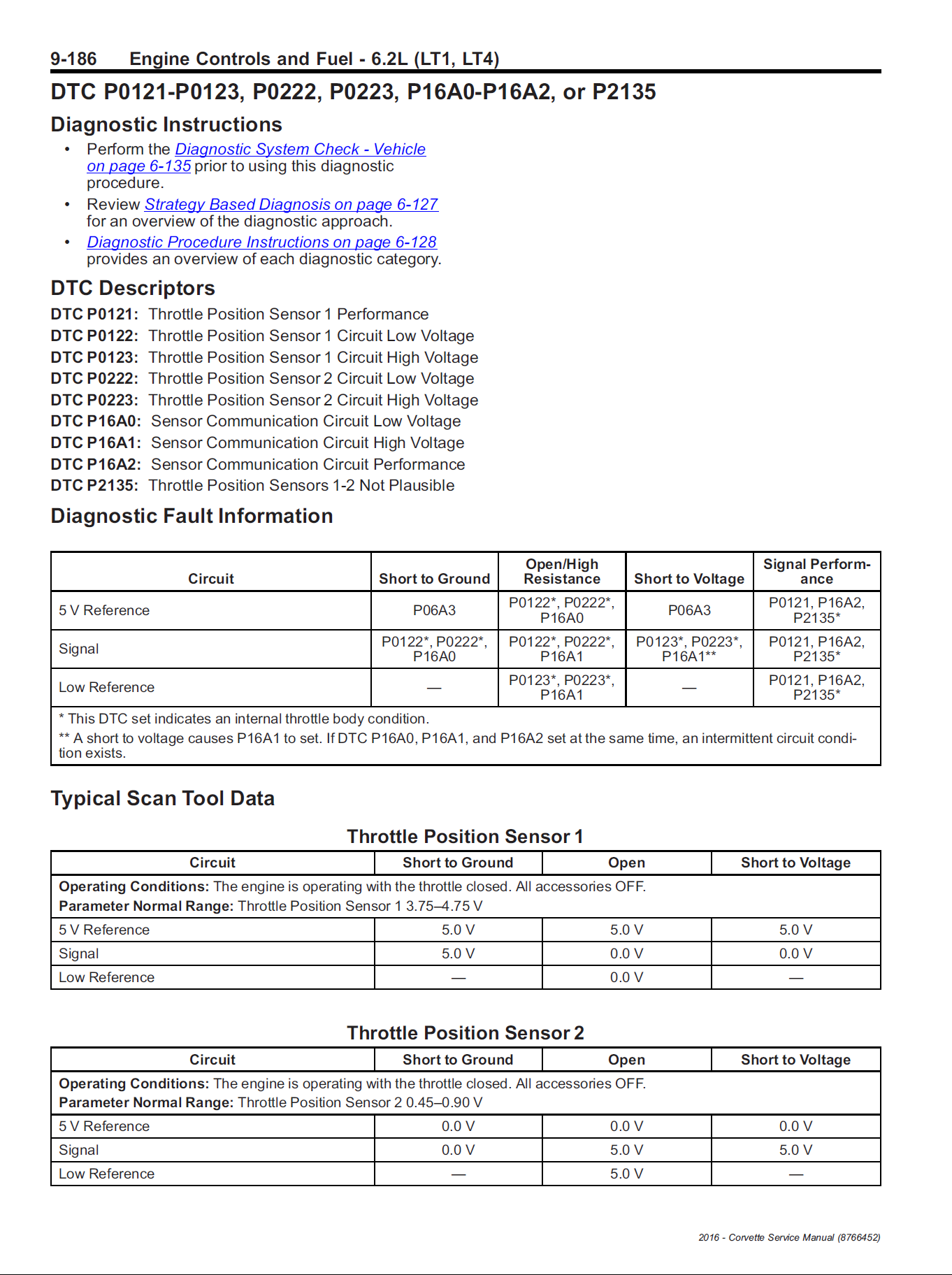

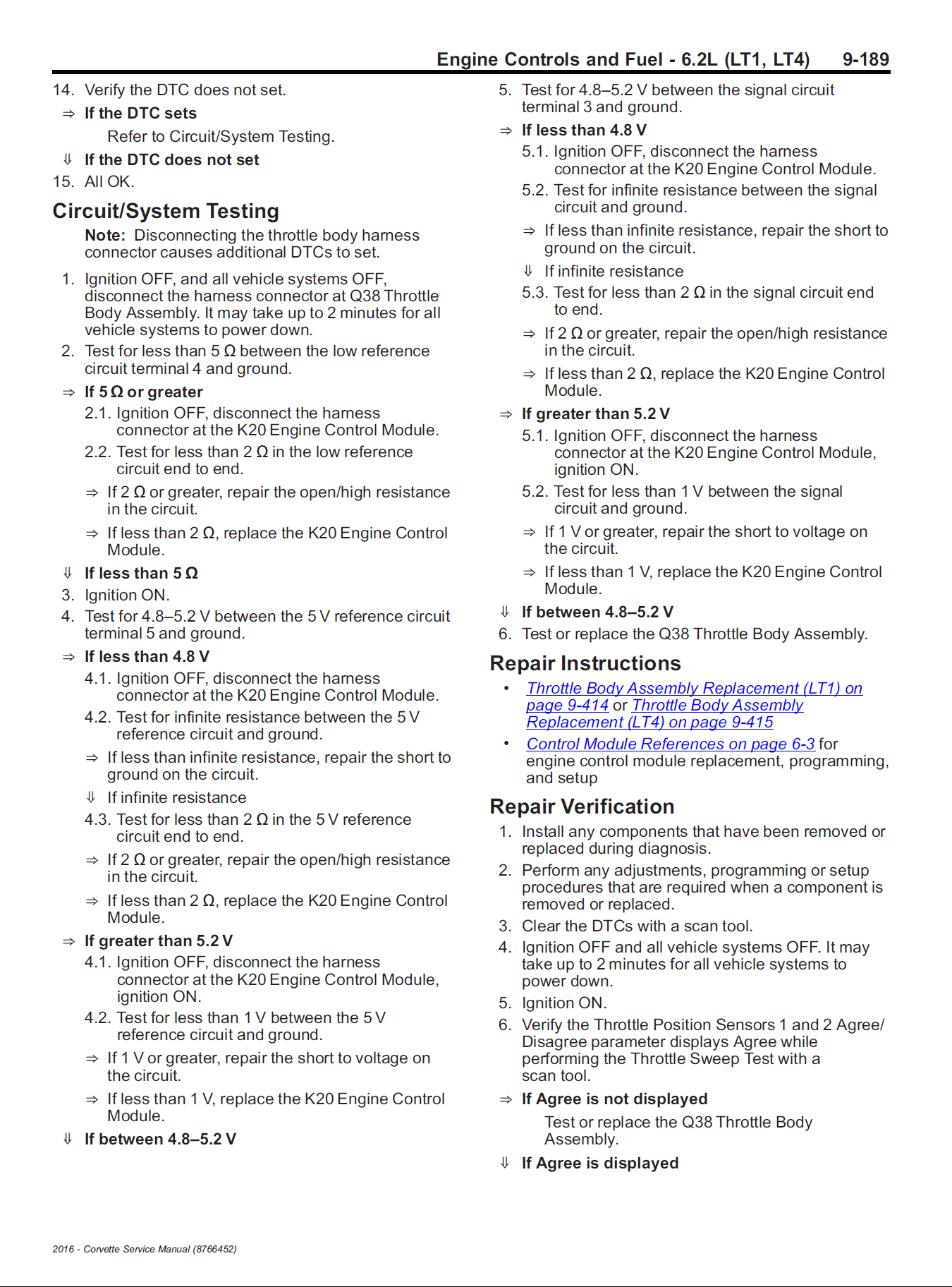

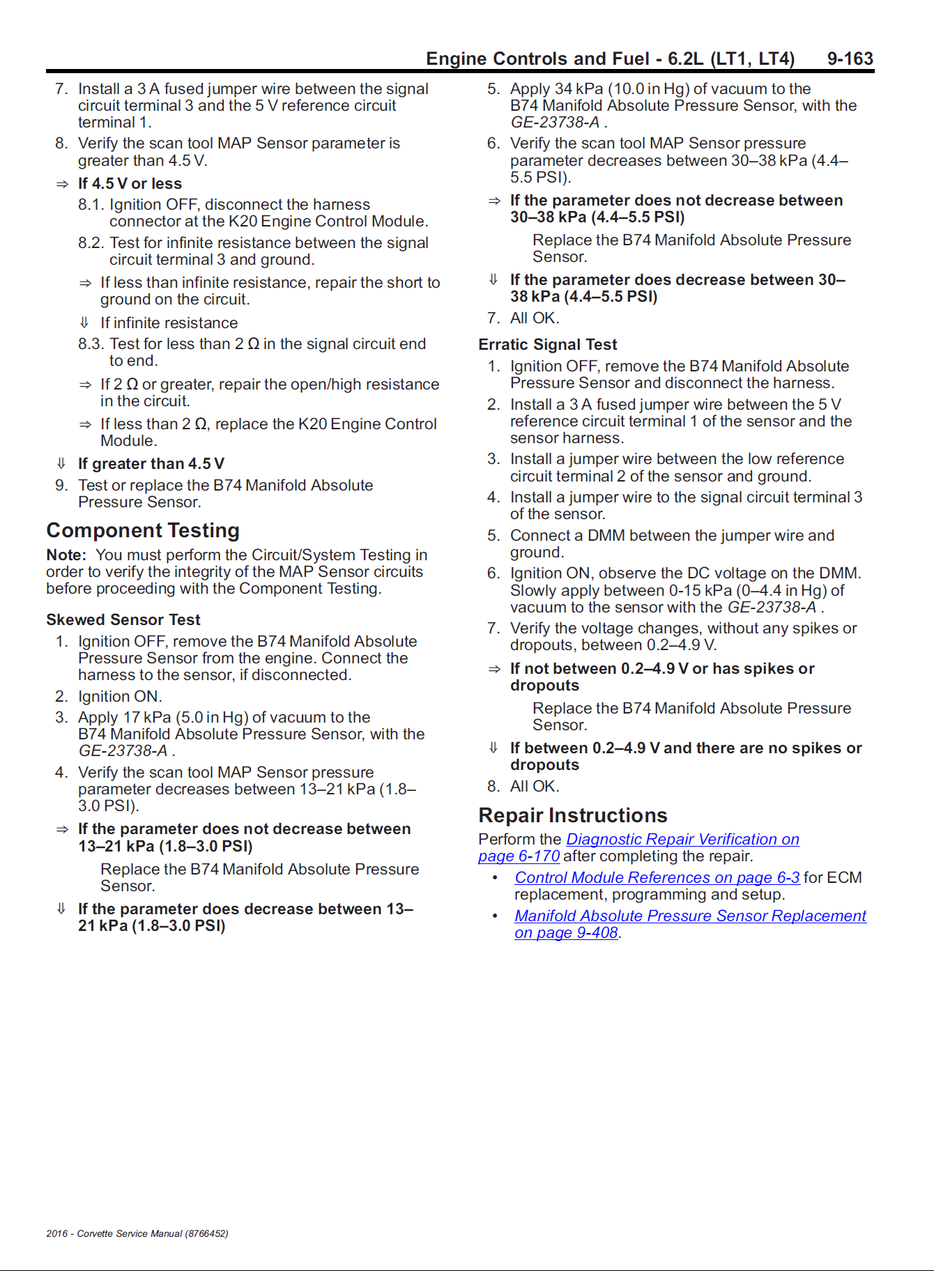

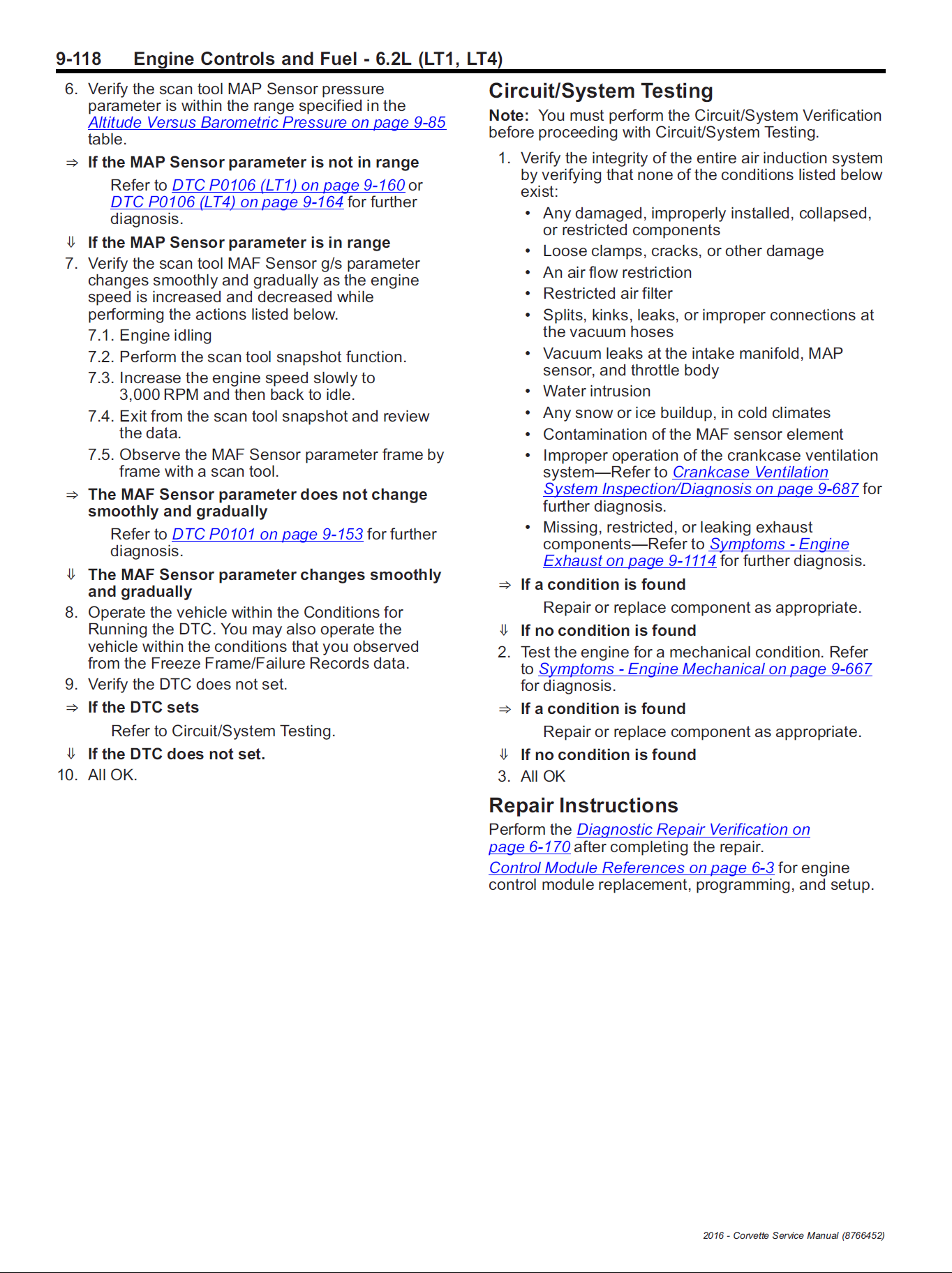

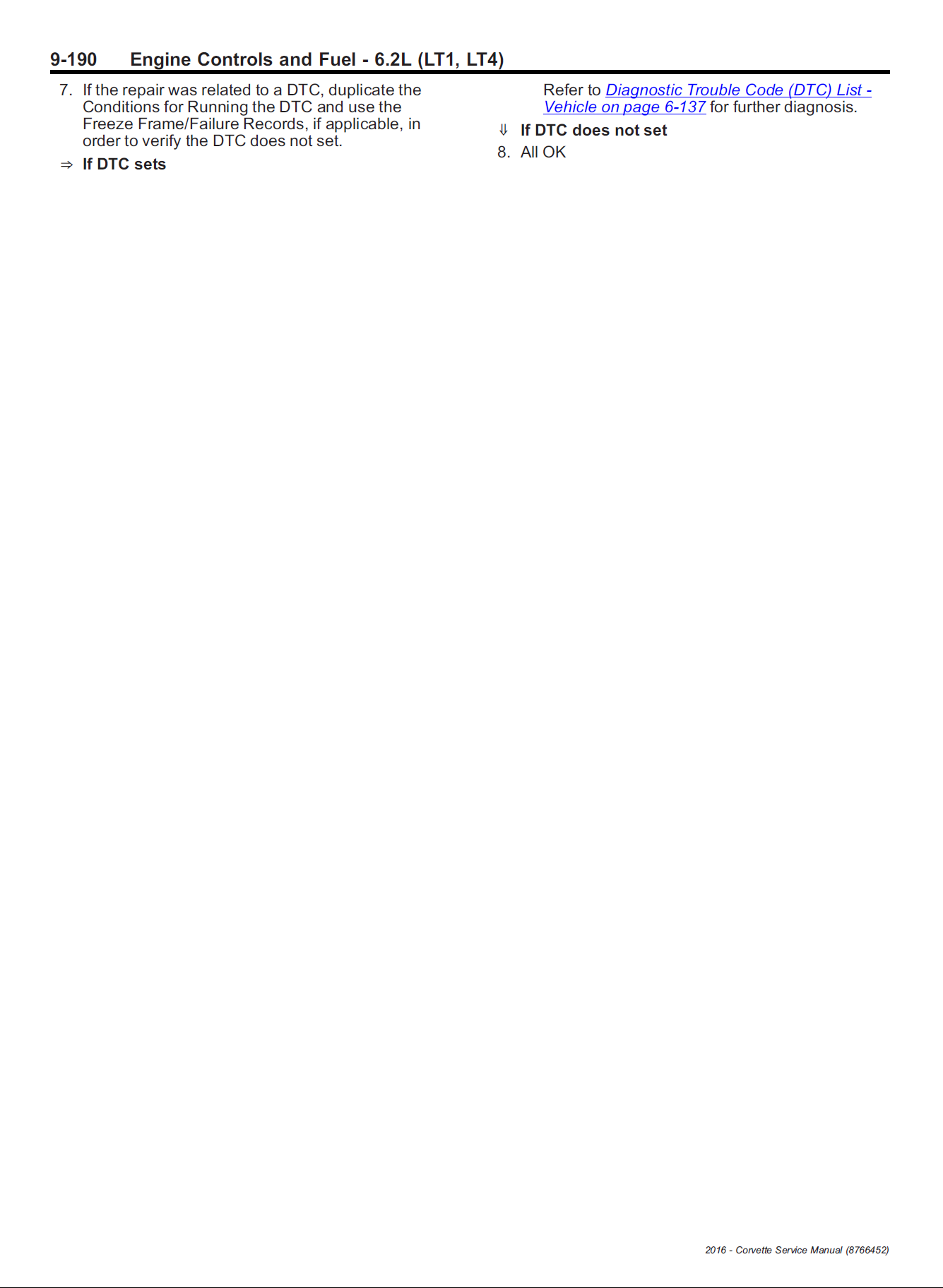

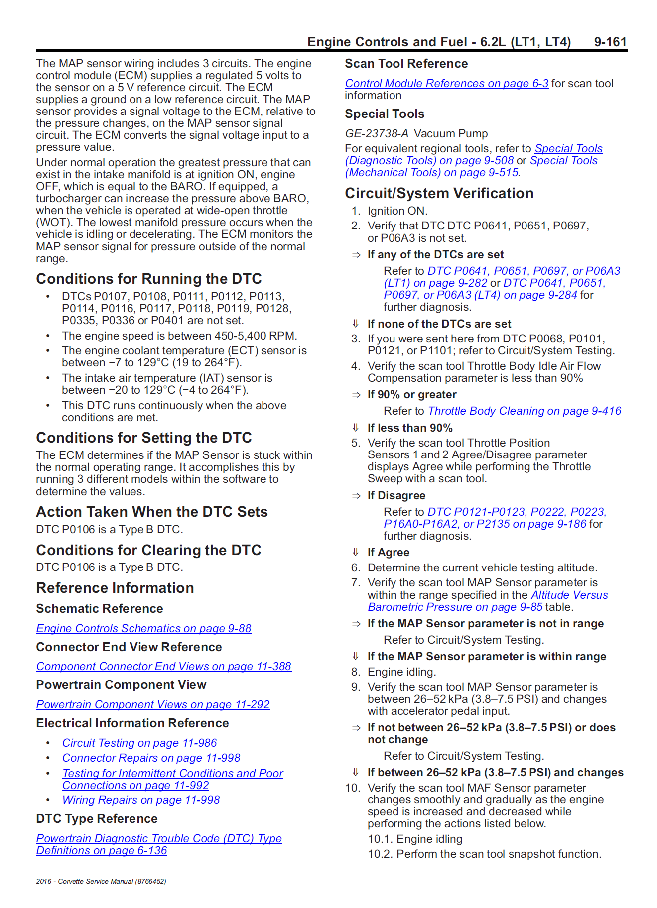

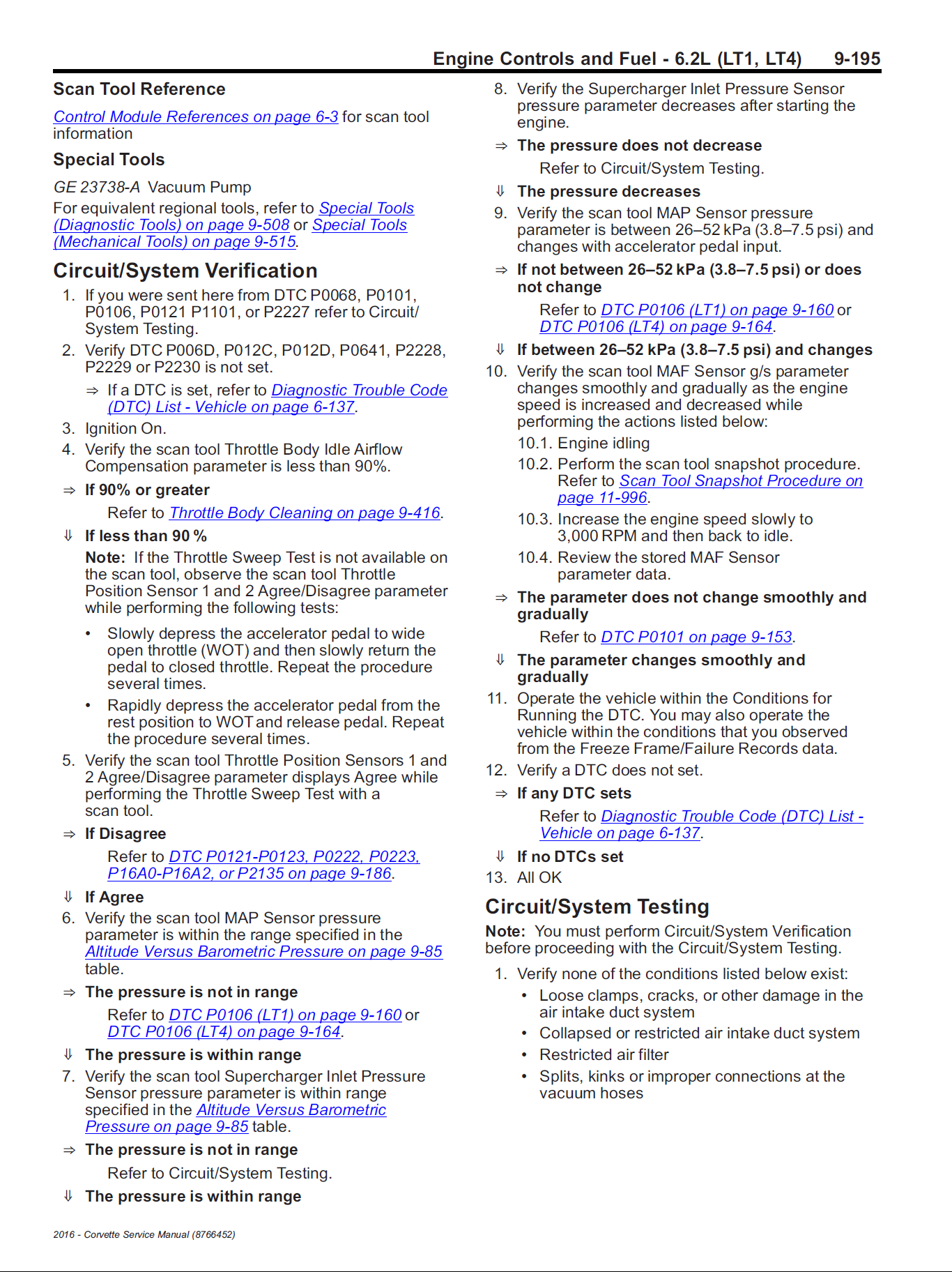

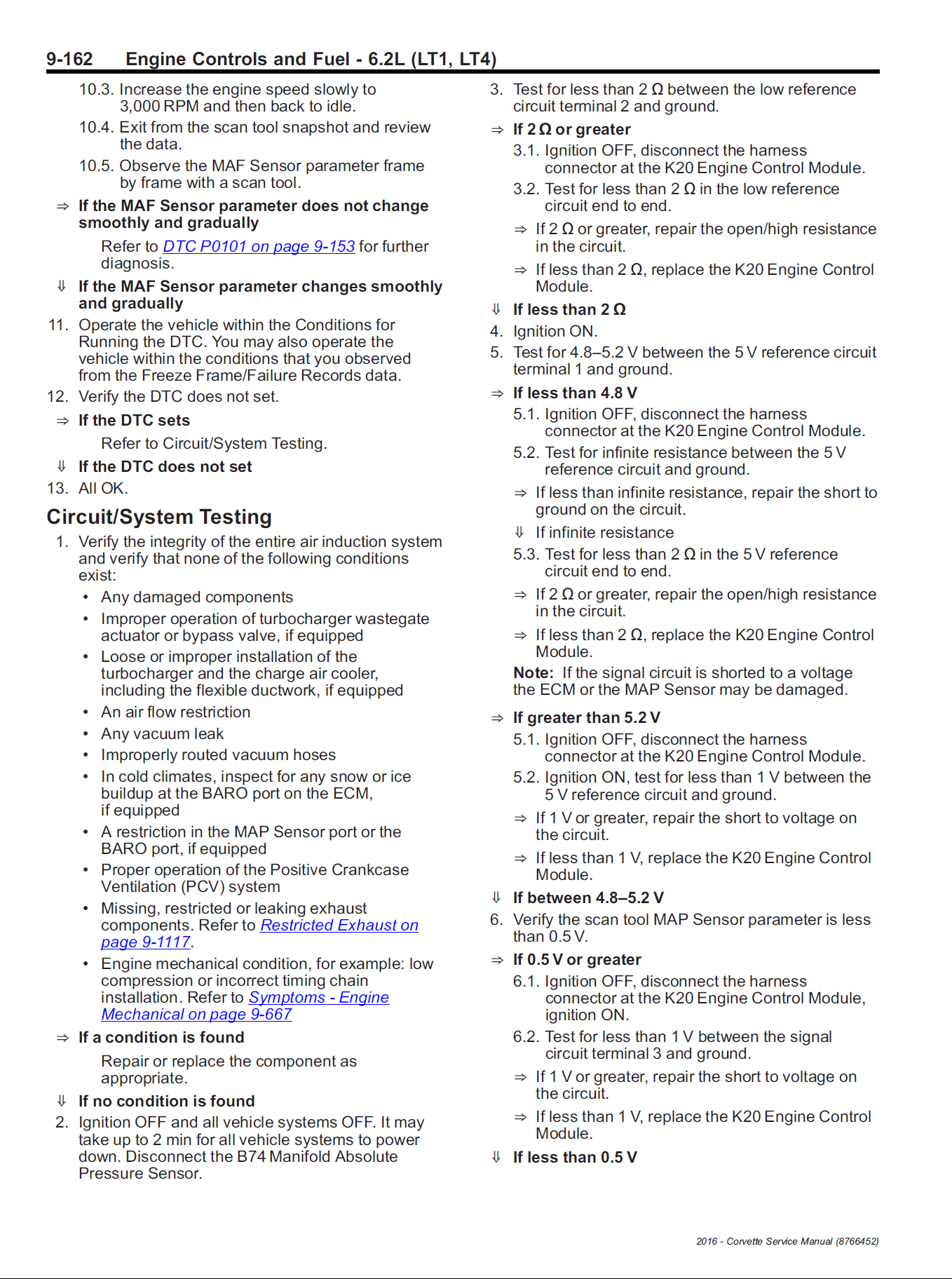

P0068 is a lot more involved than the things you checked. Here is the diagnostic procedure for the code. The procedures for the subsequent codes are included because the procedure for P0068 has diagnostic links that take you to sections of those procedures.
Your problems after the battery replacement are probably due to some glitch you introduced when switching batteries. Remember just because a battery is old doesn't mean it is causing issues. As long as it supplies the voltage required the car will work fine. From your original post, it looks like you only had one DTC. A low battery will cause multiple DTCs across multiple systems that aren't related to each other. I think when you get your post battery replacement problems cleared up you will find you still have DTC P0068. Just because a solution worked on a C6 doesn't mean it will work on a C7.

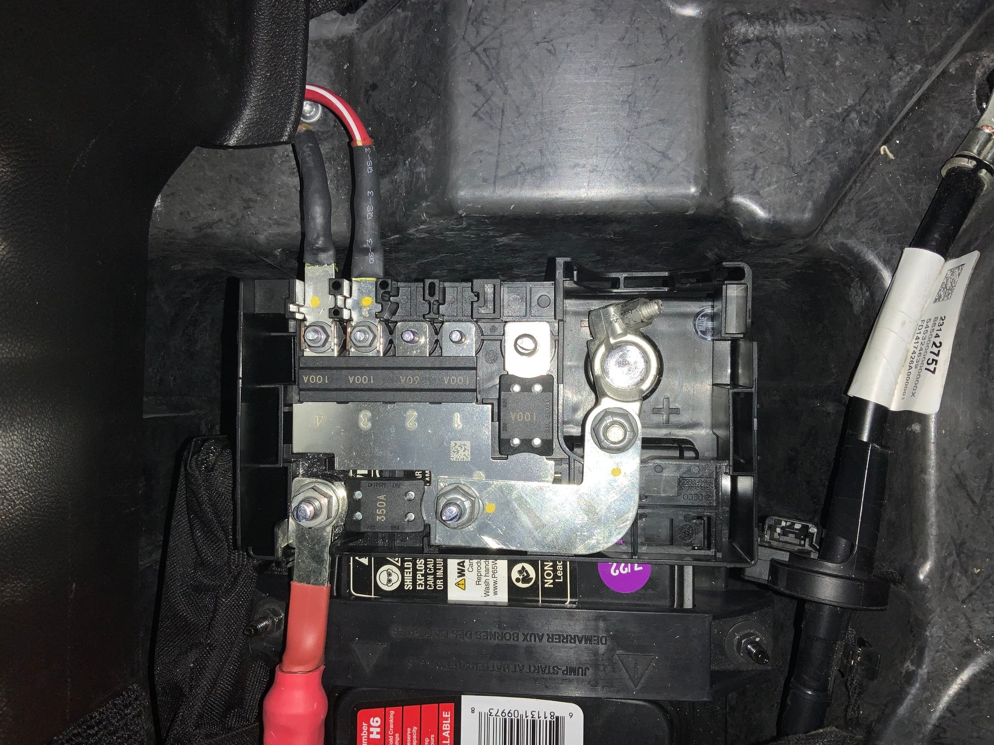

Next update, left it on the charger overnight. No change. A bit of reading and testing, the 350 amp fuse on the top of the battery appears to be blown. Not sure when or how it happened. I did not have a big spark or anything when changing the battery. So now what? Do I try just replacing that, or am I likely to blow it again due to a starter or other issue?
Another add: I read about 10 ohms connecting the negative to the “working” side of the positive leads (the top 2 in the picture) and about 4 ohms on the positive lead to the left of the 350 amp fuse.
