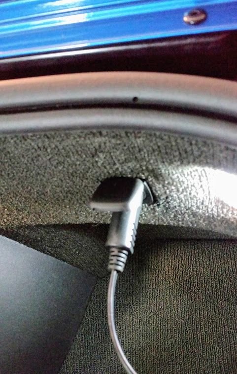

What is the easiest way to access the wires for the charge port in the trunk?

The Charge Port on the right side is for your Battery Tender.

I understand but wondering the best way to access the power coming to it.

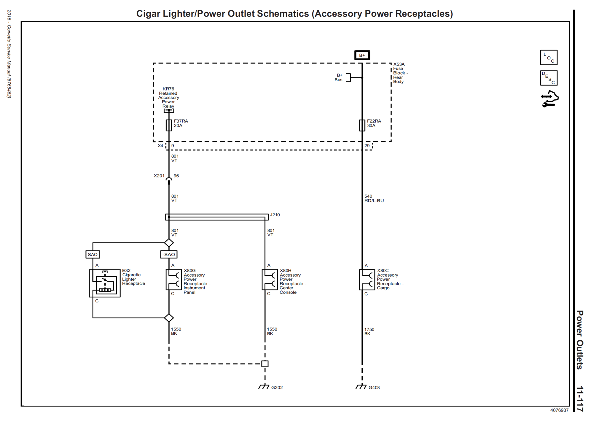

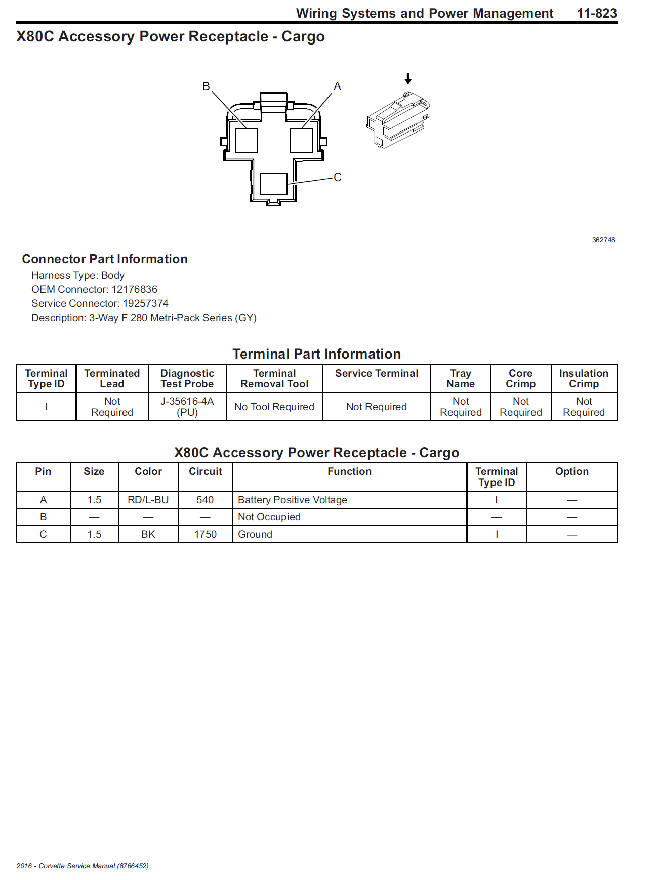

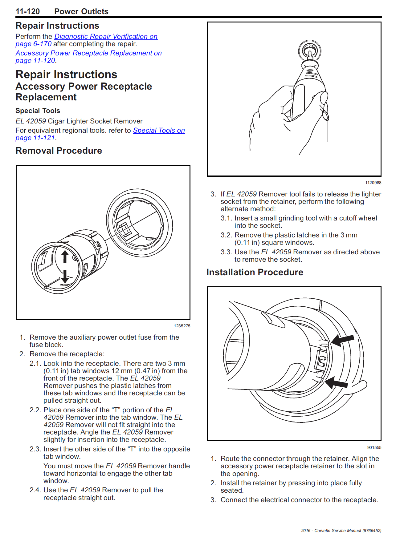

Here are the instructions on how to remove the plug and the schematics to go with it. The connector is behind the plug and you could splice into the wiring at that point.
Bill
