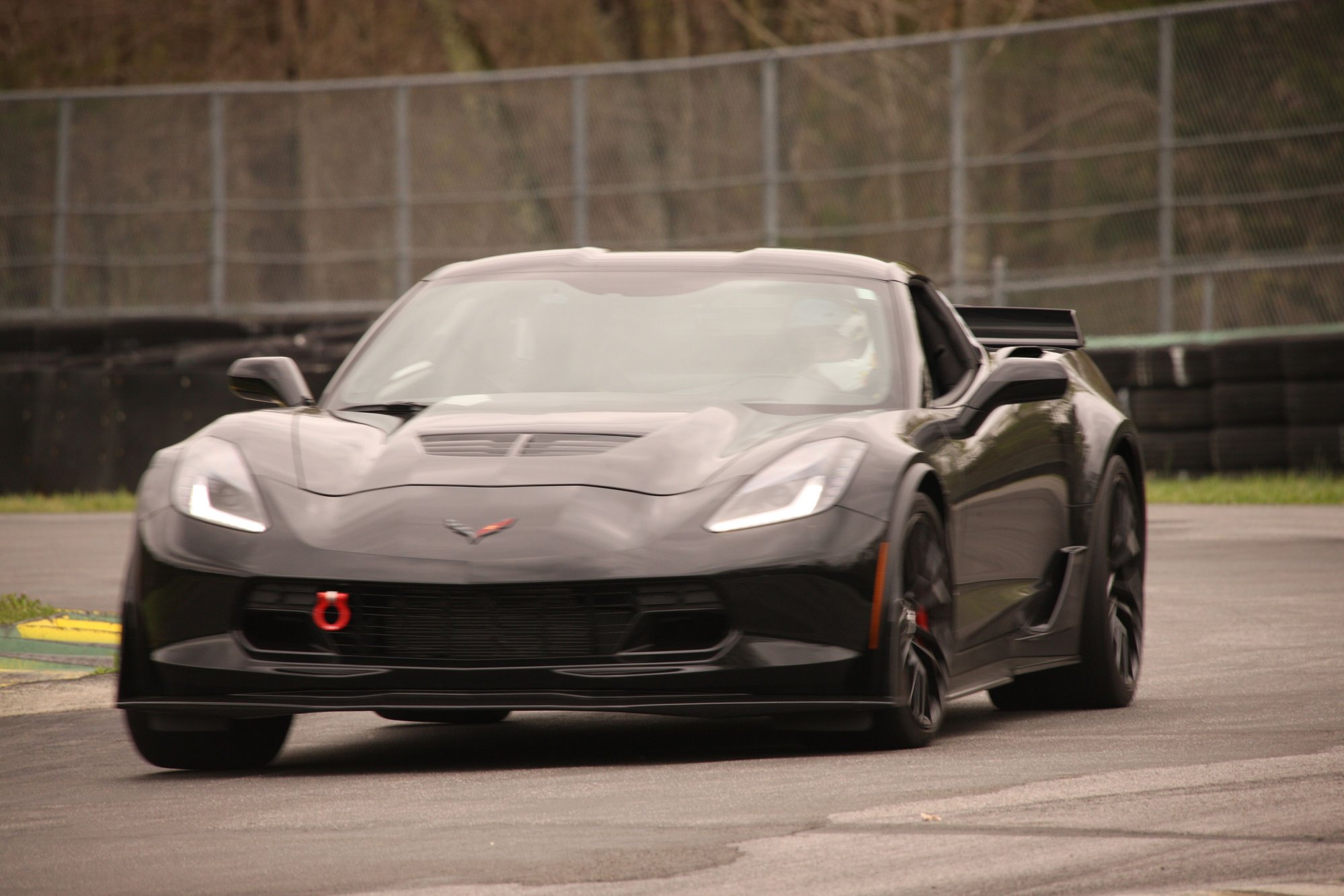

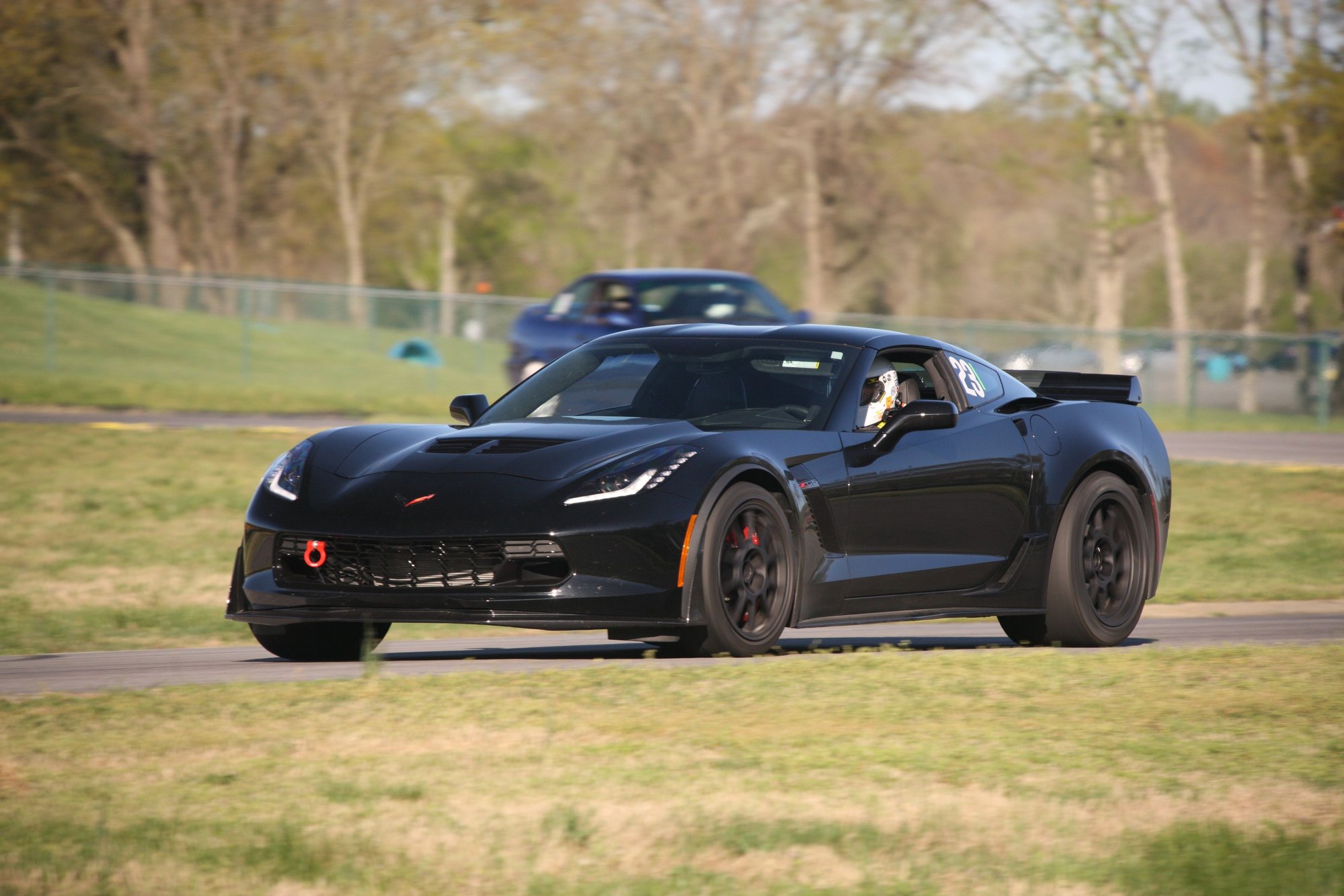

Update: Here are a couple of pictures showing the car running with 18x11 and 18x13 wheels with Hoosiers mounted. The second picture is the one in my avatar and it clearly shows the outside tread of the inside wheels being pulled off the ground when going around the Oak Tree corner at VIR.
As you can see it puts some meat on the ground.
Bill
