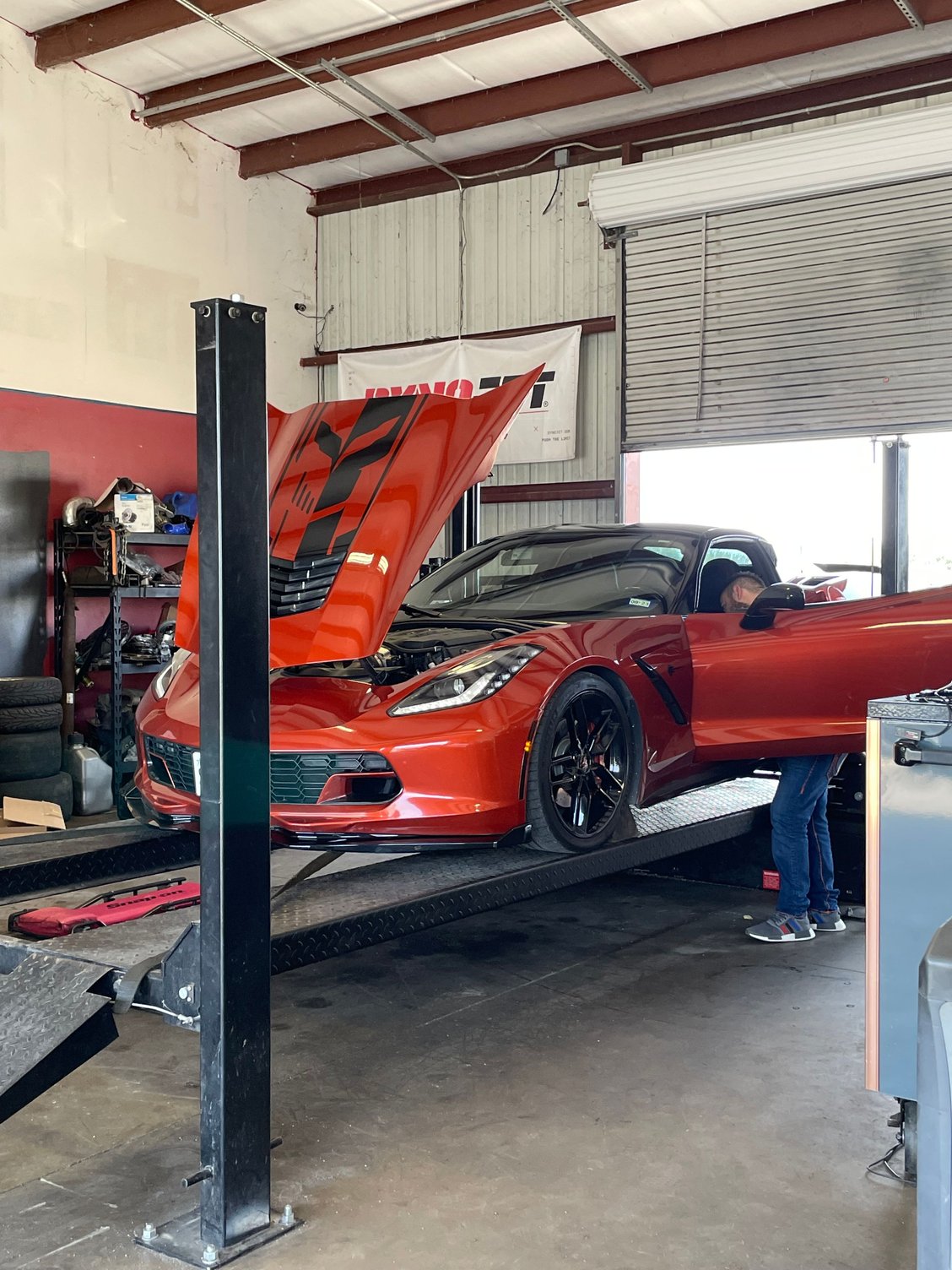

Hello,
I’m new to this forum, just wanted to get some opinions on who is the best tuner. I just did a dyno tune but results are not as expected. I’ve seen many other members here with less mods with higher numbers than me.
2015 C7 Stingray
Texas speed Headers and x pipe, straight pipe axle back.
MSD manifold
Halltech CAI
103 mm throttle body
Cam (not sure what type, car already had when bought)
Dsx flex fuel kit but not on e85.

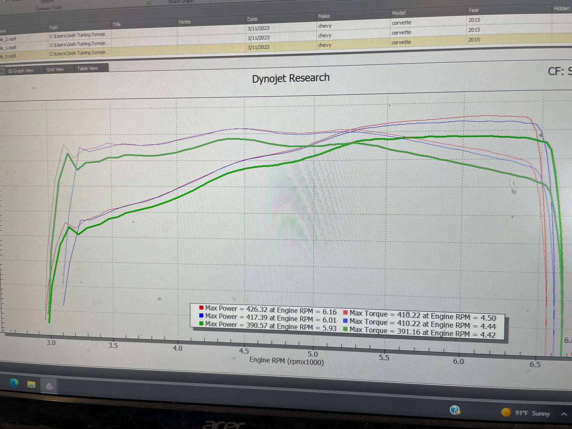

Final numbers 93 octane 426whp / 410tq

Could just be a heart breaker dyno. Numbers are trivial. You need to measure performance at the track or with Draggy.

banner says dynojet.. but yeah seems low. i heard mustangs def read low
you have more than me (intake manifold and tb) and i put down 533

That is low. He should be around 460-470 with what's been done to the car. Some guys tune very conservatively, and I'm guessing that's what happened. Did you talk to the tuner and ask him?

Lots of variables here, auto or manual, is everyone talking numbers at the rear wheels? Dynos are funny things as even the setup can affect numbers. If you really tie the car down too tightly you can lower the final numbers, alternately slipping on the drums can also affect numbers. Finally with a cam with unknown specs it could be something that just isn't designed for best N/A numbers. Maybe the previous guy was looking to go FI or even nitrous and the cam was spec'd to give the best numbers under those conditions.
You really need to see a data log to see what is going on, maybe the car is pulling timing due to false knock or even real knock.

id find a true measure of performance before getting heartbroken. id fully expect a cammed c7 with supporting bolt ons to trap bare minimum 130. a dragy or trip to the drag strip will tell you that much.
dynos read both ways, however it is usually on the high side.

as mentioned here, numbers are meaningless. look at the curve, and look at the differences between changes.
if you want internet hero numbers, tell the dyno operator. they'll print you a chart with the same exact curve but with bigger numbers for a bigger pp
