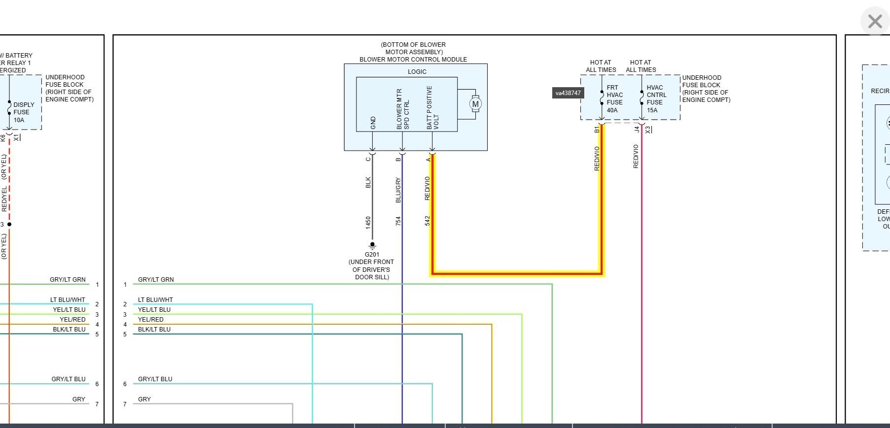

So you're saying the blower fan speed is not increasing or decreasing as you turn the control **** ??...you can check fuse 40A in the underhood fuse box...beyond that you'll need a DVOM or test light to see what's happening at the blower control module...a power, ground, and a pulse width modulated (PWM) signal from the HVAC module...I see you live in Florida...if you are near Cape Coral I'd be happy to look at it for you.

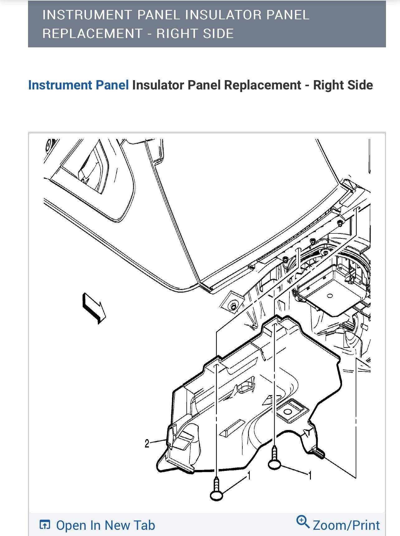

If you have a voltmeter you can access the blower motor control module after removing the right instrument panel insulator and check a few things.should just be held in with 2 clips…best to use a 12 volt test light to check to see if you have power to both sides of the fuse…that fuse is “hot at all times”…if not something you are willing to tackle yourself best to bring the car to a diagnostic shop and not a general repair shop or a dealership...they only know how to change parts…not diagnose…most if not all dealership techs work “flat rate” so they don’t have time to diagnose…they lose money !!…wiring below is from a 2014 but should work…keep us advised !!…maybe a couple taps in the motor might get it working.

Thanks again. I checked the fuses themselves with an ohm meter to insure the fuses #6 and #17 are good. Don't understand right instrument panel removal. Can you describe it. Have test light and volt meter.
