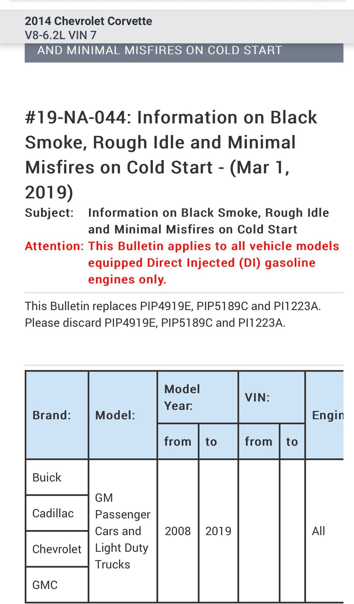

I normally…well I always bad mouth dealerships because of their lack of diagnostic skills and this just reinforces my feelings…tell them to READ THEIR TECHNICAL SERVICE BULLETINS !!…if you’re in the Southwest area of Florida you can bring it by but these cold start misfires according to GM are normal…and my diagnostic equipment I use is WAY more advanced than theirs…and they only guess !!…I saw it’s #4 cylinder but you disabled AFM…you should tell them not to charge you for ANY diagnostic time...TSB says they should look at “injector pulse width” during this cold start up but the thing is they don't use a scope to check this...you can ask them about it…if they can’t check it I’ll be able to check that…cold start misfires can also be the result of a blown head gasket and carbon build up on your GDI engine.
I know what this is saying as far as the normal cold start goes, you can definitely feel it normally running rough for the first few 20-30 seconds, however this feels like a full-on misfire that continues after that initial warm up period. It may partially be due to it, but it is definitely something more than any cold start period I have experienced in the past 20k miles of daily driving the car.
