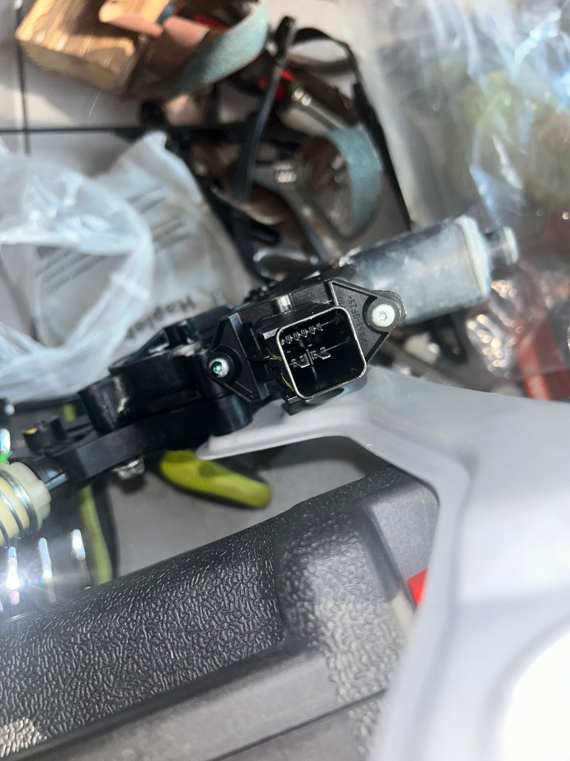

This is from my driver side door. The two larger pins are power and negative the five small others I’m assuming are for controls. My question is, can I test this motor by simply applying hot and negative or do I need to supply voltage and then manipulate the five pins to get the motor to work?

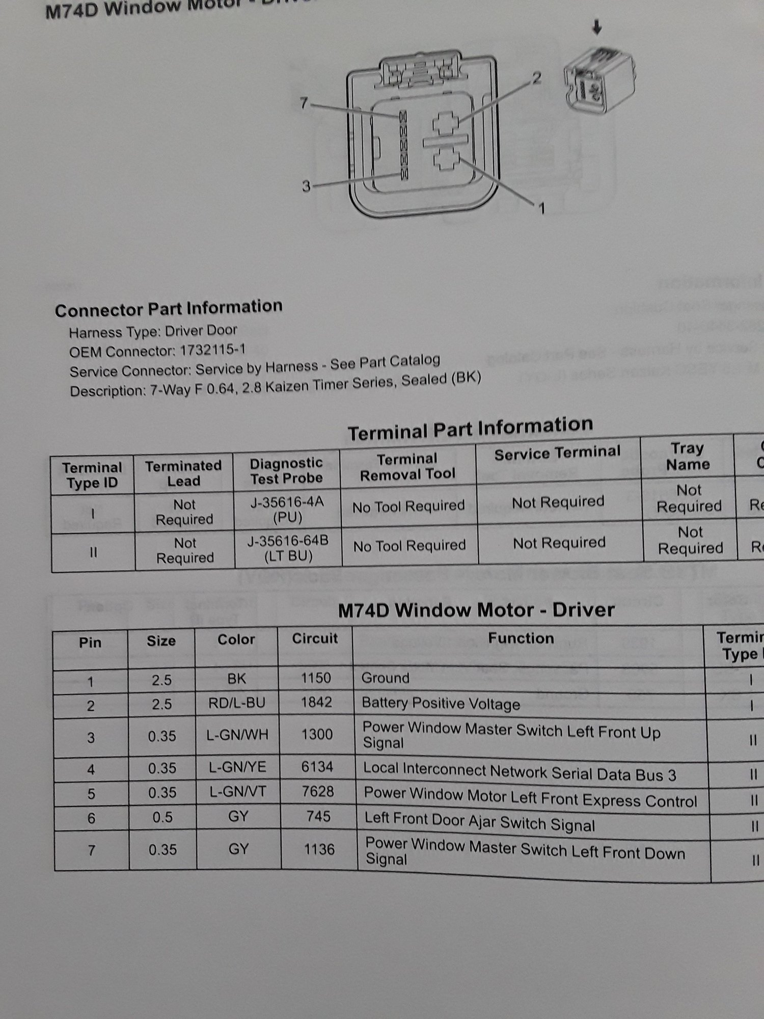

Power plus ground to one of two pins.

so would I need to jumper from power pin to pin 3 for up and pin 7 for down?
No! Jumper from ground to pin 3 or pin 7.

I should be able to bench test this with a DC power supply right? however, I can’t get it to work. There is a positive lead a ground lead, and a negative lead.
I’ve connected the positive lead to the positive pin in the connector, negative lead to negative pin and then jumped from negative pin on the connector to pin number 3 yet nothing work.
What am I doing wrong?
