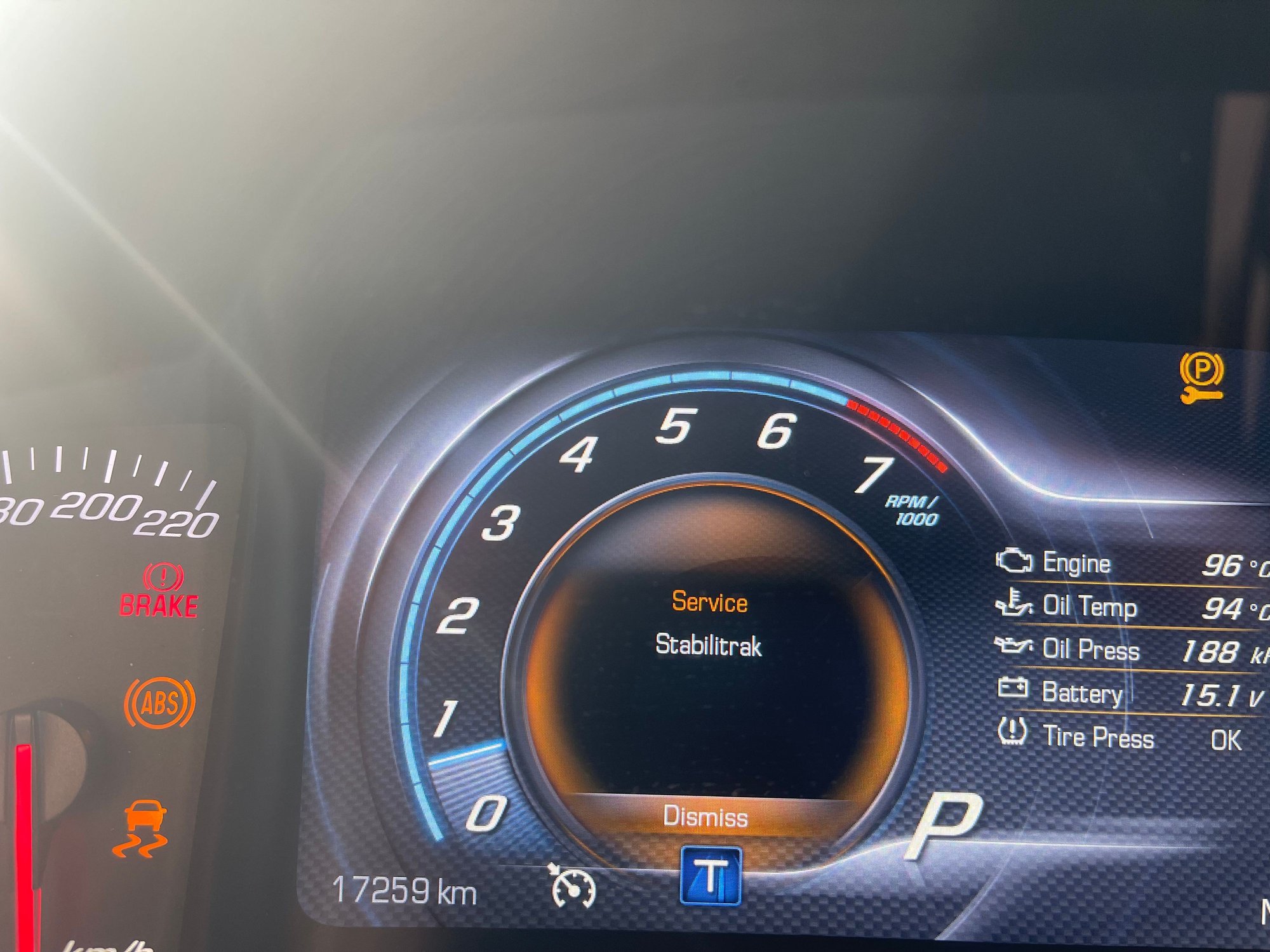

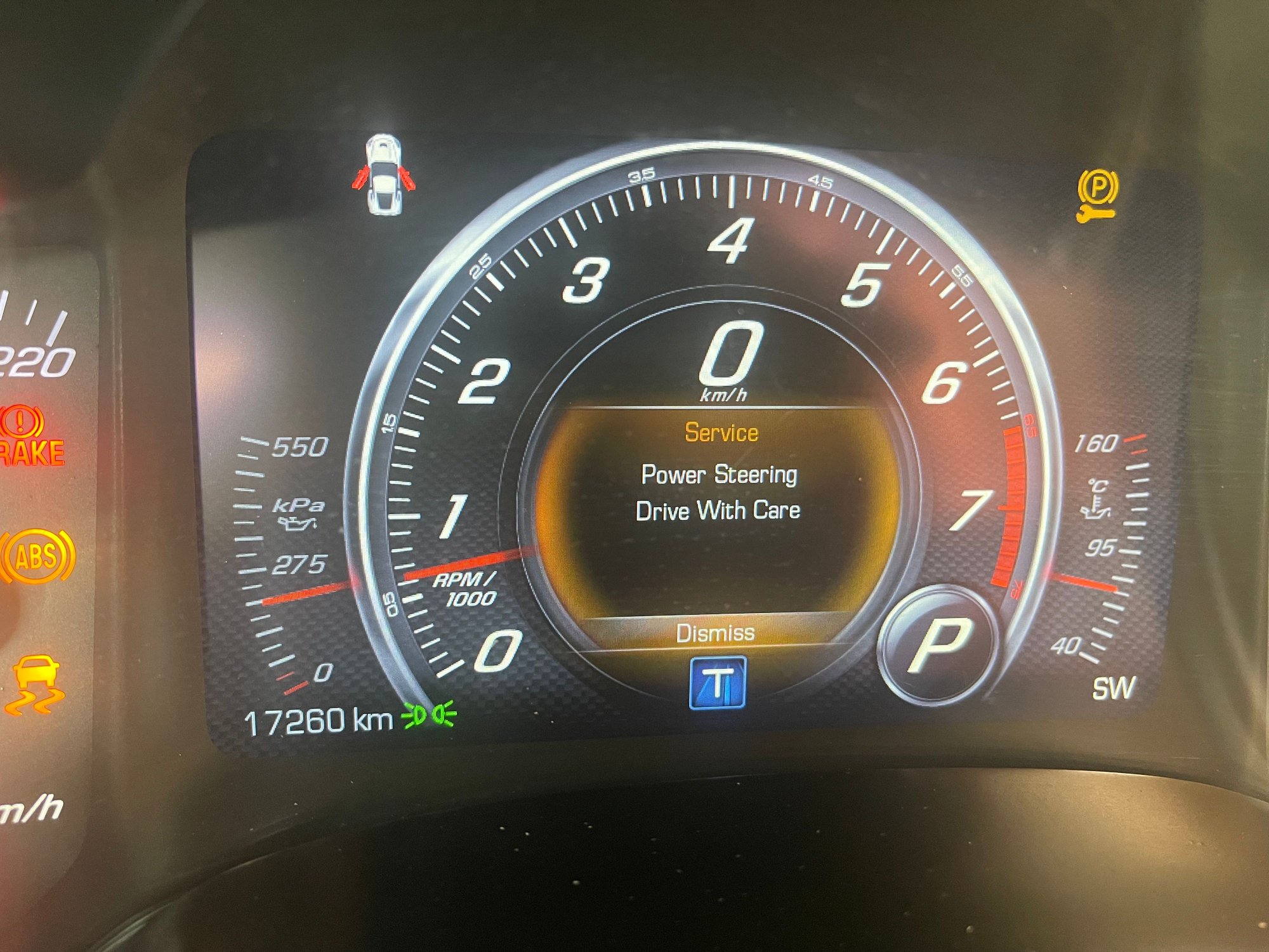

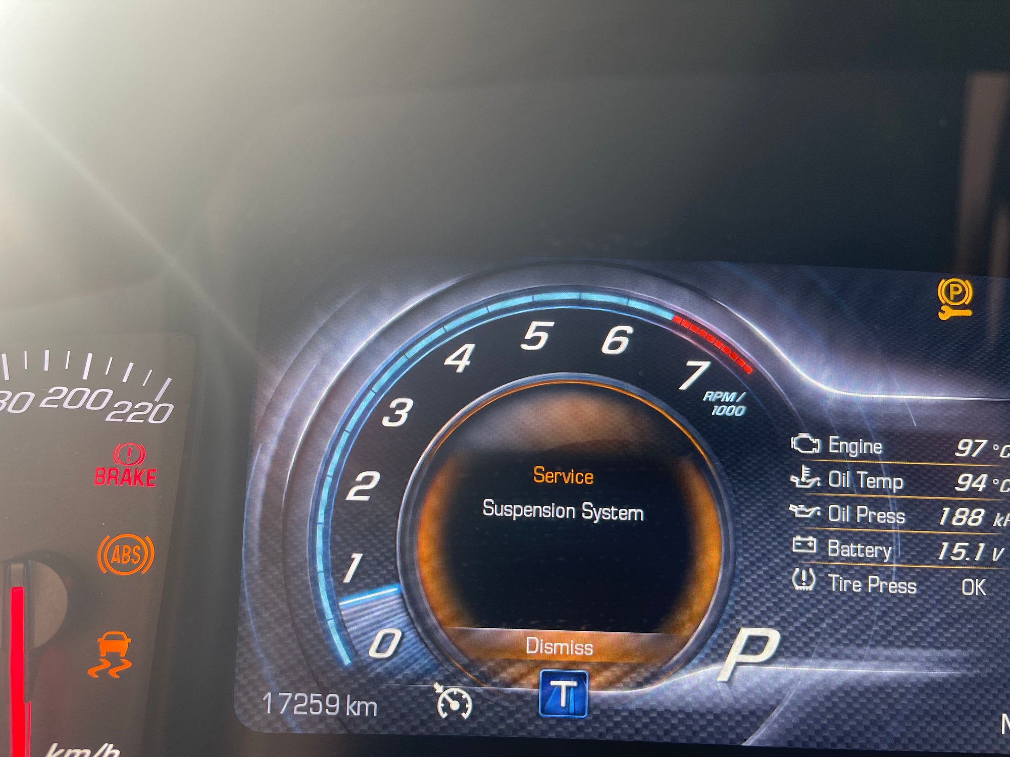

I’m hoping someone can help with the following. I have a 2015 Z06. I’ve had an intermittent issue with the below warnings for the last few months and now the lights and warning’s are permanently on. Service Stabilitrac, service rear axle, service suspension system and service power steering. The battery is new and alternator tests ok.
any ideas out there.

Check the battery negative connection. Look for a thin black wire that should be on the connection.

Hi Elmer
I have checked that wire and it is fine

Try taking off the ground at the battery and short it to the positive cable for 3 min. Note no connection to the battery negative when doing this!!!
this is a hard reset and may clear up your problems

That hasn’t worked unfortunately but thanks

Scan tool time..........

The GM dealer had my car for two days and couldn’t find the fault and said they can’t fix it?? Time to buy my own scan tool.

How old is your battery? Marginal batteries (which test fine) do wierd things to the electrical system.

Fitted a new battery 3 months ago, Optima yellow top.
