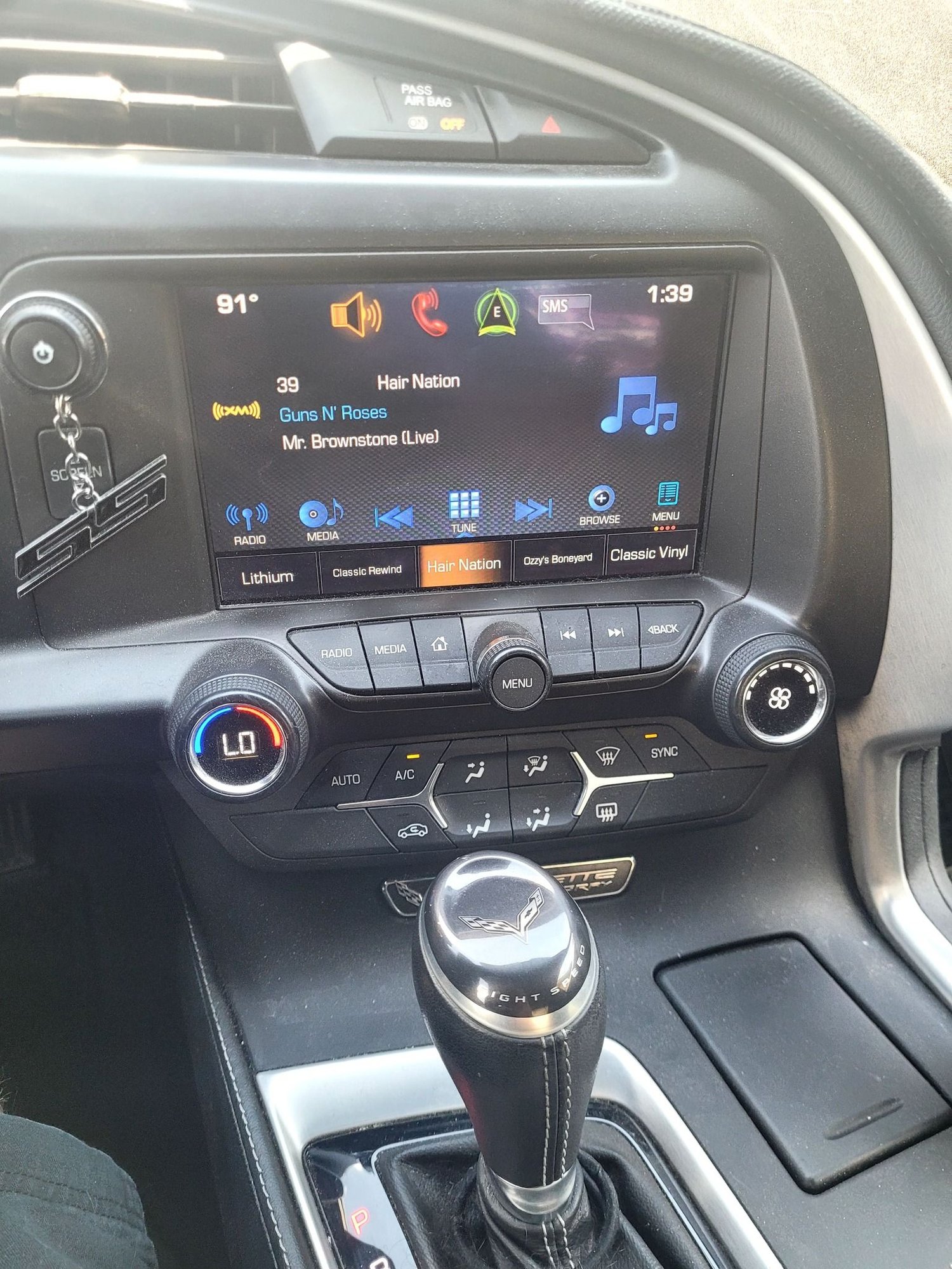

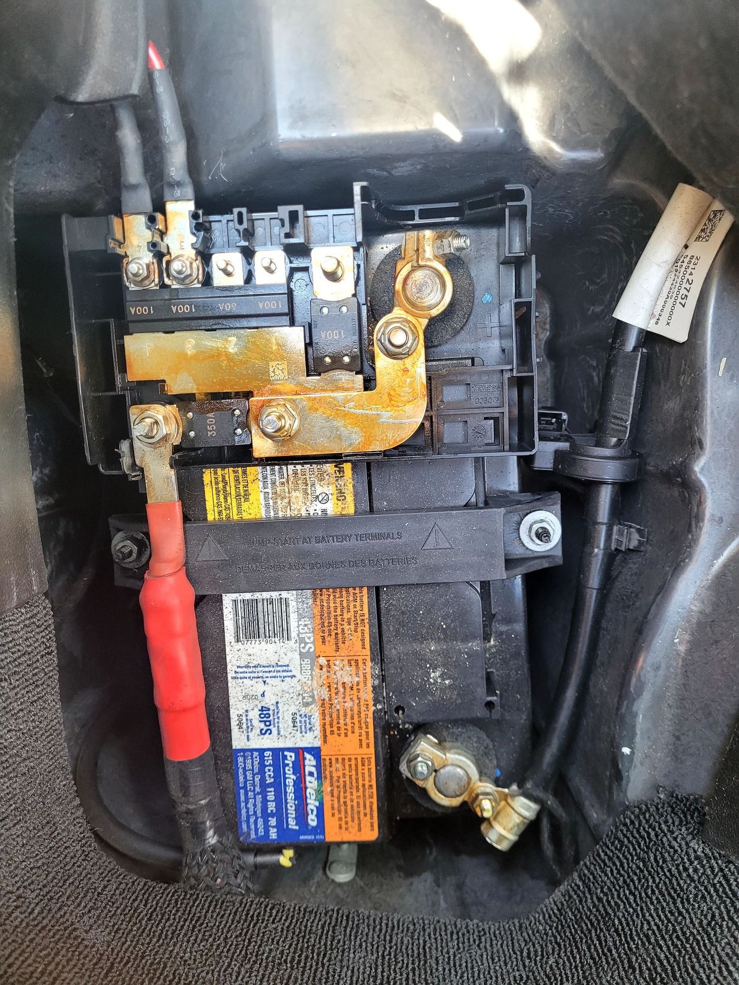

Last February I went thru all this at the Dealer. New blower motor, bend door etc. Now my blower motor is very intermittent again. It usually acts up after sitting for a few days. Im thinking the control module. Can this module be reset with a battery un plug? Could this also be due to a weak battery? Car runs fine. Battery was replaced in Dec. 2020. BTW.. The light on the top vent button has always been out. My Corvette is still under warranty. Just a hassle going with out it. Thank you.

This is not a battery issue…instead of the dealership just shotgunning parts (which they normally do) they should have checked the wiring at the control module…just 3 wires…power, ground, and a pulse width modulated (PWM) circuit that controls the speed of the blower motor…the PWM wire can be checked with a DVOM and the ground can be checked with a 12 volt incandescent test light…I would lean towards a bad ground (G201).
