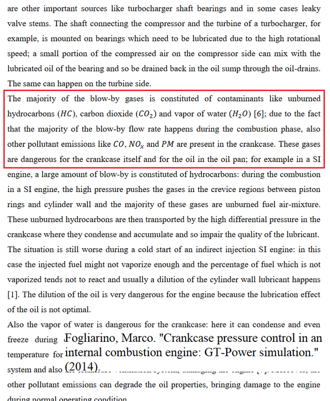

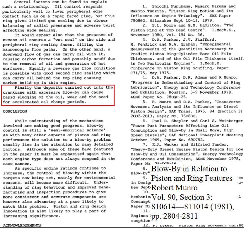

Published papers regarding combustion blow-by gas and PCV
People can ignore the experienced mechanics, tuners, doctors, engineers, published papers, at own risk

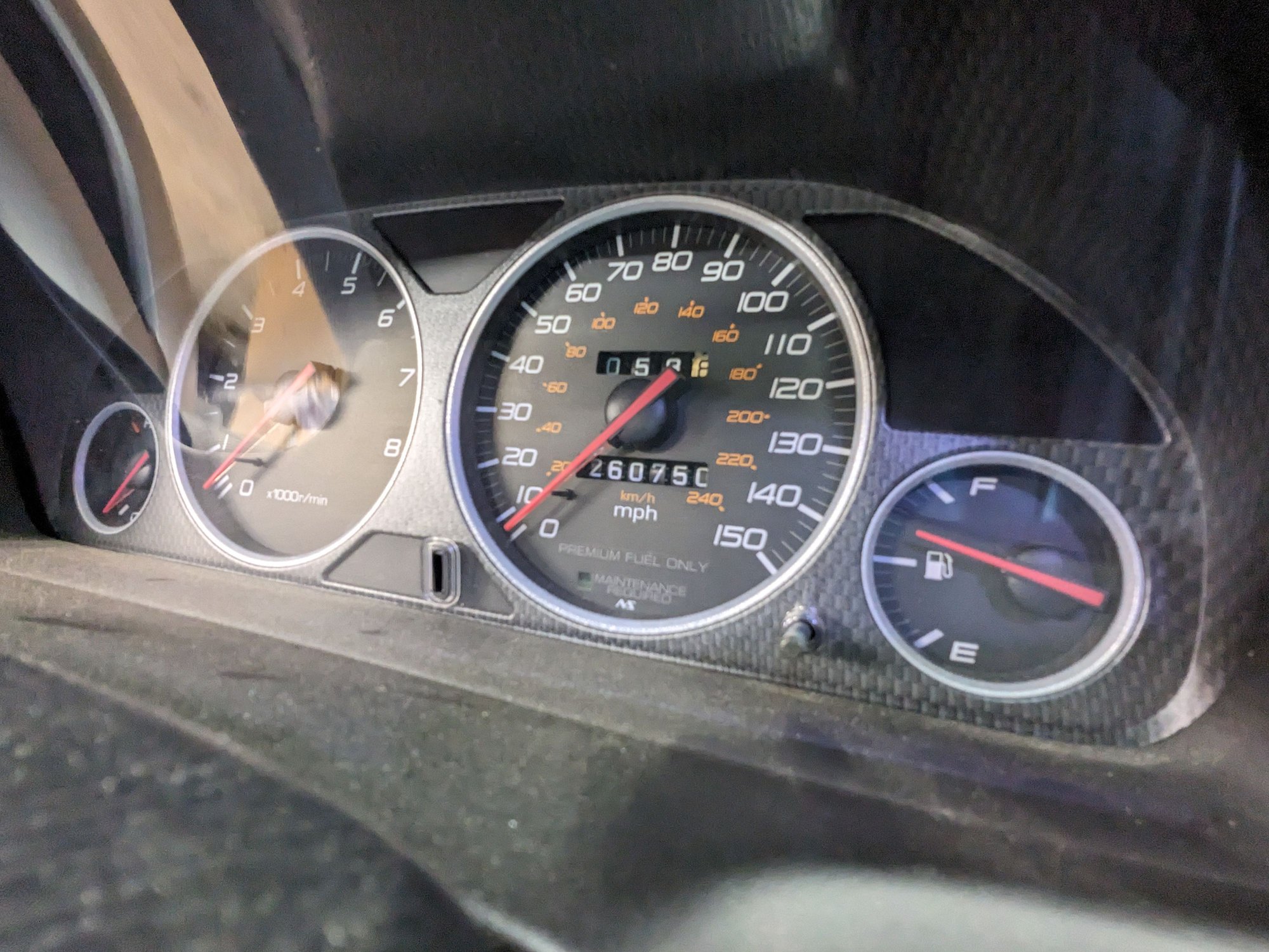

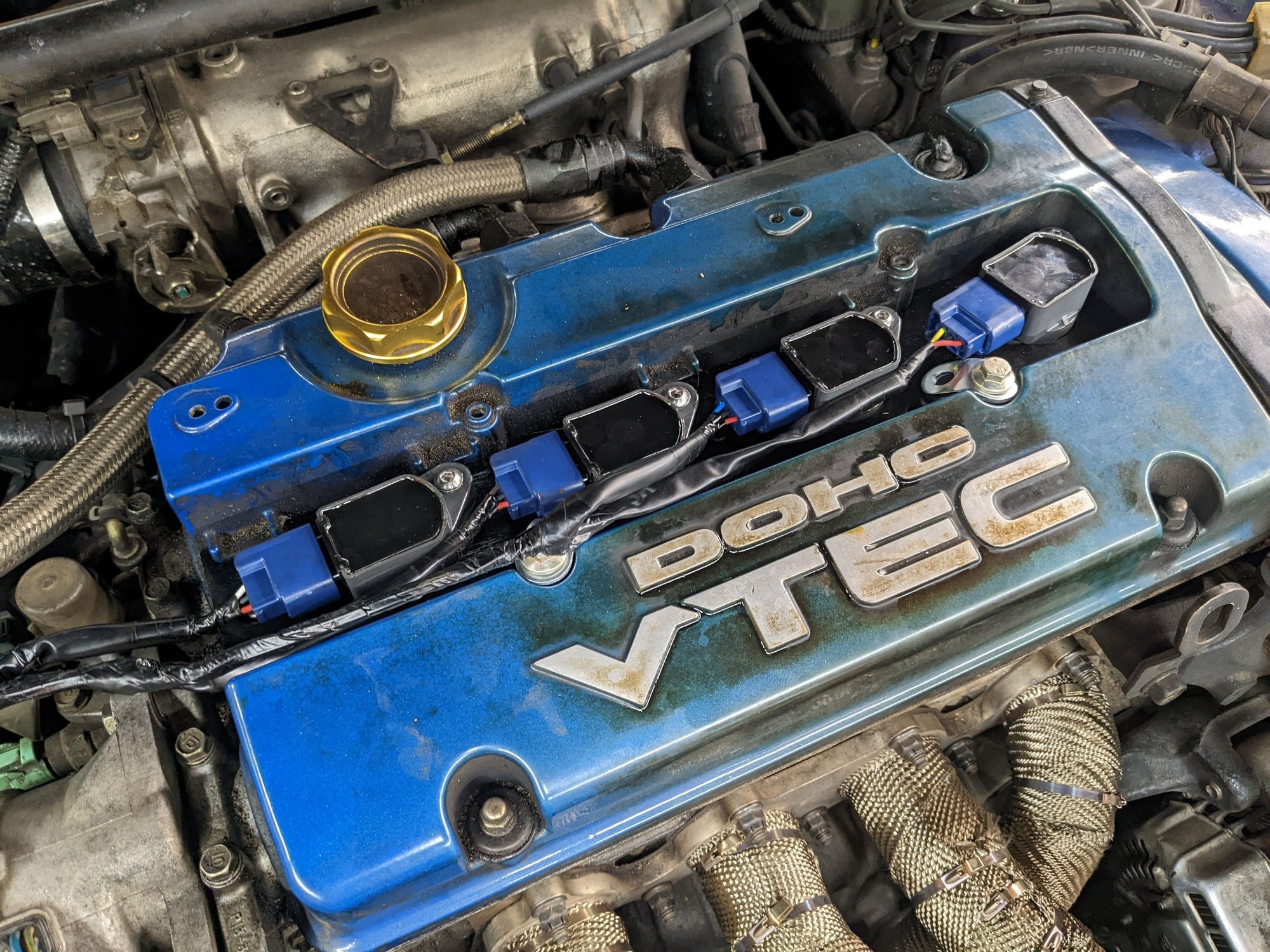

This Honda's Achilles heel is excessive blow-by and oil sucking directly into the intake via the valve cover breather port. The fix is to eliminate both the PCV run to the manifold and the breather run to the air intake.
article about this modification:
https://www.motortrend.com/how-to/ht...lation-system/
I'm not the first and not the last to do this mod. I've owned the car for 20 years and have been operating it this way. My open breather fittings are on the back of the VC versus the front like they did in the Motor trend article. Drag racing Honda guys generally orient in the front due to the g forces from only doing acceleration pulls. My car comes off full throttle for braking zones and other road racing guys seem to prefer placing them on the back of the VC.
I don't have some photos of me with a newspaper back in 2004 to show you, since it never occurred to me someone would be so religious about their perspective on PCV systems that they would be this unwilling to accept an engine doesn't explode because of a catch can or deleting the PCV for an open breather. I didn't take photos of my last valve lash adjustment either. Open breather systems are not something I invented, so I'm not sure why this is some new foreign idea.
Oils have detergents in them. The reason sludge doesn't accumulate has more to do with changing your oil and using one with enough detergents. PCV isn't the main way to fight sludge.
Photo that happened to be on my phone from last year after eliminating the distributor and coil. Engine now runs coil on plug. Notice the lack of the original breather to intake hose. Notice the missing PCV to manifold run. Instead there are two -10an hoses.
Video I also had on my phone some early 2022 when I burped coolant after transmission reinstall: https://photos.app.goo.gl/eo8G5Eww8jjd5Kme8
I believe that you honestly believe what you are saying to me. That's a bit saddening.
Edit: Took a shot of the odometer this morning.
