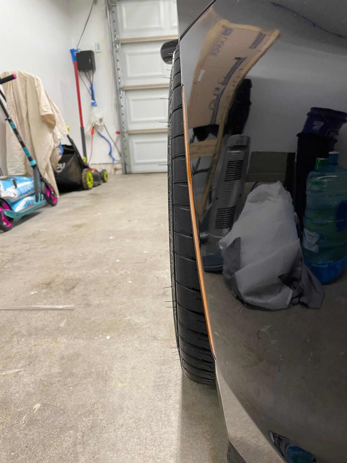

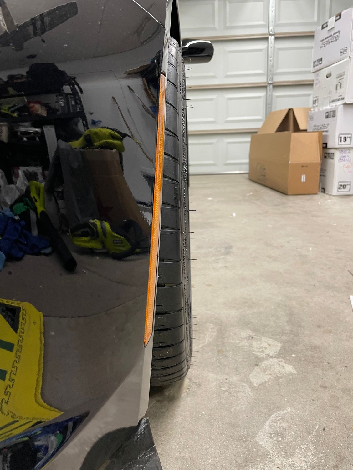

Good evening,
I had some aftermarket wheels installed from a trusted manufacture.
i called them to make sure I would have the correct fit but when I had them installed they stick out just a tad. I was going to get some fender flares to counter this but I am now wondering of this will be an issue if I bottom put the car (obviously wouldnt do this on purpose but maybe if I hit a huge pothole or something).
i called the company to discuss and was told that this particular model just sticks out a but due to the offset and it is normal.
should I be concerned with hurting destroying the body of my car? The rear particularly concerns me as there is a lip under the fender well.
the fronts are 9 inches wide and the rears are 11 inches. My car is a 2019 stingray.
thank you

As long as you're at stock ride height I don't think you're going to destroy anything. Your wheels are 1/2" bigger in the front and a full inch bigger in the rear than factory size.

Just get some XL rock guards from EOS or ACS to protect the paint areas behind the wheels.

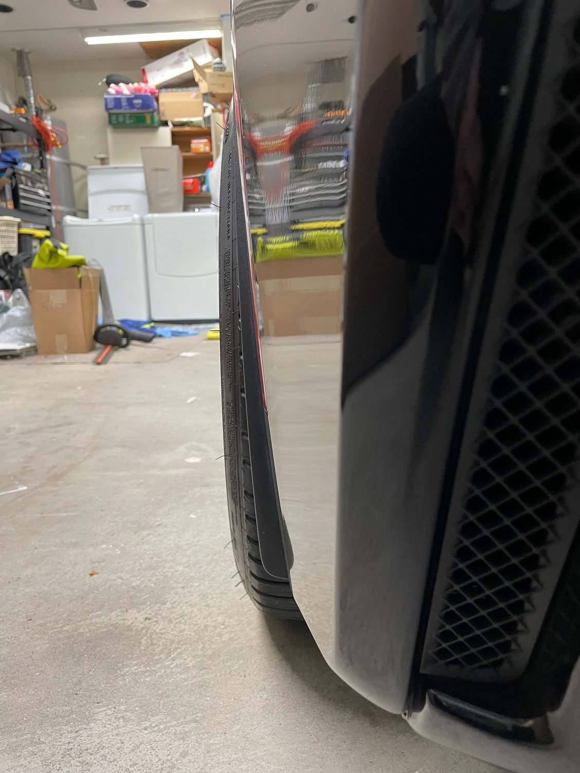

Here is a closer image of my concern with the lip under the wheel well

But looking at my notes, the "correct" offsets (both as specified by Apex wheels, and by me) is ET57 or ET58 for the fronts, and ET78 for the rears. This is for the narrowbody cars (Stingray and Z51).
I looked at my fronts and it looks to me like your wheels have insufficient offset, i.e. they stick too far out.

No the entire rear of the car is not one solid piece. If you damage a rear fender, you'll be able to replace just that fender. A majority of the body panels are made up of what is called sheet molded composite. Not necessarily fiberglass, it's a hybrid almost plastic like material.
I don't specifically know anyone running your size setup but I'm sure you can find threads on here to hopefully answer your question.

i am running a 19x9.5 +56 with a 255/35 tire on the front.. very minimal rubbing, not enough for me to do anything about, and a 20x11 +76 with a 295/30 tire on rear

Those tires are too narrow for your wheels. They are stretched which is not a safe situation. A 285/30-20 is designed to work on wheels 9.5 to 10.5 inches wide. Most tire shops will not mount tires to wheels outside the proper size.

I disagree entirely. We run 285 and 295 on an 11" width.

nothing unsafe about that fitment. A little stretch is no big deal. Racers do this all day long. If the tire goes to zero air pressure it might deteriorate faster due to sidewall angle but at that point you should be replacing the tire anyway

You got burned by the flow formed wheels for a narrow body C7. Most wheel manufacturers out there making flow formed wheels do not have the right offset for the 11" rear wheels so they stick out.
I went down the same road when I bought my Forgestars and now they are off the car and I am running stock Z51 wheels and saving up for forged.
You need at least 76mm of offset for a 20x11 but really need more if you want to run any tire bigger than the stock 285/30-20. Otherwise, they will rub even at stock height.
The only brand I've found that does a decent offset is HRE with their flow formed set. But at $3k you are in forged wheel territory so why bother with an inferior wheel type.
