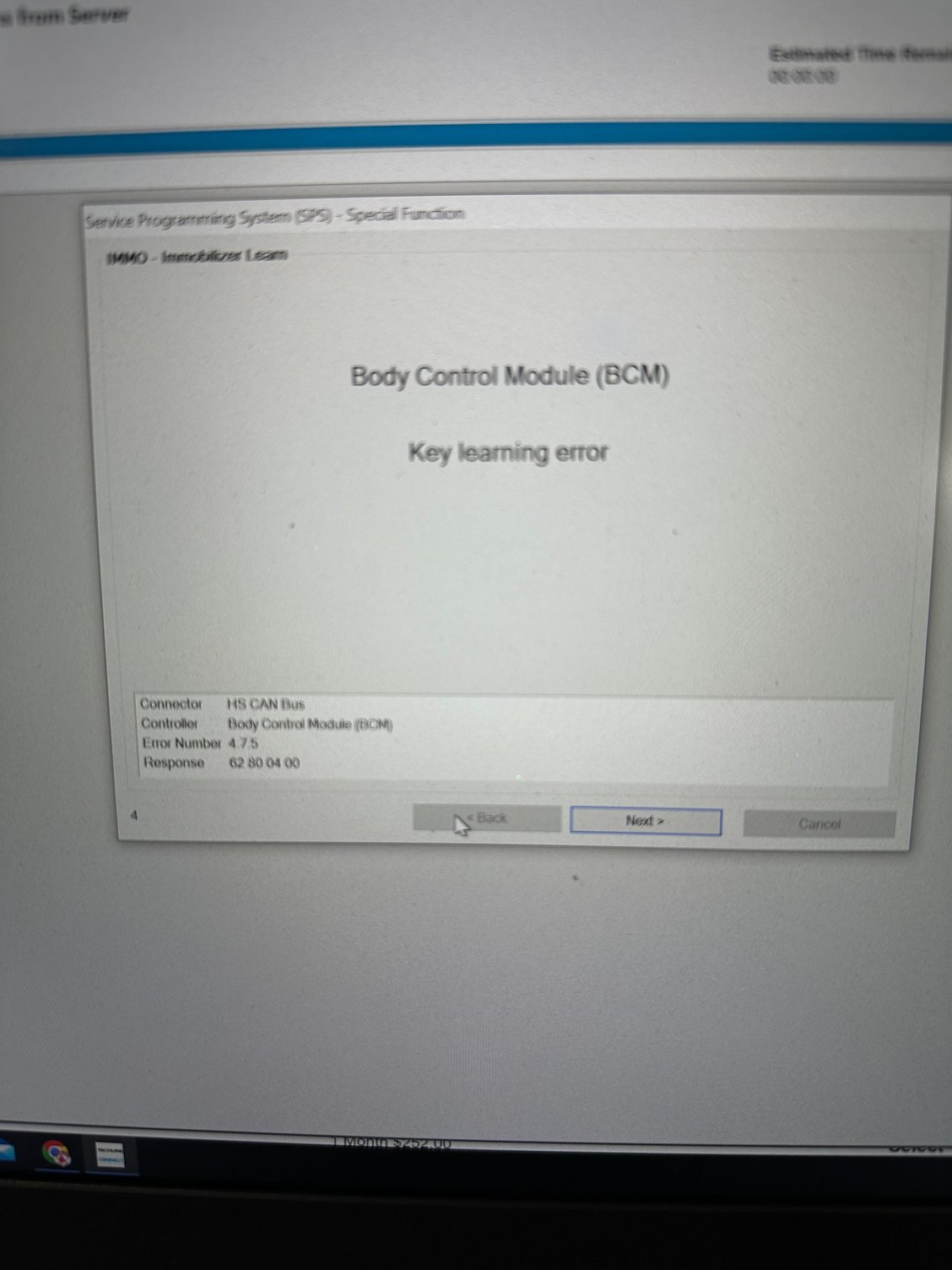

now tonight when trying to do the IMMO procedure I get the following error witch I’ve never gotten and before this the car would start and run

Ok so the first error message means you have the latest firmware installed on the module ,
Can you supply details on what you are trying to do ?
Question one , is the module new or are you trying to program one that came out of another car ?
Are you programing on the bench or in the car
What were you doing when you got the the last message . If the car started why were you programing it again ?
