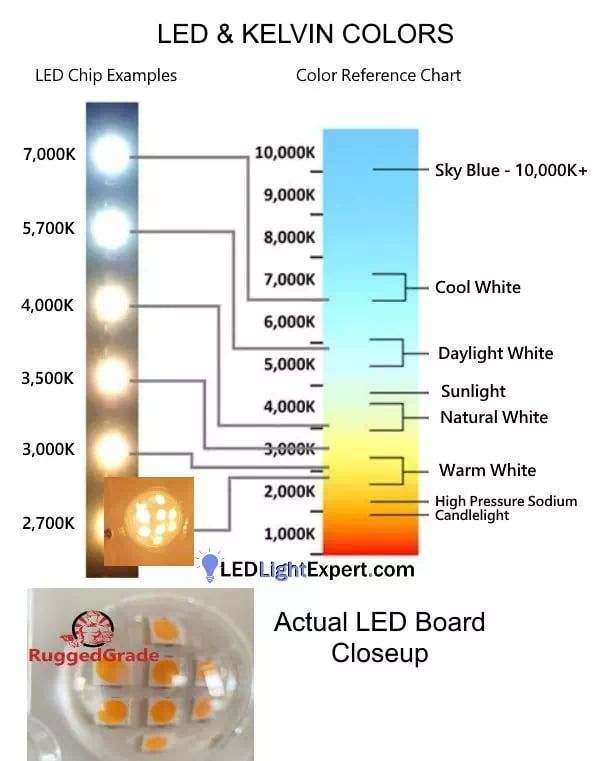

I don't follow. Isn't daylight about 6000-6500? That's what I was going for.

The human eye is most sensitive to yellowish-green light.

But is that a good thing to be dumping at night? How would it work when the light reflects off certain colors? This is why I thought white would be best since it simulates daylight and keeps things on an even keel.
