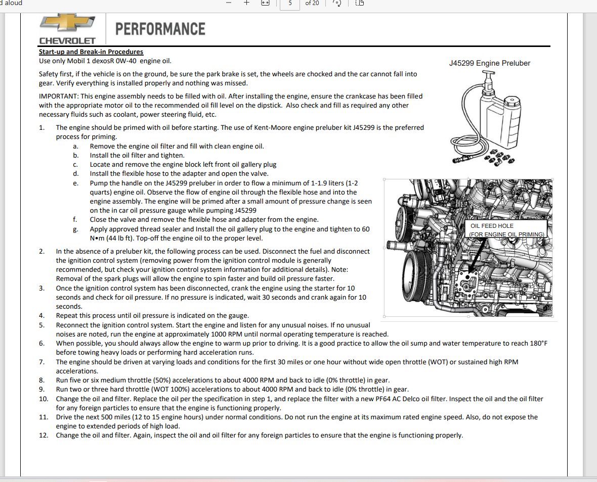

Just turning the engine over isn't much different than just starting it. You need to prime the engine without turning it. Otherwise you stand a chance of messing things up.
You need the proper prelubing tool J 45299: https://gmtoolsandequipment.com/en-U...px?SKU=J-45299 . There are other providers that have lower prices and there may be alternative tools that work just as well.
Bill

I am not sure if the dry sump engine has this exposed but if it does this is where you can prime it.
To Engine Priming
