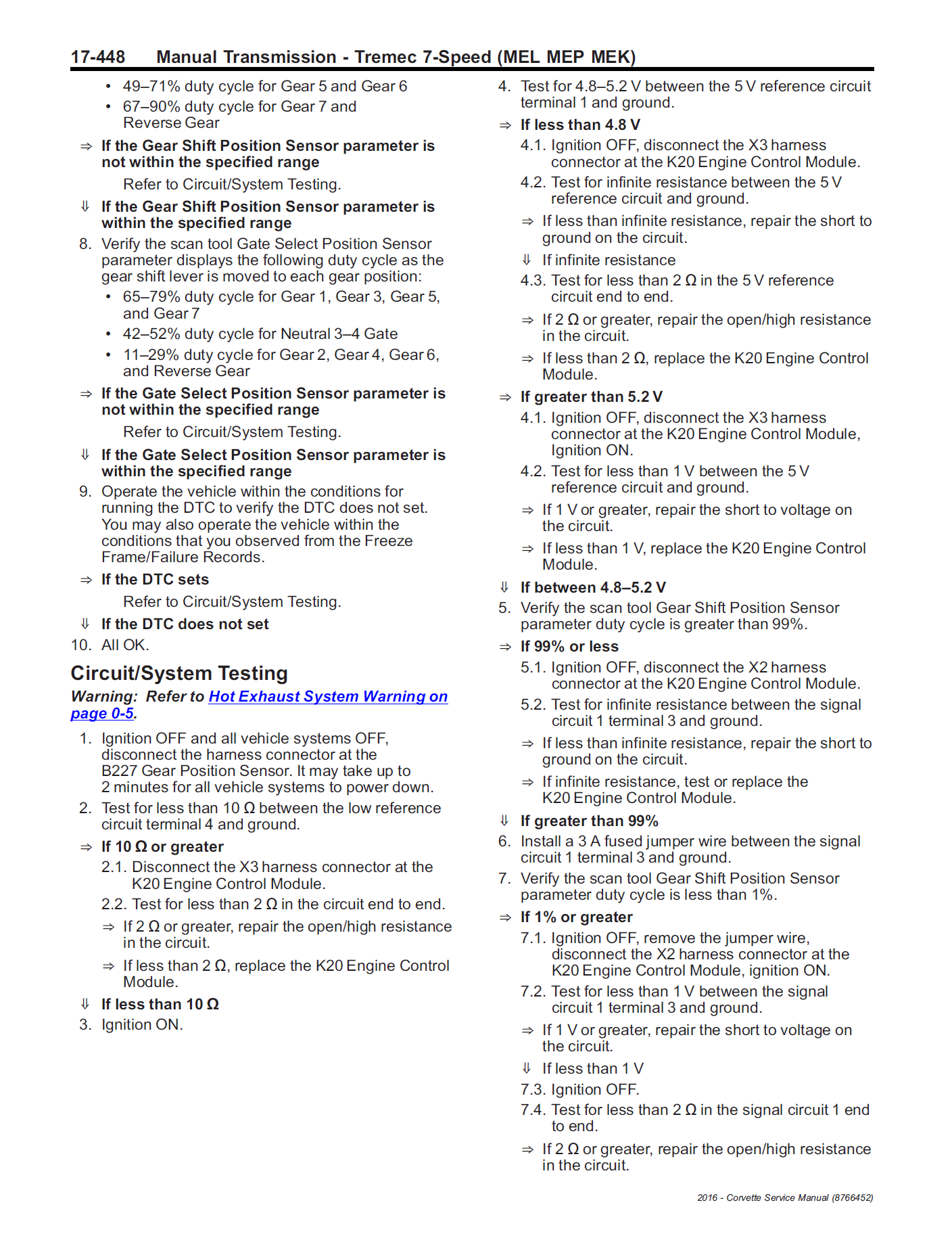

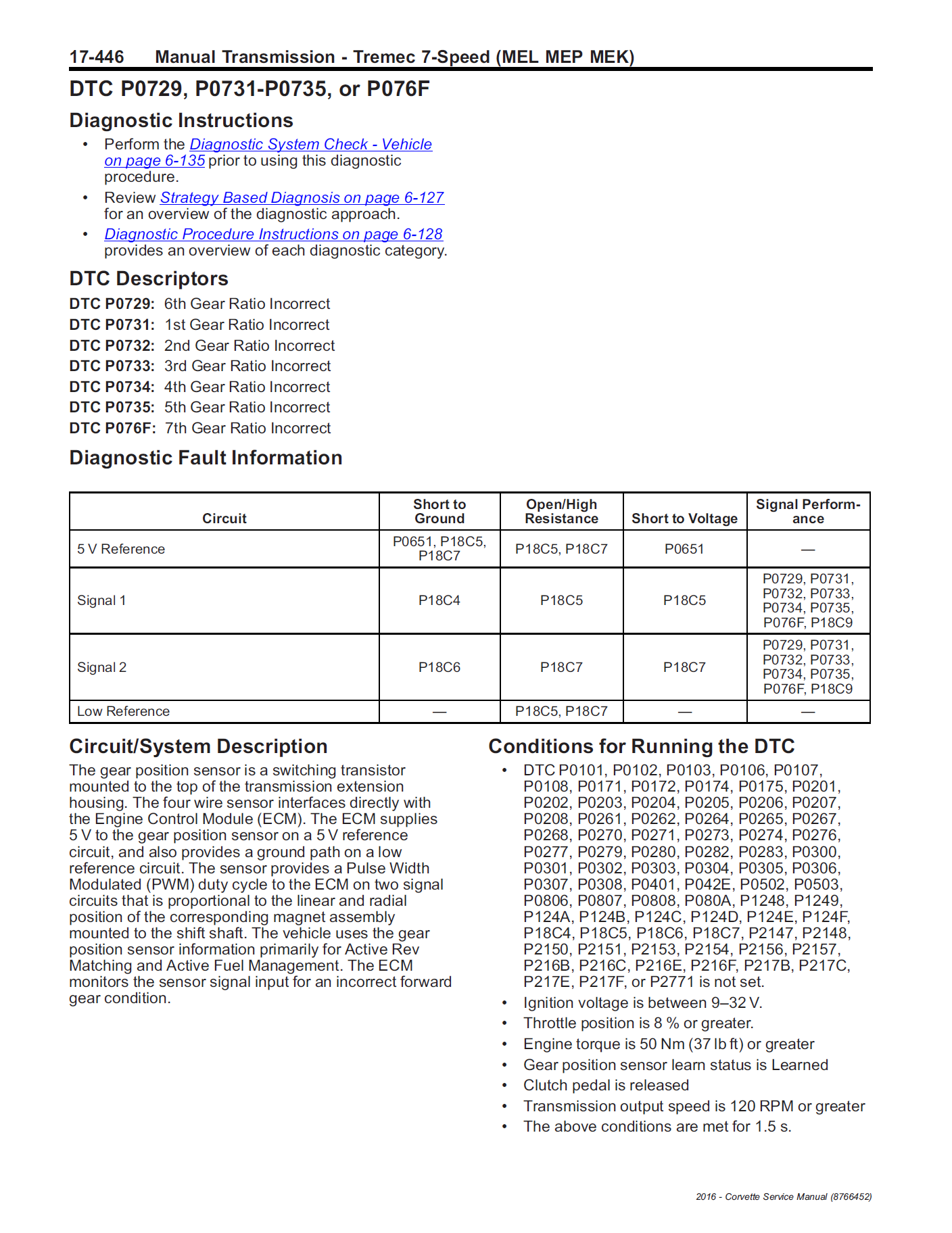

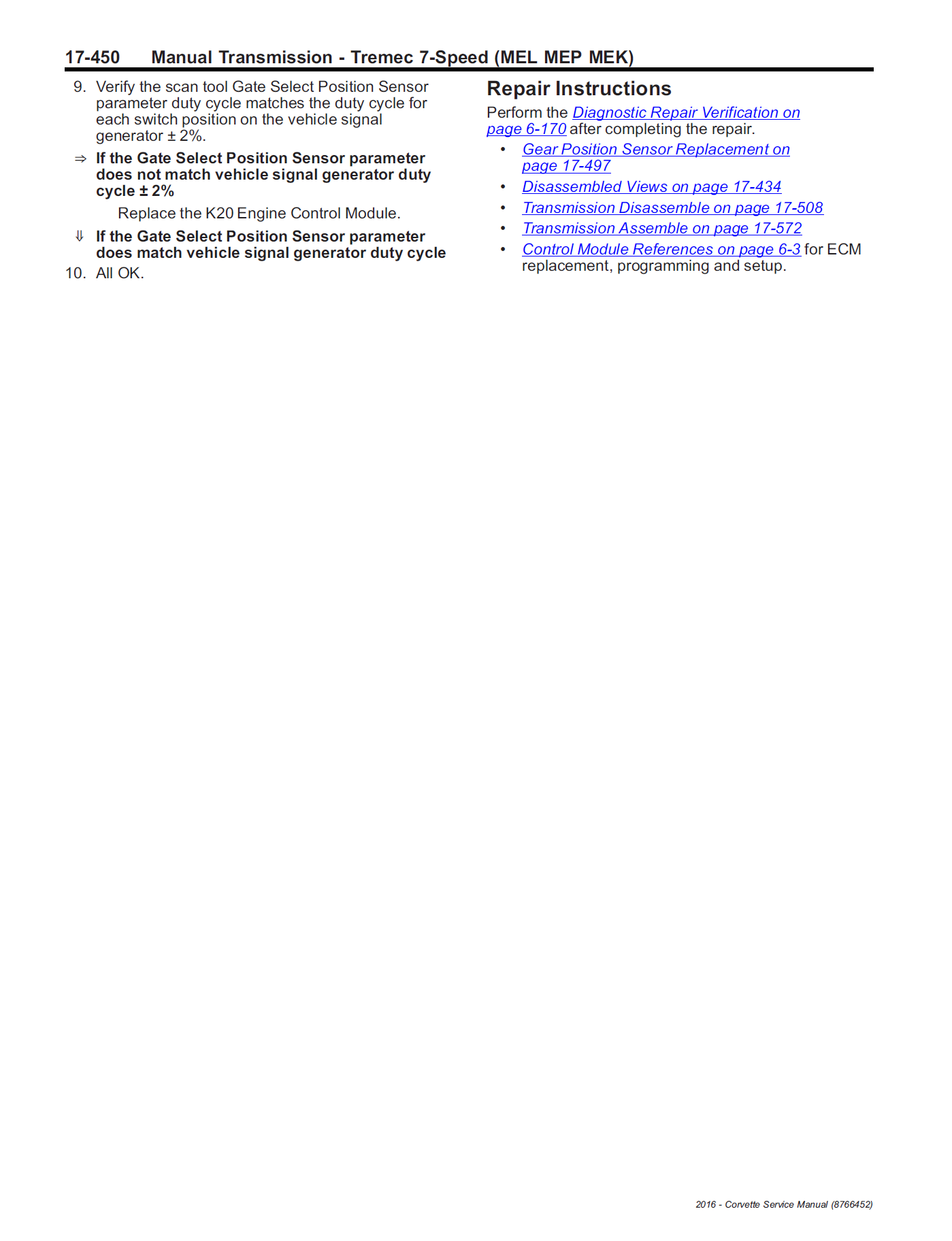

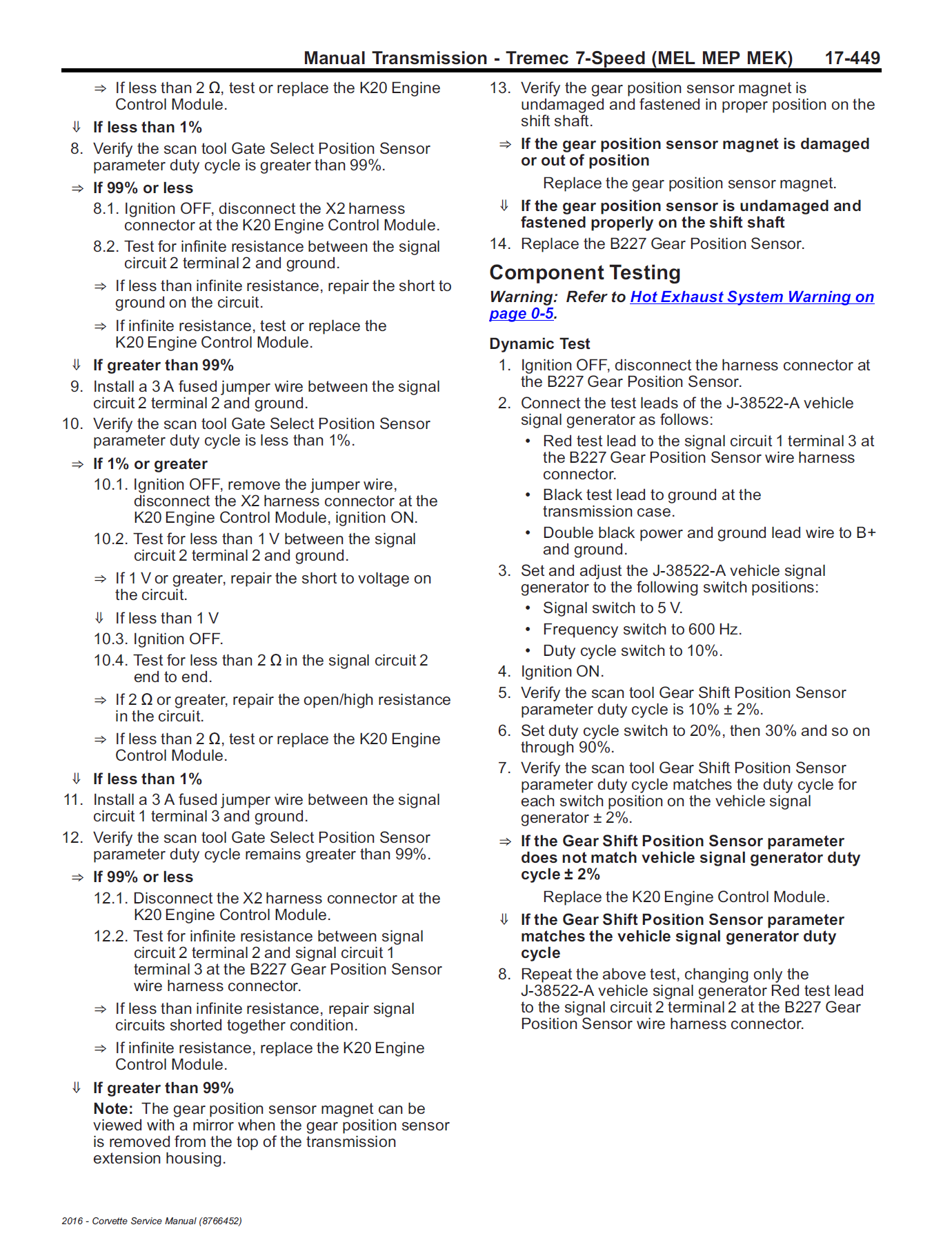

Here is the FSM diagnostic procedure for this code and several others: You may need a more powerful scanner if all you have is an OBD2 scanner.

The Dealer was trying to get you to replace the clutch with this trouble code ???...this is either a wiring issue, bad ECM (doubtful) or bad gear sensor...hopefully your trans shop is good at electrical diagnostics because this can turn out to be a BIG bill if incorrectly diagnosed...if a bad gear sensor I'm not sure if they will be able to drop the trans far enough to get to the sensor because of where it resides...if not it's gotta be removed...also if you read the circuit testing checking powers and grounds using an ohm meter is NOT the correct way to check powers and especially grounds...don't know why these genius Engineers at GM want it done this way.
