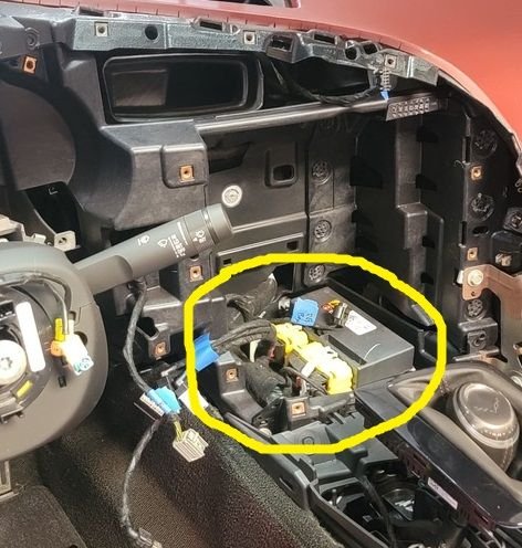

Oh God, thank you for ALL the photos!
I'm after the SRS sensor / diagnostic box.
I'm seeing now that the Info screen and AC panel has to come out.
All the photos shows this stuff gone.
Do the AC ***** pull out, like days-gone-by?
My hands are small, but not THAT small!

[QUOTE=MSGT-R;1607212595]Oh God, thank you for ALL the photos!
No need to remove any *****, the entire trim surrounding the cluster that houses the HVAC/radio controls comes out in 1 piece, one big connector from the center screen to control both functions. There will be separate connectors each for start switch, hazard switch and also for HUD/dimmer/mirror/top controls on left side of trim.

Puzzling without a book, and all the procedures show the surround already removed.
That head-space will be just what I need to get at that back bolt holding the SRS control box down!

Forgot to post the final install. Had one issue with the steering sensor where it was out of alignment (there is a window that requires matching the yellow marker with the window when at the zero position. That was the only issue.
