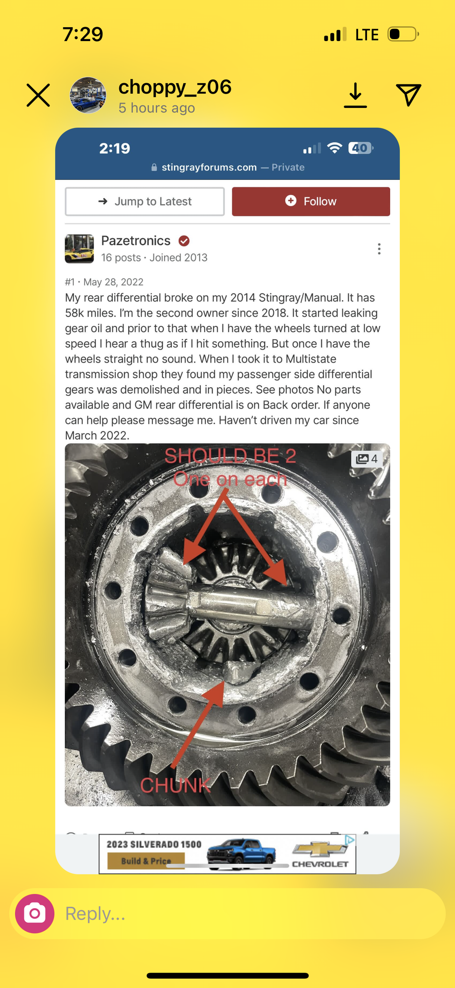

Update, took it in and they’re saying the diff is toast. Metal shavings in the diff oil. I figured it was diff or trans but I’m just waiting for a call back. I also found this post with this guys m7 and he explained literally EXACTLY what my car was doing.
