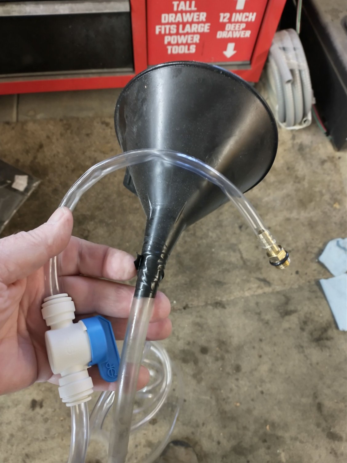

I got the kit.... ACDelco fluid 10-9394 Dexron VI, filter and gasket. I made my own fill hose, on/off valve, setup. Going to try the gravity method.
If anyone needs the brass fitting with the M12 x 1.75,,,,,,,, I have extra ones.

Well that was fun. The funnel idea was a bust. I think I used to small a hose. I started gravity filling the trans but it was taking way to long so hooked up the hand pump, and even that took a while.
The rear 3 bolts were very hard to get to, I guess I have small hands so I finely got them. The corner one is the most difficult, impossible to get a torque wrench on that one. I used a small 10 mm open/closed end wrench, you can get just a tiny turn on the bolt switching back and fourth between the ends.
I had to modify a 1/4" 10 mm socket to torque the other two. I cut the socket down and made it shorter then used a 1/4" swivel extension. Picture. A stubby 10 mm swivel socket might have worked.
