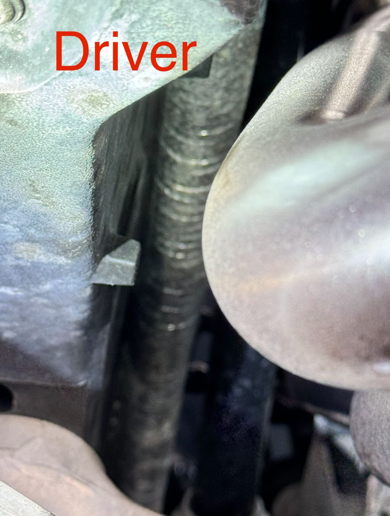

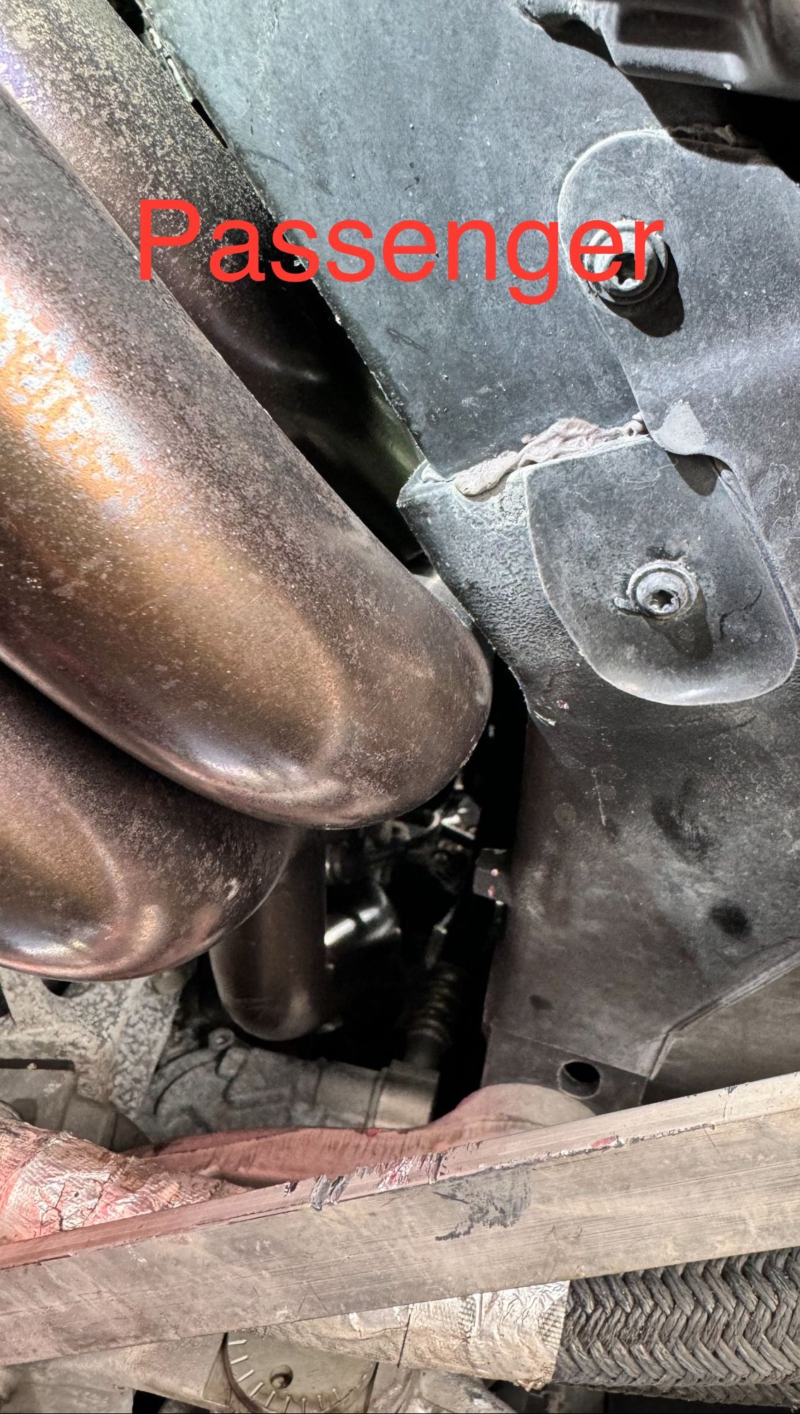

I posed this in general bu not sure how to delete it.. Anyway, ​​​​​​got a set of EOS headers installed this past weekend and on the passenger side they are completely on the frame/bracket shown in the pic. However, there is enough space on the driver's side to fit an open hand. Got the headers from a recommendation and then did some research and saw a few installs go well online. But, this is driving me crazy because it's causing a lot of vibration from 500-1.5k on acceleration. I've been looking this up and see that it is a common problem for the passenger side with all brands and makes of headers but no real solutions. Does anyone have any solutions besides returning them and going with a different brand?

Have you tried loosening your engine mount bolts and shifting it as far to the driver-side as possible? I would loosen the upper 18 mm nuts as well as the lower bolts in the sub frame.

Not yet. I had a local shop do the installation because I've been traveling a lot for work but will have some time in the coming weeks. Would this cause any other issues by moving the engine over if possible?

They are 1.875 X 3.0 INCHES

My person opinion I would send them back and go back with a brand that doesn't have fitment issues. ARH, KOOKS, Stainless Works

I know some depending on brand/clearance issues have just dented the header to create the clearance needed.

Yea but kinda sucks to do on a new product

You should call the manufacturer and ask them about it. I am sure they have sold a lot of these at that price.

There are tolerances for everything; if it was my car I would just take a large prybar and gently create an 1/8" to a 1/4" clearance where needed.

Dent them. Doesn't affect hp.
