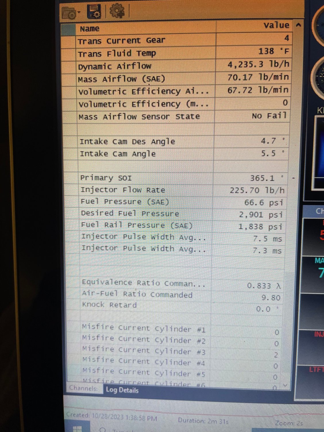

when getting into the higher rpm’s the fuel pressure dropped to around 1100psi in the rail, and it started missing. This was happening even on E45 mix. I have have plans to start making more power- but need to get this sorted out before I get to work! I am assuming it’s the low side pump, but is there a higher performing setup? Or should I go DSX auxiliary? What has worked for you guys?

I knew I would have issues with a pulley involved, but am not happy about it happening from the jump on a basically stock car. I guess I would like to get it squared away of figured out before I dump money into parts. So I pulled a log from the track, and when it started missing the rail pressure had dropped to 1800 with a demand of 2900psi. Here is a snapshot of that occurring, but it last until throttle was pulled.

I'm glad you mentioned this- thank you. My tuner was telling me it was a bad HPFP. So I reviewed the logs myself and found the injector pulse width to be 7.3-7.5ms when this drop in pressure was occurring. I compared that to my original logs prior to the tuning adjustments (when there was plenty of fuel pressure), and the pulse widths were around 6ms. I’m thinking the rail was being trained with the time length the injectors were open.

You should be able to get a little more out of it than that, especially stock. You want the low side to maintain 70-80PSI to get the best performance out of the high side. But in your log screenshot, the low side didn't tank, the high side did. I suspect the car is tuned way too rich for E and you're just wasting fuel.
Do you have a wideband in the car?
