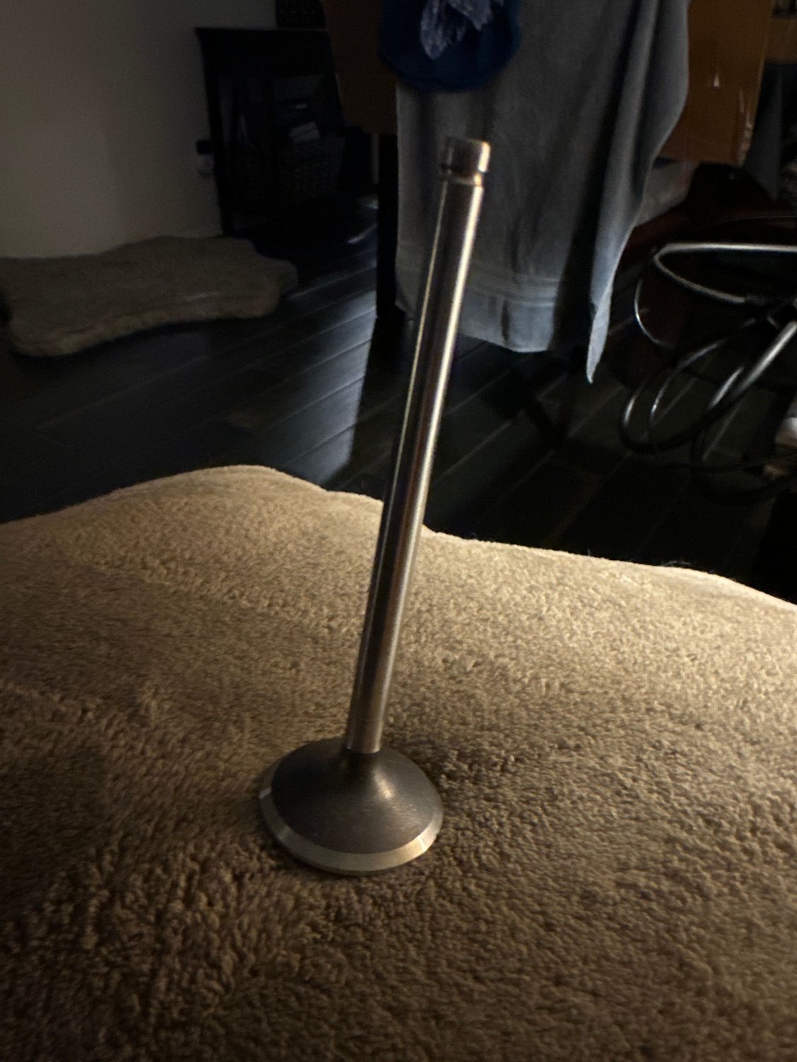

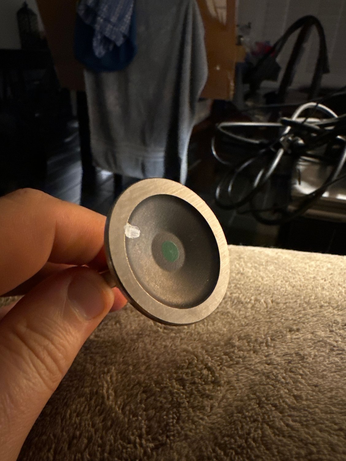

Originally Posted by Katech_Mike
The part number changed which means there was either a revision or the supplier changed. We have not seen any stock of the updated part number yet.
The part number that now represents the l8t inconel valves is 12733470
And they are readily available now. I have to weigh them.
Did you get a chance to weigh them yet?

OEM LT1/LT4 - 74g
OEM L8T Inconel (Old PN:12671857) - 96g
OEM L8T Inconel (New PN:12733470) - 95g
Ferrea Super Alloy - 95g
