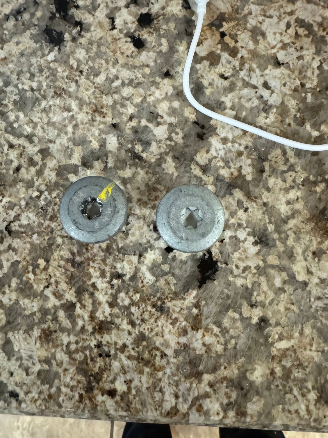

so I have everything needed to replace the clock spring. only issue is the dang t50 Torx bolt holding the steering wheel on!!! so far 150 psi on a 1/2" drive impact didnt budge it so I went old school 1/2 " breaker bar and broke the t50 in half! guess ill be buying a bunch of these junk Torx bits HATE THEM!!

I read all of the posts lol. was hoping the impact would break it loose then I would back it out on a ratchet. no luck. strapped the wheel to the grab handle so it wont move and used the breaker bar. of course with so little of the Torx bit doing the actual work it snapped off. cant stand these Torx bits junk hardware. for now walked away, sick as a dog with a late winter flu and need to find some more t50 bits sat and try again

I hope someone trying this repair reads this before trying it. THIS IS THE SOCKET YOU ARE GOING TO NEED!!!
Amazon Amazon
this Torx and a short extension and a 1/2" breaker bar was what I needed to get the bolt out. my 1/2" drive impact set at 150 psi would not break it loose! slow hard hand pressure was needed to break the nut and turn it out to the very end. even my 1/2" drive ratchet wouldn't turn it Ince I broke it loose. had to use the breaker bar at a 1/2 turn each time too get this bolt out without messing it up. already had a new bolt to go back in I suggest you get one as well. this bugger wore my arms out I had the stern g wheel strapped to the passenger grab handle to keep it from moving and still had to jam my knees into the wheel as well.
SUCCESS!! now to let my arms rest and finish this job lol.
all finished no lights and repair done with all gm parts. so in review the new bolt going in is just about as tough as the old bolt coming out so be prepared to use the breaker bar to install. gm dealer wanted 1 hr diagnoses and 3 hrs install time 400$ plus. took me less than 1 hr all in having never done it before. thats to Bill Dearborn and flattman and the others in. this forum for all the help. you can use your steering angle sensor and you wont have to recalibrate it. pops right onto the new clock spring
