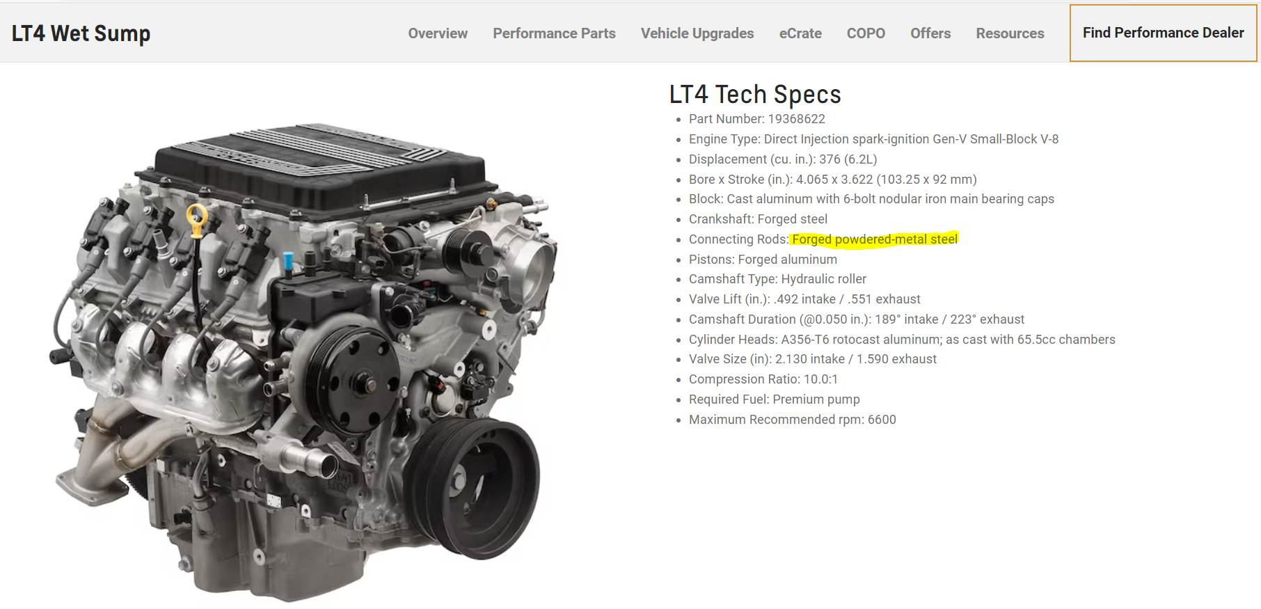

1 and done on this motor hence the question. 750-800 whp is all im looking for. already had 1000 whp cars for me the sweet spot is 750-800. runs fast no issues. so cam and internals related and im done as long as the bearings are ok with the mileage . seeing these powder rods doesnt leave me with a warm fuzzy though rather see Ti or Carrillo rods was figuring the oil pan is already off popping the rods and crank out is no big deal . wasnt sure how long the bearings are good for with the added power over stock
