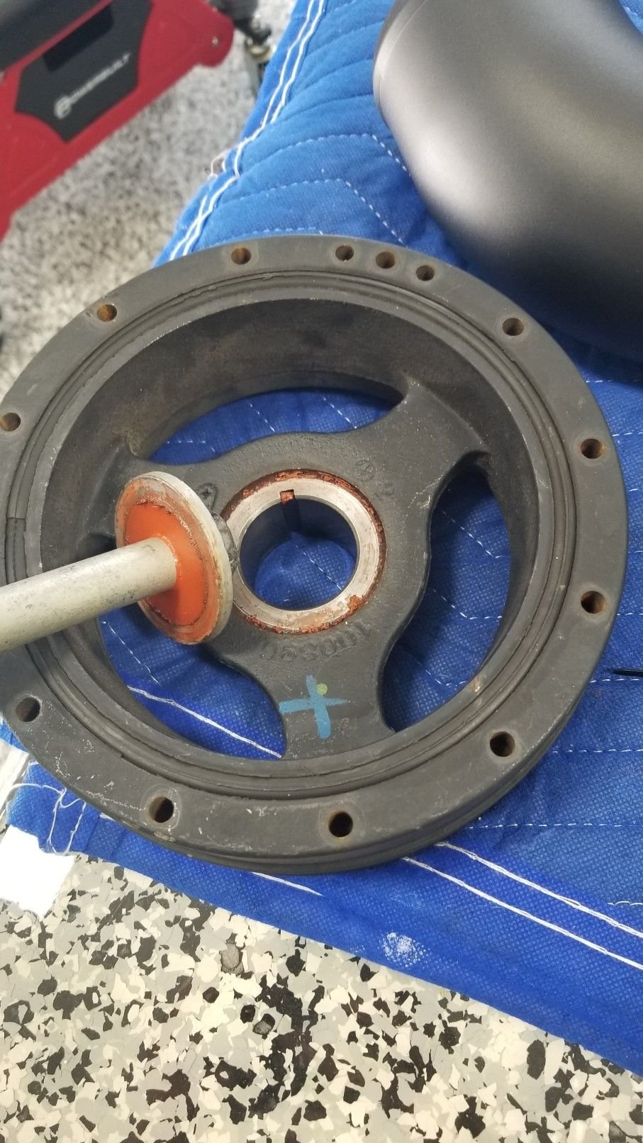

You sure your C7 was not keyed ?
see the A&A instructions below ....

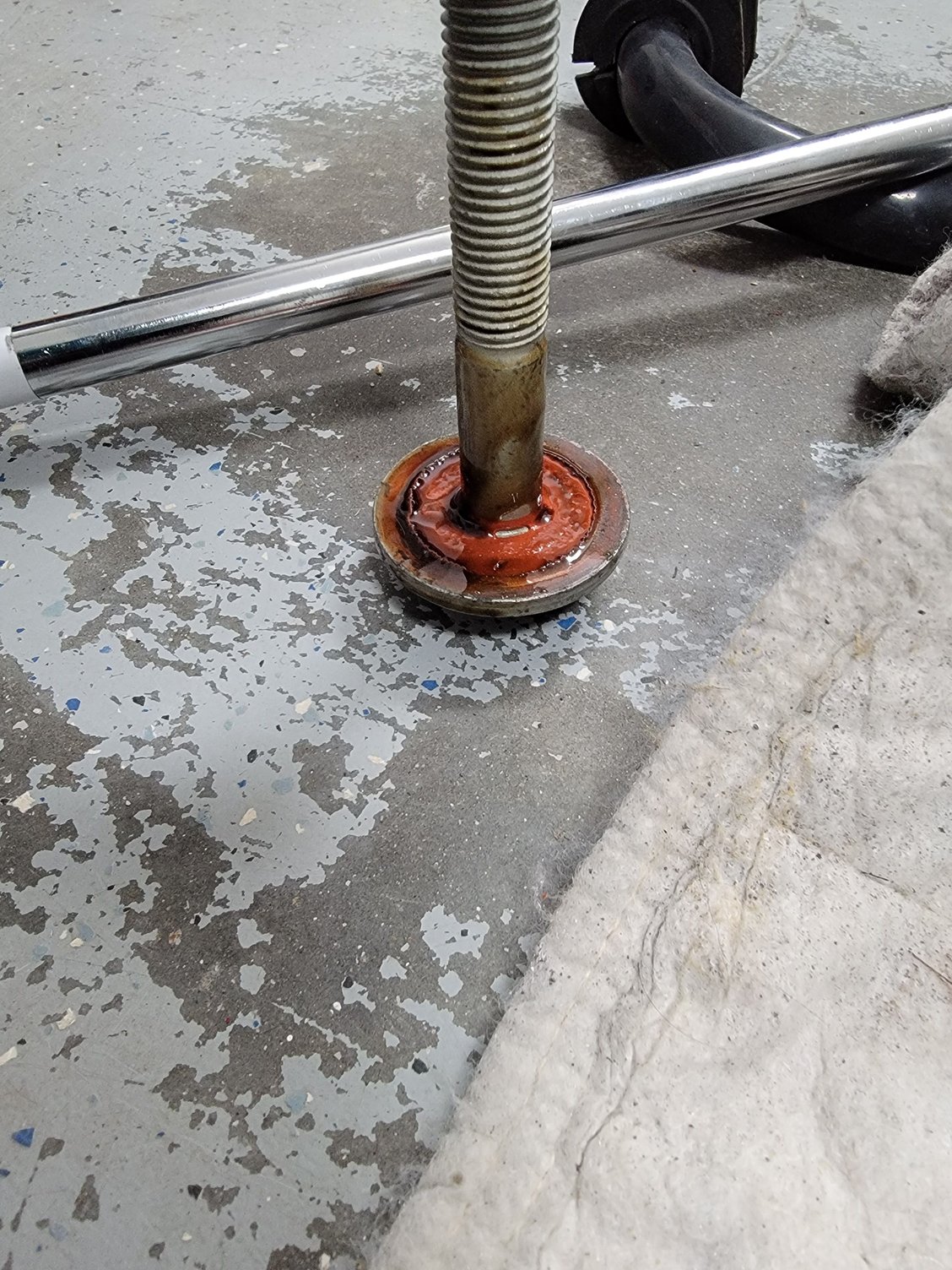

For me... didn't do anything to keep the engine from turning. Employed a Milwaukee 2767-20 ½” High Torque Impact Wrench after applying some heat... and my 2017 GS with automatic was definitely keyed. And I'm very glad the specification for the bolt and Innovator's West balancer I installed was only 130 lbs.

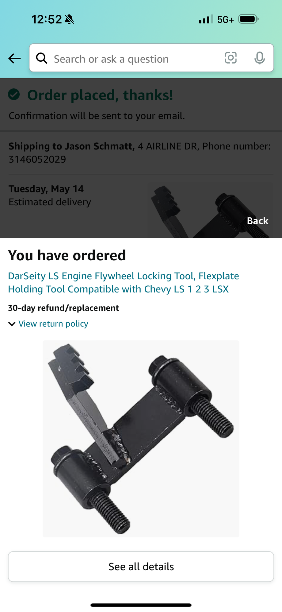

Found a flywheel tool, all good. I remember how to do it now. Lol Been years.
I have no idea why mine was so hard to get off .... , i had so much heat on it and it just would not budge .....

From: Western Arizona
Sorry! I was talking about my C6 not the C7! You are correct about the keyway.
Thanks for the Pics. I hope never to get into my new car!
I have to say, until I put heat on it I was very worried. The heat was magical... didn't take much either. I swear they painted that bolt with lock tight.
I can't imagine the pucker factor you experienced.
