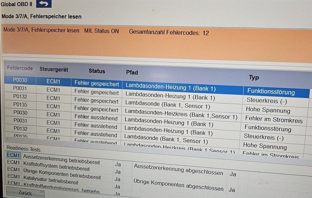

At the end of 2022, the check engine light (MKL/CEL) came on during a track day, diagnosis: O2 sensor bank 1, sensor 1 only delivered a voltage value that didn't change (I'm no longer sure whether the MKL/CEL was permanently lit or flashing).
After repairs and no problems in 2023 with approx. 1000 kilometers of race track, the MKL/CEL (steady light) came back the day before yesterday during a track day, diagnosis: O2 sensor bank 1, sensor 1 only delivered a voltage value that did not change.
(By the way: I was still able to drive with the MKL/CEL permanently lit without noticing any problems (I hadn't even noticed it at first); I stopped driving when further errors were reported ("service the rear axle") and the engine no longer worked properly and the MKL/CEL started flashing.)
In terms of laptop diagnostics, apparently identical to the end of 2022;
see also the attached image with the following error codes:
P0030,
P0031,
P0132,
P0135.

A flashing MIL along with “Service Rear Axle” is a cat damaging misfire…3 of your 4 DTC’s are O2 Sensor heater circuit malfunctions…are you seeing 450 millivolts (Bias Voltsge) on your scan tool ??…the heater circuit uses 12 volt power and a PWM (Pulse Width Modulated) ground supplied by the ECM…not knowing your electrical skills I’ll stop here…could be wiring or a bad sensor….the P0132 is a B1S1 “high” voltage not associated with the heating circuit.
That's all I have from the workshop's scan tool.
Not really much electrical skills on my side ...I have an iCarsoft FD V1.0, but no experience with it and no knowledge what to look for.
