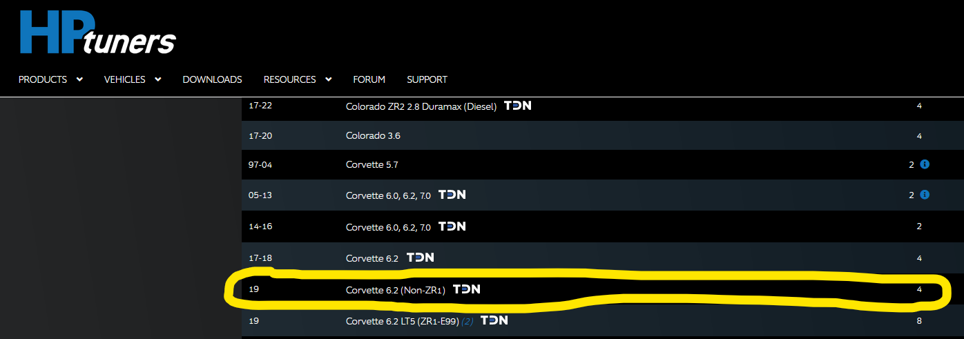

After the post by TJay74, I had to go back and look.
4 credits for the PCM
3 credits for the rest
From my license..... (Btw, "E92A" is the PCM type)
For the PCM off the HP Tuners website
